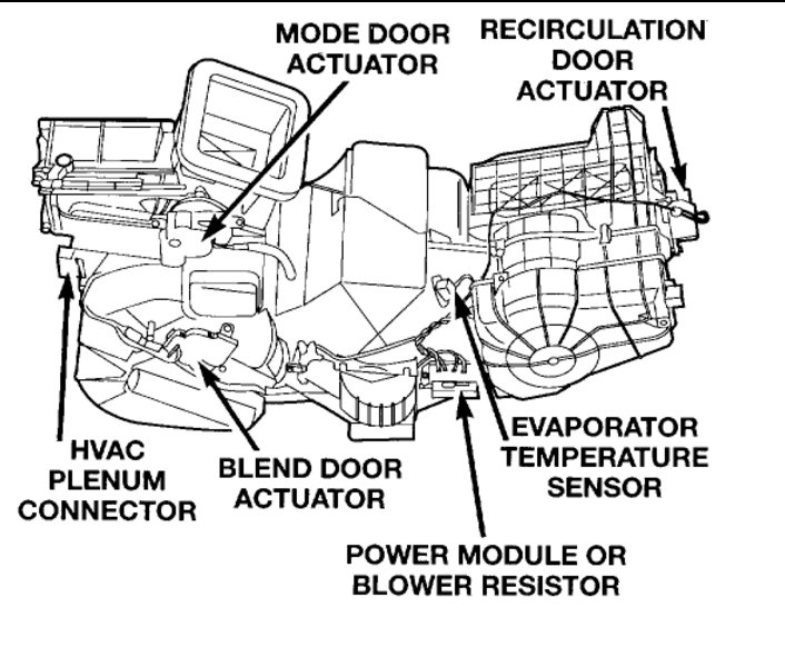

It sound like you have a blend door actuator that is bad. Here is a guide and a diagram to give you an idea on what to look for and fix the problem.
Please let us know happens so it will help others.
Best, Ken
