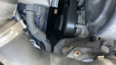

In this video you can really hear it and you can see the tensioner moving. I replaced the belt 15,000 miles ago and the tensioner was replaced a few months ago. Both are Ac Delco parts and i changed the tensioner because i figured it wasn't strong enough to hold tension under the load of the compressor when it was engaged but the new tensioner didn't solve the issue. I'm not sure if the Ac Delco design isn't good enough? These 1.8 tensioners are different than the 1.4 turbo tensioners.

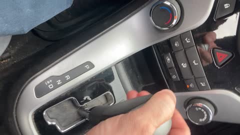

In this video you can hear it happen in reverse or drive but not in park or neutral.
Jul 12, 2023 at 11:39 AM
It sounds like the belt. Try this. When it is making the noise, pour a small amount of water on the belt and see if it stops or changes.
Jul 12, 2023 at 11:14 PM

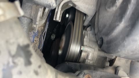

Alright i sprayed the belt with water and there was no change but i had my wife help me and with the ac on and in drive you can in this video I'm attaching the belt starts to vibrate like crazy and the chirp is the belt because it vibrates due to lack of full tension when it's under the load of the compressor. I changed the tensioner 4,000 miles ago with the ACDelco OEM tensioner. In the video when it starts chirping bad you can see the belt vibrating like its losing tension.
Jul 13, 2023 at 2:52 PM

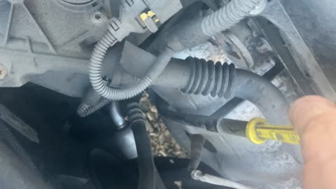

With the car running and A/C on i pull the oil dipstick out and I hear a hissing in the back of the engine and then it triggers the engine to struggle and the chirping. With the A/C off and dipstick pulled it'll do the same hiss and engine hesitation but no belt chirp. I don't know if that means anything more or just shows that's a load on the engine like a compressor creates.
Jul 13, 2023 at 5:44 PM
This keeps getting more and more interesting. Is the PCV in good condition? I'm going to ask the site owner for his input. He is excellent with A/C, and since that is where we started, I want to see what he says.
Jul 13, 2023 at 7:19 PM
BAT KID
  • 40 POSTS
I haven't checked the PCV valve so I'm not sure, but i can say i haven't had any issues other than this A/C issue and alright sounds good. thank you
Jul 13, 2023 at 7:31 PM
I suggested the PCV because when you remove the dipstick, the sound returned. It seems like that is lowering the RPMs and causing the noise. It's just a theory. When you remove the dipstick, it is allowing fresh air to enter the crankcase. With the dipstick removed, is there a strong vacuum at the dipstick tube?
Jul 13, 2023 at 9:48 PM
BAT KID
  • 40 POSTS
Makes sense and yes, i pulled the dipstick and put my finger over the hole and felt suction on my finger.
Jul 14, 2023 at 4:14 AM

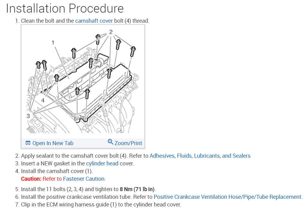

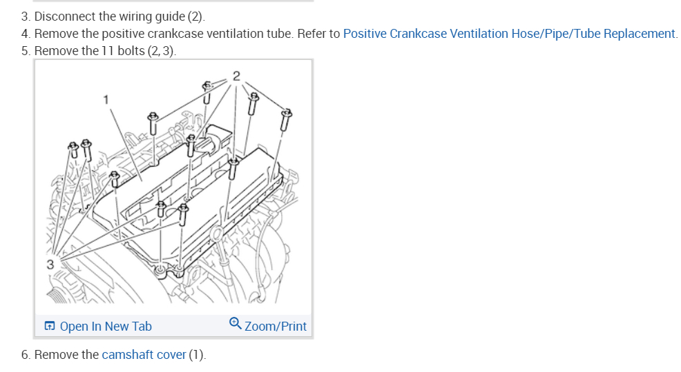

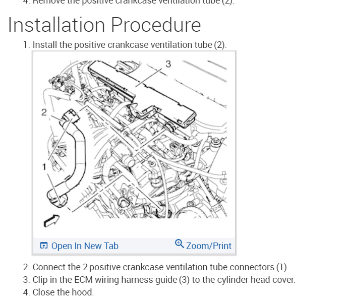

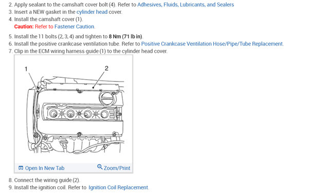

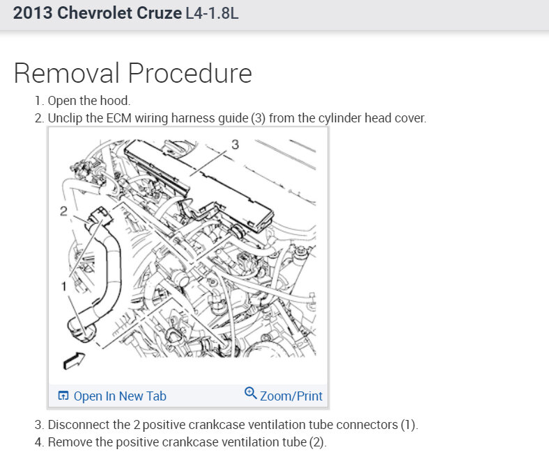

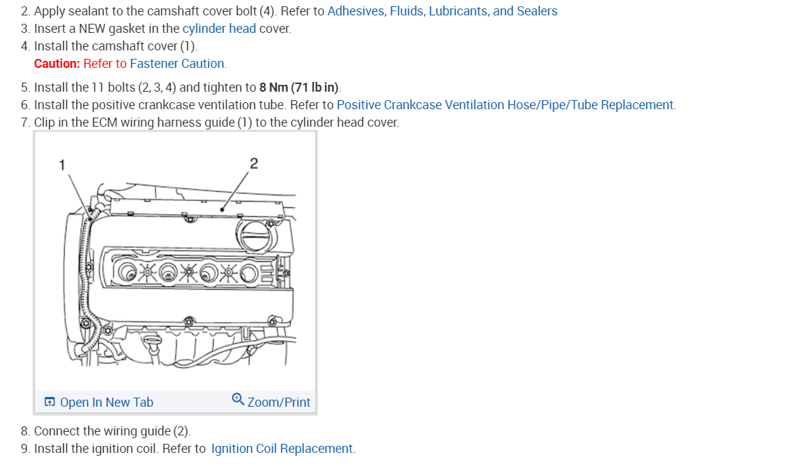

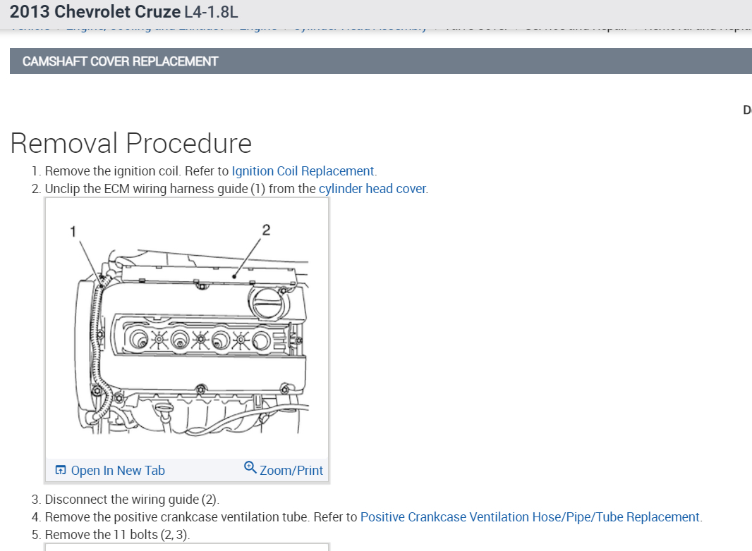

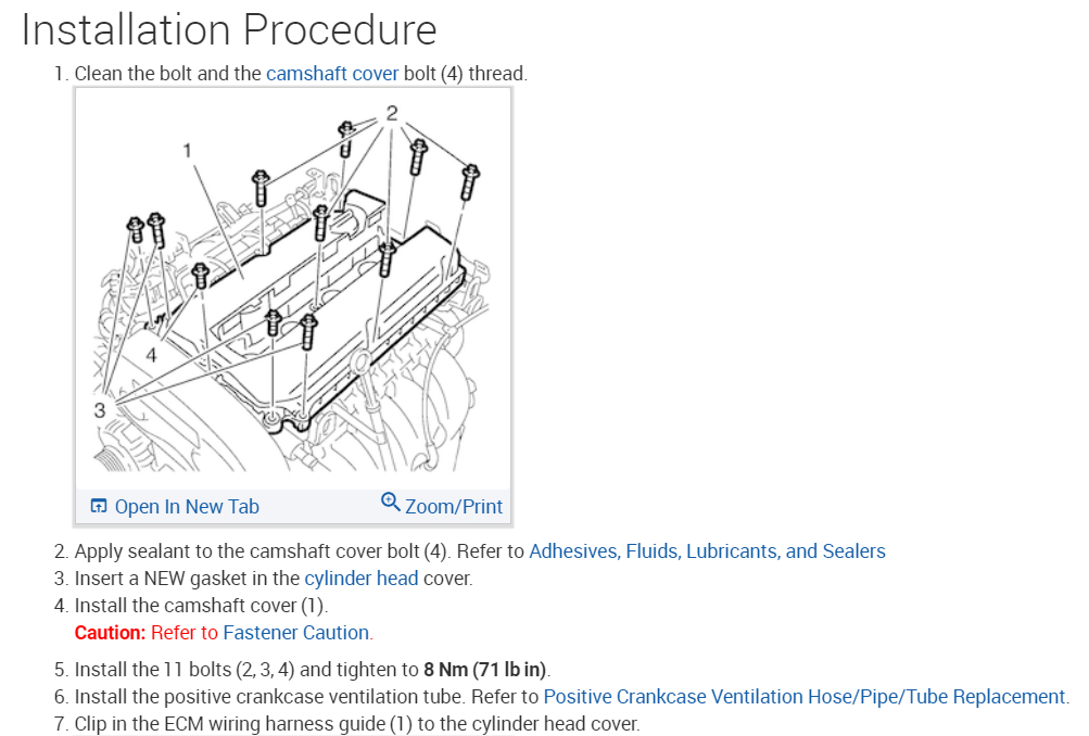

Yep, this happens when the valve cover needs to be replaced because the crankcase ventilation diaphragm has gone bad and creates an internal vacuum leak inside the engine. Here is how the job is done to fix the problem. Check out the images (below). Please let us know how it goes.
Jul 14, 2023 at 9:09 AM

Today at the shop we saw the tensioner bouncing causing the belt to shake and squeal so we took a socket and ratchet and gave the tensioner a little more tension on the belt and turned the A/C on and put it in drive and even tapped the gas. It stops when you give the tensioner more tension so i guess the new tensioner i put on it months ago is defective. and or the new belt i put on months ago before then is stretched? Both are ACDelco OEM parts so I'm kind of confused but i guess I should change them again or warranty them out or try different brands?
Jul 20, 2023 at 7:19 AM
BAT KID
  • 40 POSTS
Problem solved. i had an ACDelco 6k609 belt on it because rockauto said it works with A/C. I looked up on Chevrolet parts website and it calls for a gm55578115. Rockauto doesn't show that number as a cross reference when you select the 6k609. I bought a continental 4060610 which crossed to that 55578115….Delco 6k609 says its 61 1/2” and the 55578115 says its 61” so i guess i had the wrong belt on my car and I'm not sure why rockauto lists it as an option or why there is 2 different sizes that close in range for a with A/C option.
