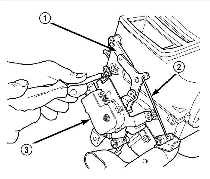

Hey, my A/C and heat work in the car but only on defrost. It seems the mode no matter what I select only comes out the defrost. Is it the blend door actuator which I think is located behind the glovebox or someone else?
Jul 30, 2025 at 8:43 PM
So there are two systems, one for the manual system which is vacuum operated, if this is the system you have I would look under the hood for the small vacuum line (plastic) headed from the vacuum reservoir to the engine and then to the firewall, please go over this guide to see what I am talking about.
https://www.2carpros.com/articles/air-vents-stay-in-the-defrost-position
If you have the "auto" system the problem will be the mode door actuator, here is the location for that, please let me know which system you have. Check out the images (below). Let us know how it goes.
