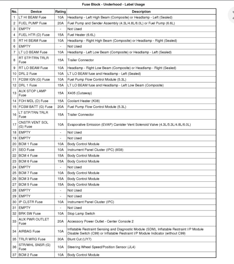

Where is the fuse panel I need to check them? The mode blend door is not working.
Aug 19, 2017 at 11:58 AM

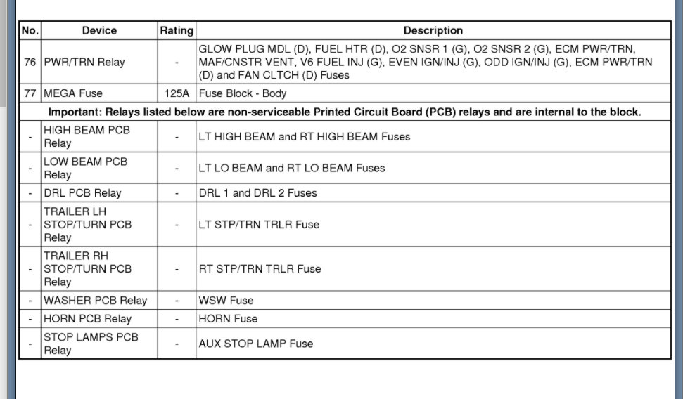

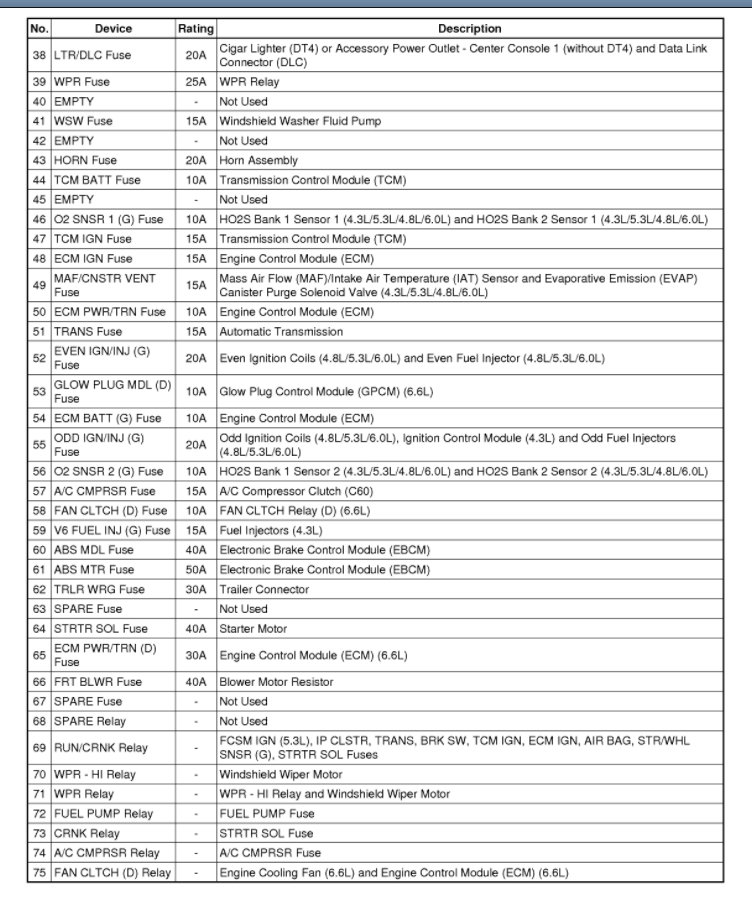

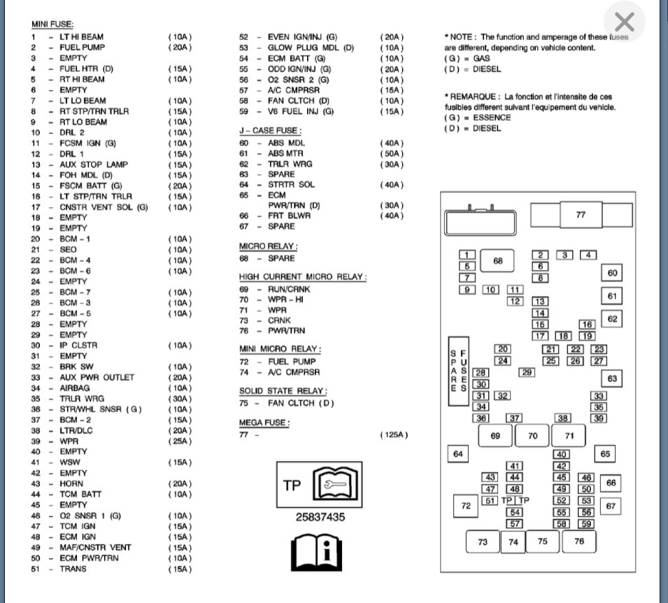

Here is a guide that will help with testing and replacing the fuses. Please run through this and let me know if you have questions.
Below is a copy of the fuse layout. Thanks for using 2CarPros.
