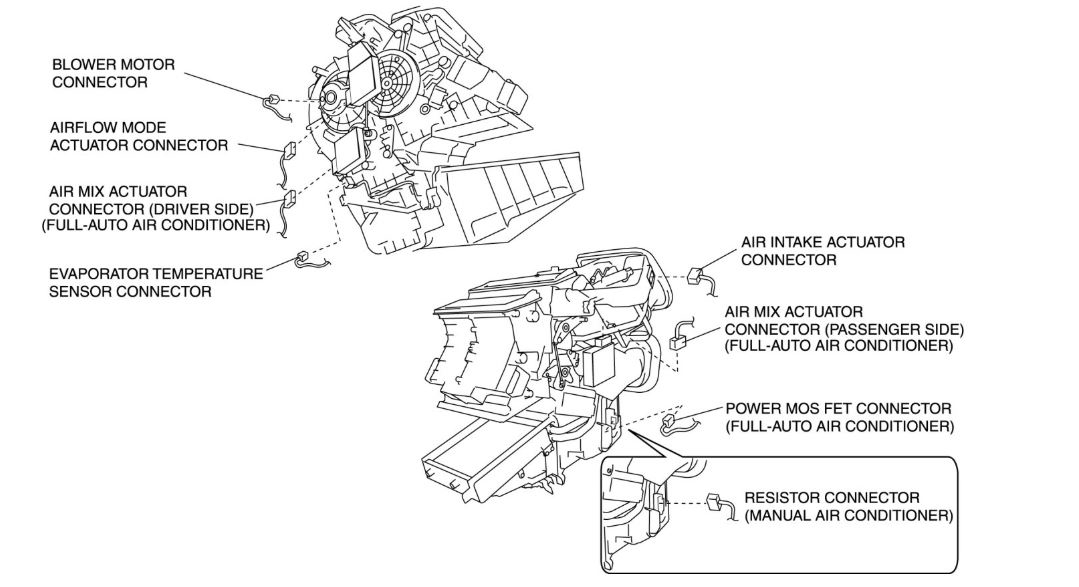

Good morning,
Yes, there is a restriction on the low side.
Did you use a new expansion valve? If you did, good chance the evaporator may be the restriction.
