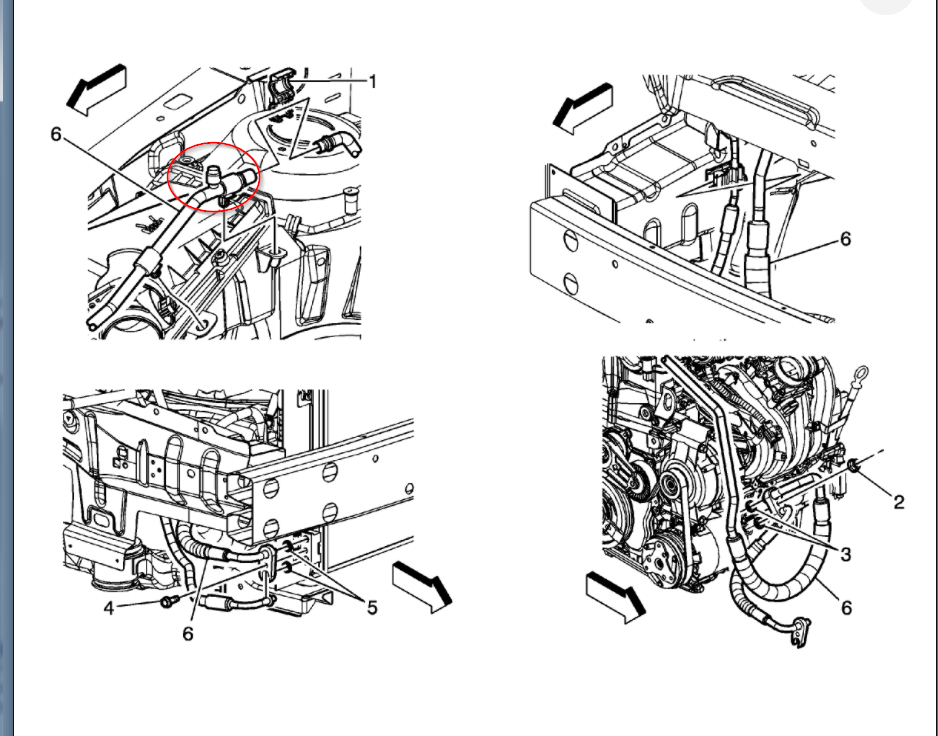

Where is the low side air conditioning port for my vehicle?
Sep 10, 2016 at 12:57 PM
It is going to be on the passenger side of the vehicle and on the line coming from the condenser.

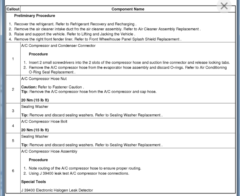

I attached the process on how to replace this which shows the location as well.
Lastly here is a guide that shows how to add freon and that is done through the low side so you will see it on this vehicle. Most are in the same general location. Let us know if you have more questions. Thanks
