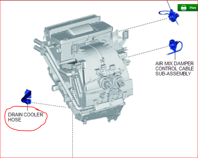

When the A/C is running when I go around curves it drips on my foot on driver side. How can I fix it? Do I blow something out? If so where? Any diagrams?

All heater/AC boxes have a drain for condensation. Sounds like yours is somehow plugged letting the condensation into the vents and onto your shoes. I have attached a picture. Most have a small rubber tube that is vented on the bottom of the firewall. I would try using a coat hanger or something to try to unplug whatever dirt/debris is blocking it up. Hope this helps and thanks for using 2CarPros.

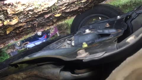

So I blew the tube piece out and nothing came out put nozzle up in little port where the hose connects to I can hear the air but no debris but it’s dripping a little now at first it was a steady stream then just very slow drips like a faucet is this normal hears where it was dripping good then slowed down or should it drip fasted and make big puddles like some cause it was flooding passagener floor it was soaking

Yes, condensation is normal depending on weather of course. Since you have blow the line out is it still soaking the Interior floor?Thanks again for using 2CarPros.

No was not kinked at all when I put it back on it had like a stream coming out for like five seconds then went down to dripping like in that video. Figured it might be some of the water that was left that was backed up so it not normal for it to drop like it was in the video should it drop slower.

It is usually a continuous slow drip. Is the floor still soaking?
