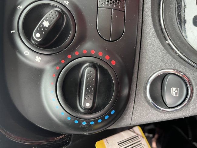

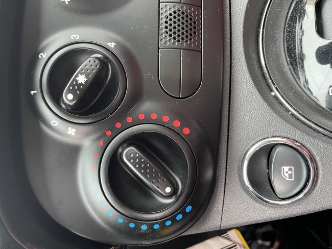

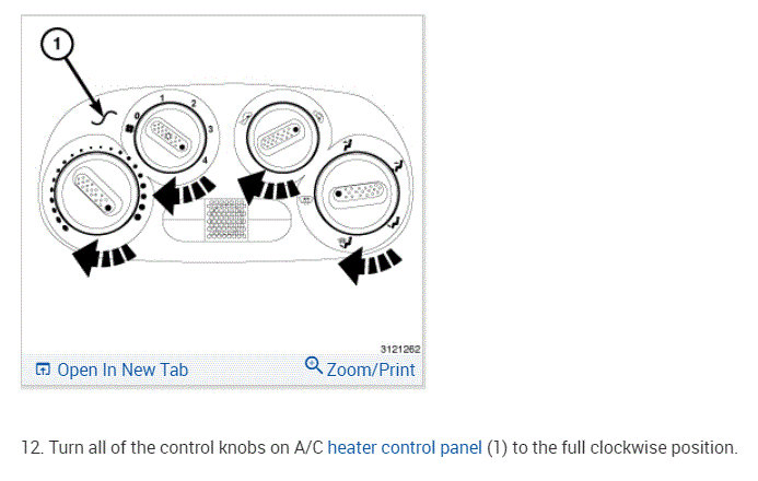

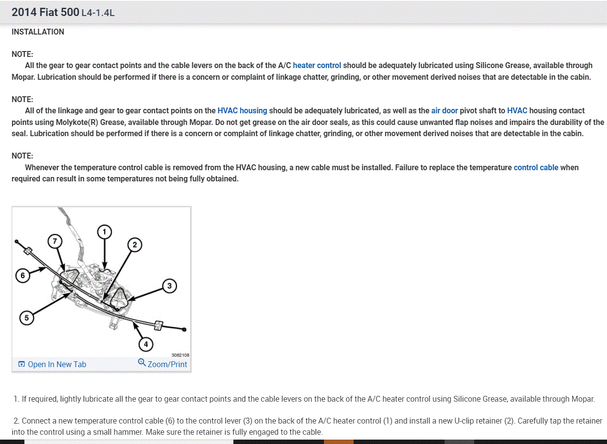

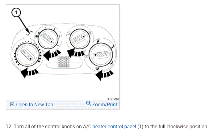

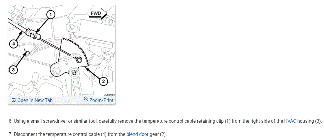

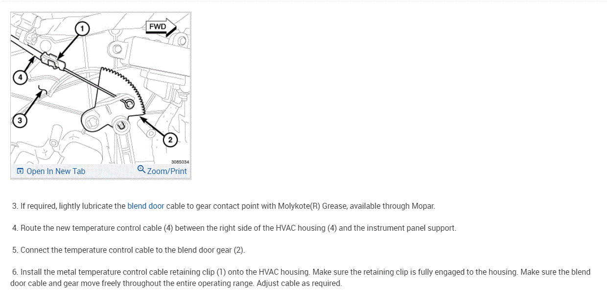

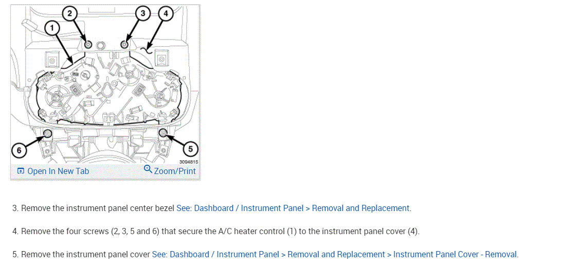

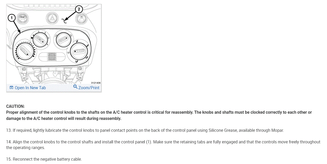

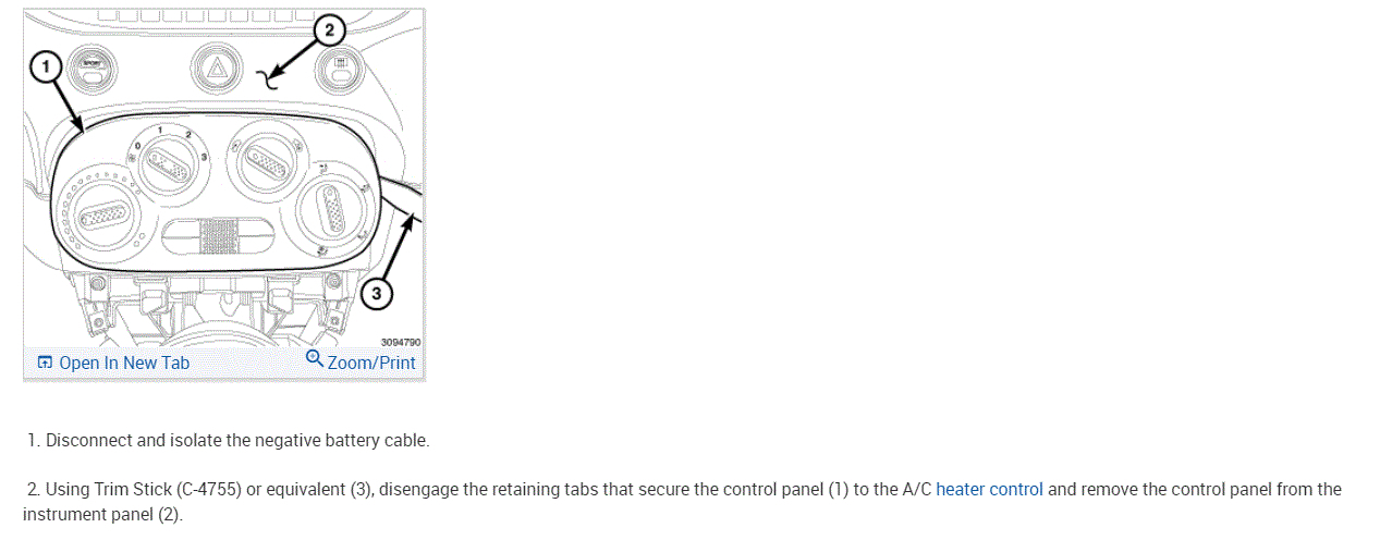

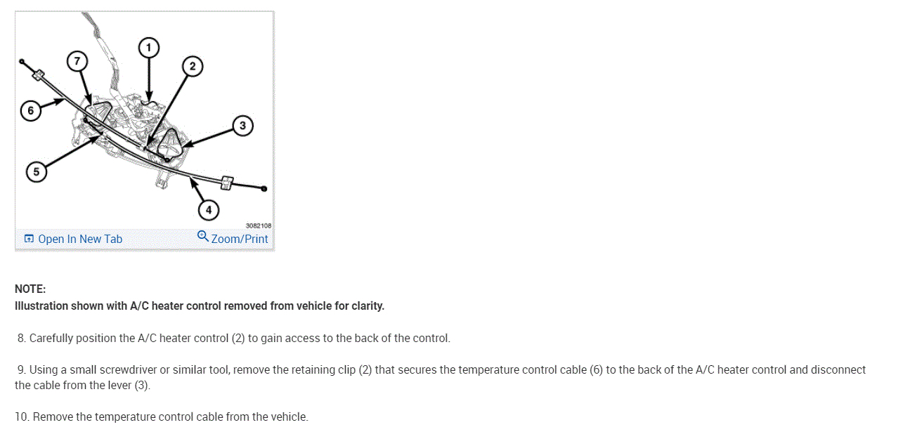

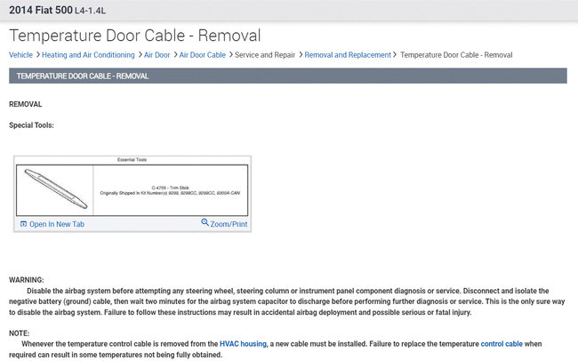

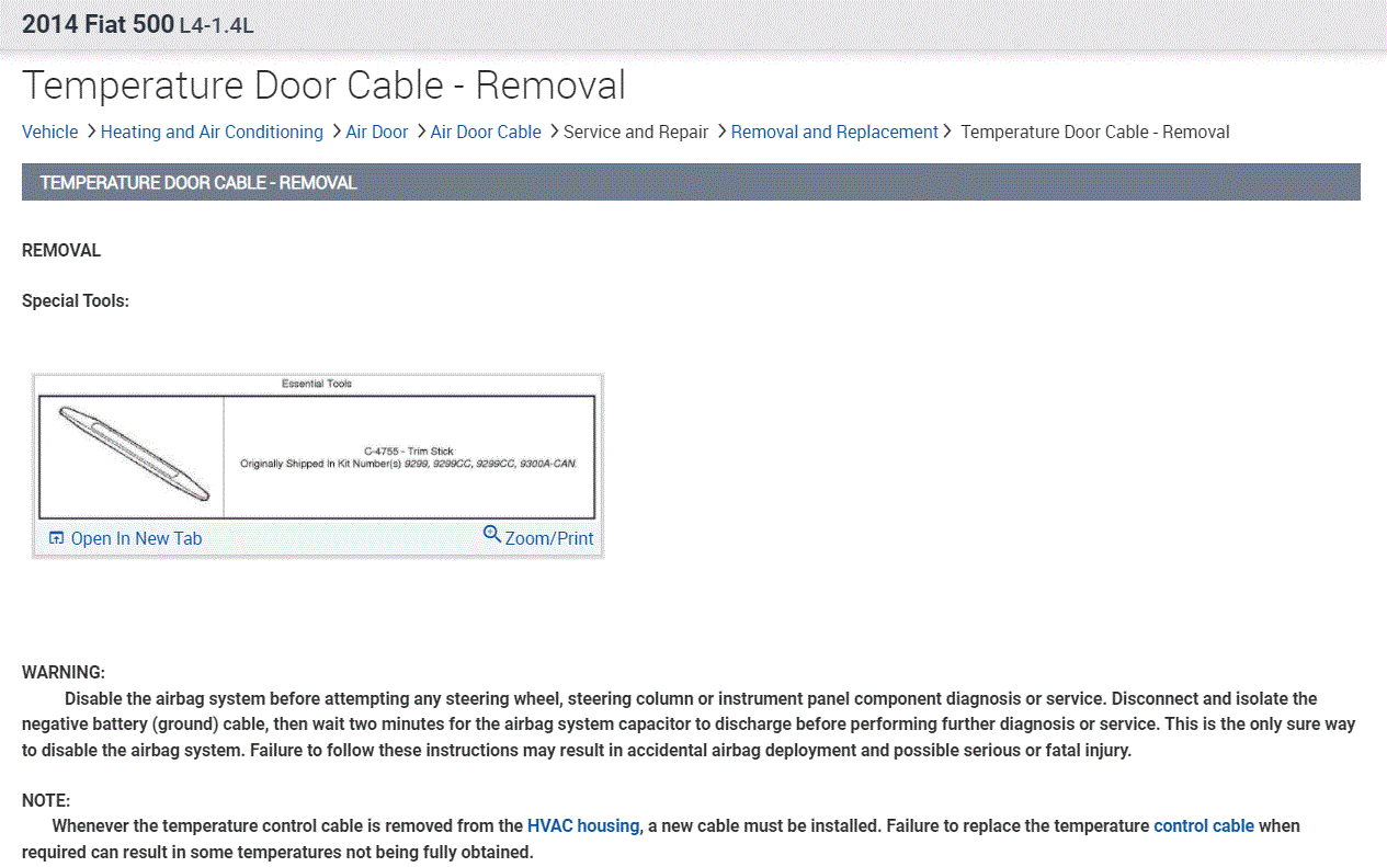

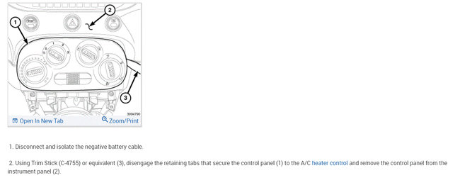

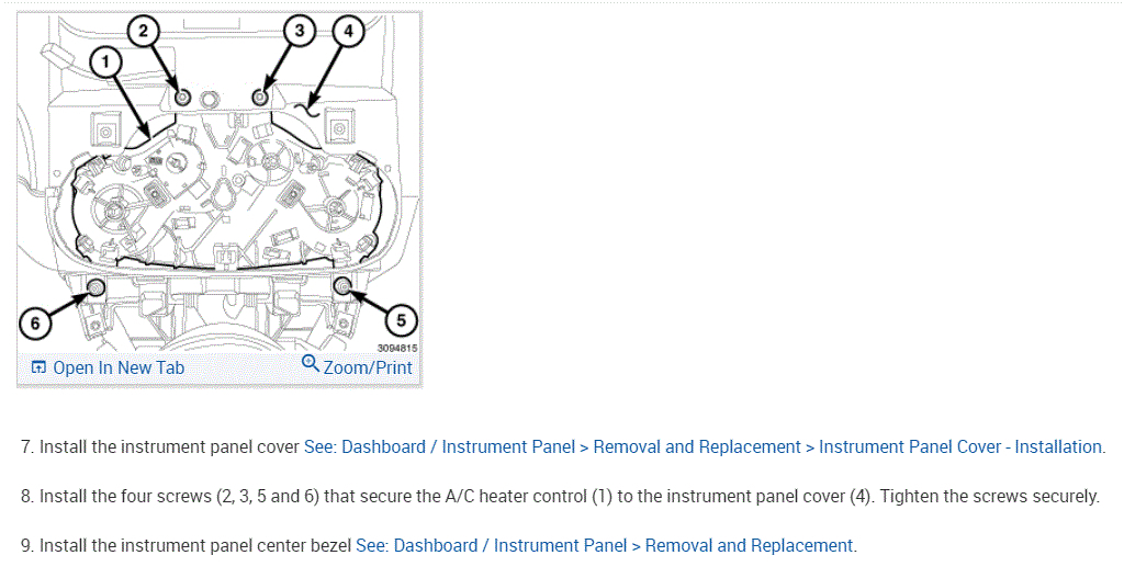

The knob that changes heat to cold is stuck in a small range as you see in the pictures. Wouldn't go past that. Not sure if these have cables that can get stuck or do i need to remove the knob and turn the grooves. Any help is appreciated.
