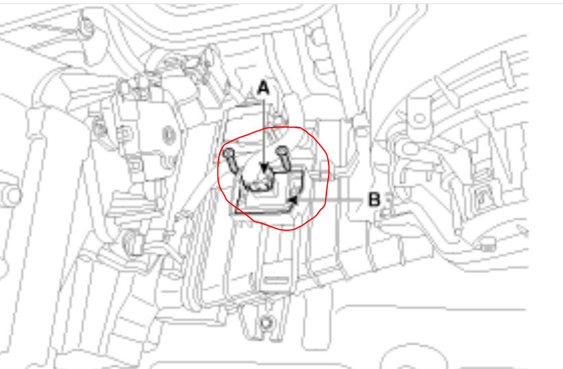

Are you referring to the blower motor speed? If so, is number 4 the high-speed setting? Can you make it run at any other speed?
Let me know. The idea that you need to wiggle the knob makes me think the controller is faulty. However, if it only runs at high speed, it sounds like the blower motor resister.
The resister is behind the glove box. I attached a pic of it for your reference.
See pic below.
