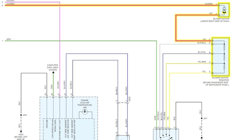

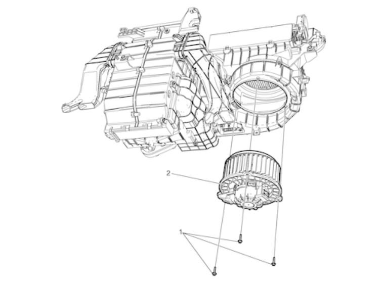

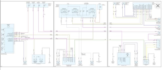

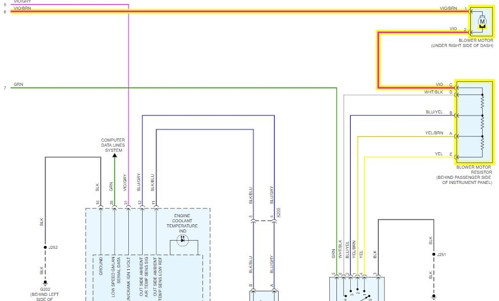

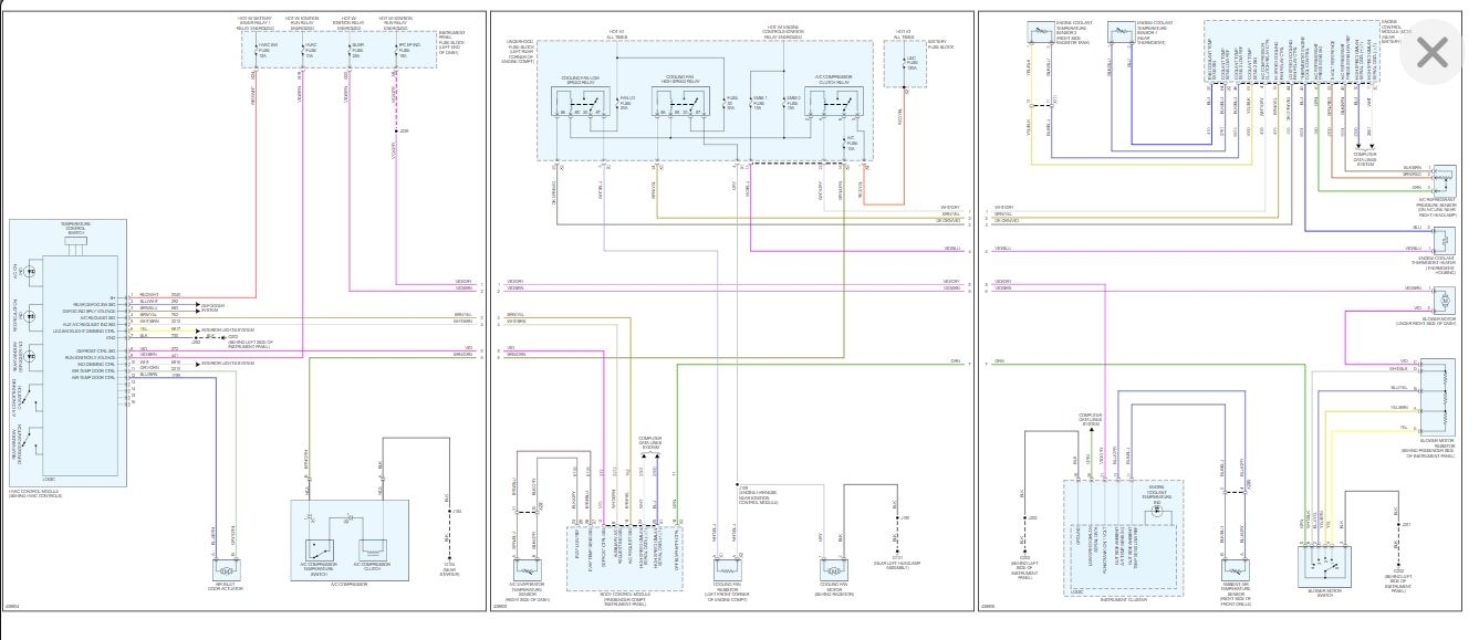

i am having issues with the car listed above's air conditioning. the compressor is working. but air is not reaching the vents. i have replaced the blower motor and no change. the control panel all lights are lighting up.
