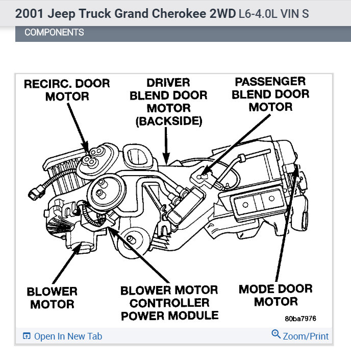

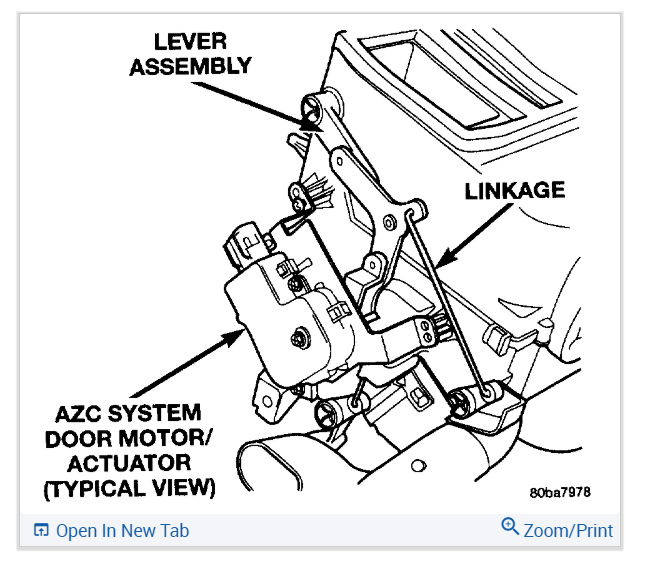

Does the drivers side get cold? It looks like this does have dual zone. Here are diagrams to help us see how the system works. Check the AZC actuator as well. Check out the diagrams (below). Please let us know what you find. We are interested to see what it is.

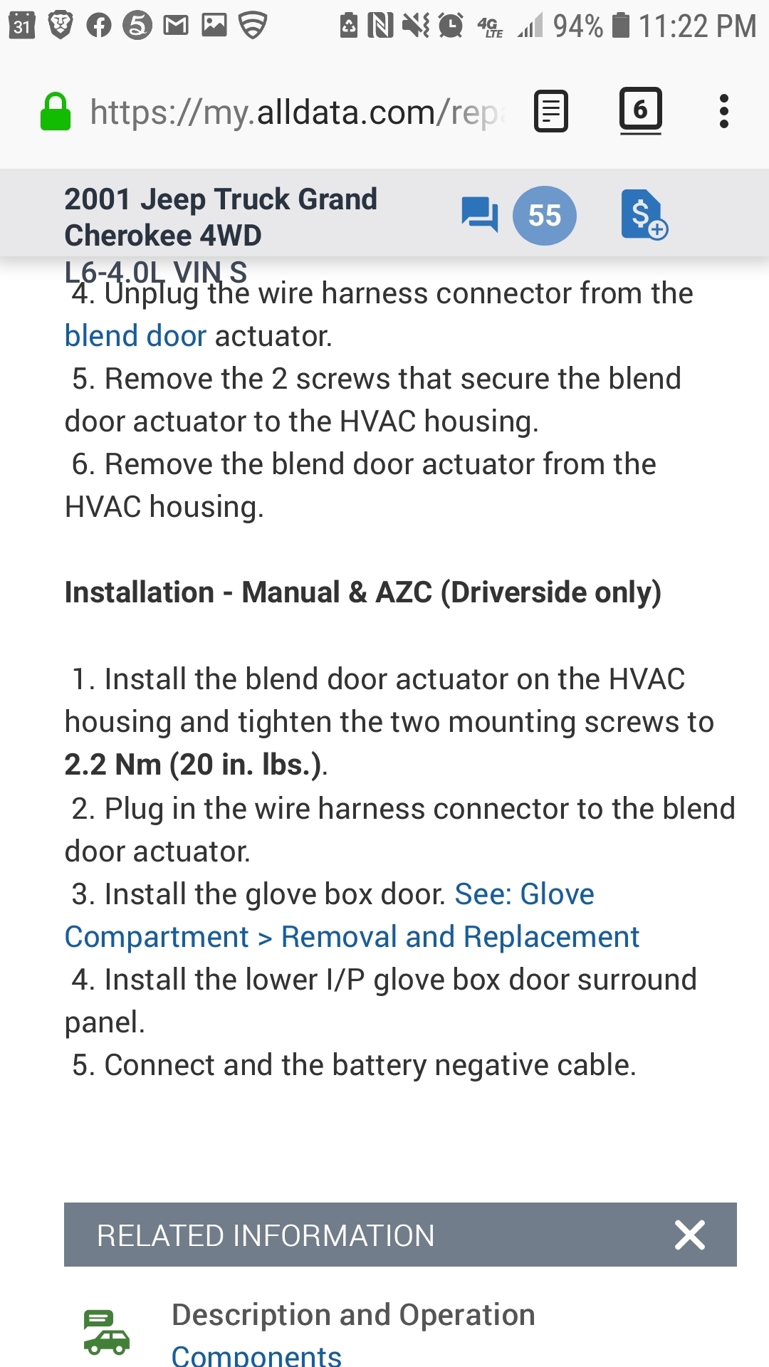

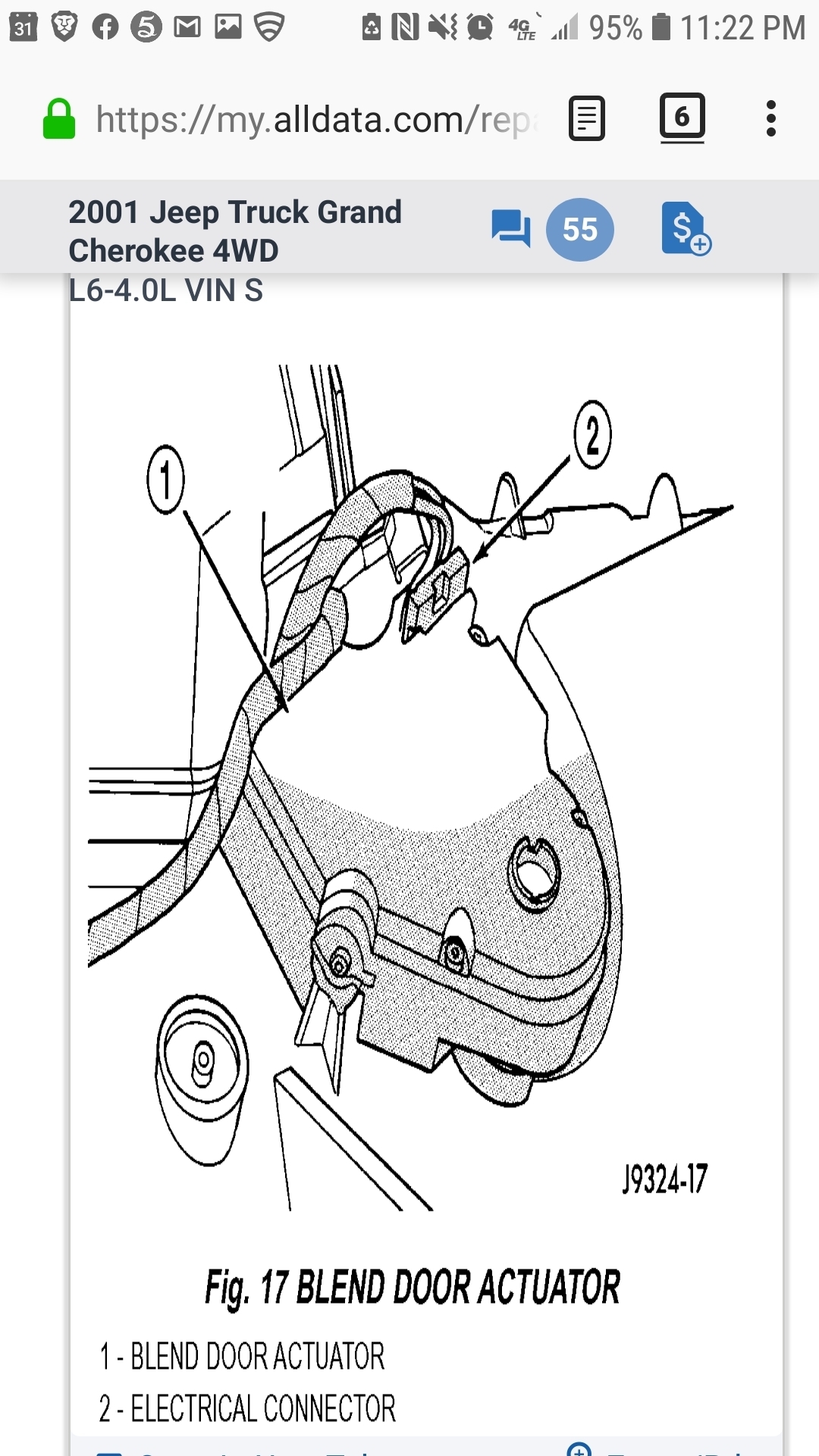

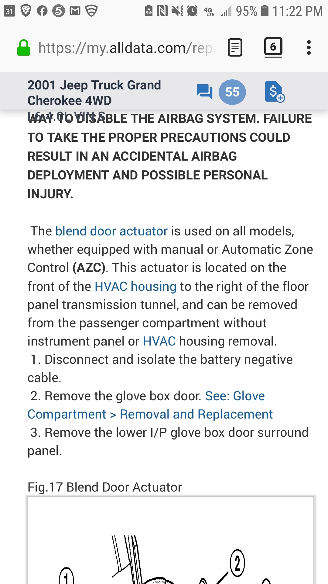

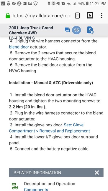

Okay. The next thing to do is to check that the under hood stuff is actually doing its job. Start the engine, crank the A/C all the way up, and open the hood. Look for the canister. It's a cylindrical silver metal thing with a couple of pipes coming out of it. I believe it's on the passenger side but could be mistaken. It should get pretty cold. Cold enough that condensation will form. If it's not that cold, then we have an issue under the hood and more testing is needed.
If it is super cold, then the issue is inside, probably with the blend door actuator or the door itself. I'm attaching Alldata's information on changing the actuator. Take the actuator off and with the car on switch the temperature between hot and cold and in between and see if the actuator moves accordingly. Give it a little resistance and see what it does too. If it does as it's supposed to, then set it aside and check the operation of the door by manually turning the rod that connects the door to the actuator back and forth. You should get hot and cold temperatures as you go from one extreme to the other.
Let us know what you find.
