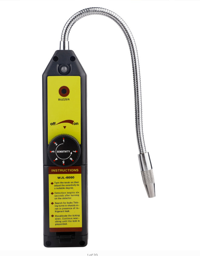

Sorry, yes you are correct with this being a hybrid you must use a gas leak detector. Basically they are called sniffers and they beep when they pick up Freon. However, that requires you to fill the system again and then start it and run it and see where it is picking up the Freon.
Otherwise, we would have to relay on feeling it or hearing it and that is near impossible.
They sell these things at most parts stores. You can get a cheap one for less then $50.00 if you care to do it. However, they are sensitive to storage so make sure it is in a cool dry place. Since you won't use it often, if not stored properly it will turn into a single use tool which is not desirable.
See below for a picture of the most common one. I would pick up a pair of insulated gloves as well just because you may poke around the high voltage system and just to be safe, you want to protect yourself.
