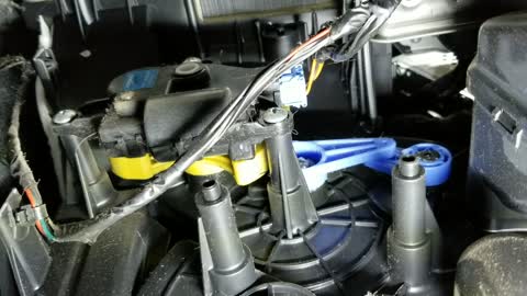

I turn in the air and it will come out of the vents and from the floor. I push the button for defrost and it moves to defrost them I put it back to vents and it blows normally for a few minutes and then starts moving to the floor again. It never moves all the way to the floor. Is this in the blend door or do I need to replace the AC controller?
