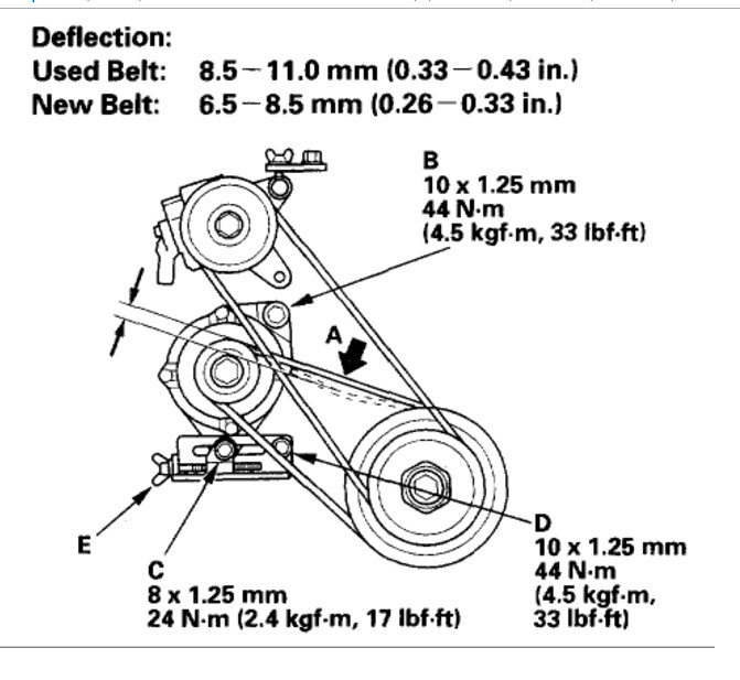

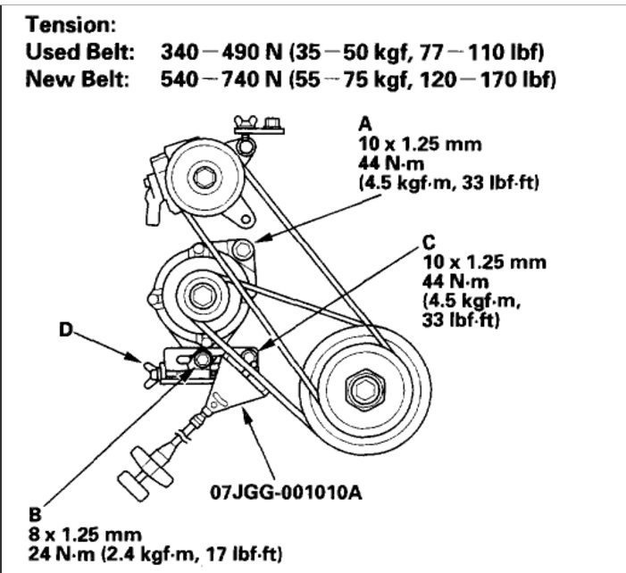

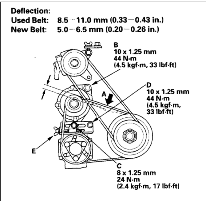

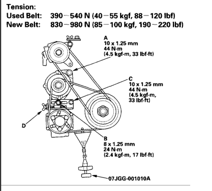

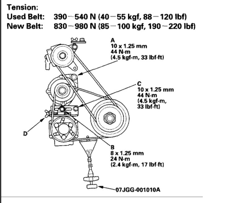

A/C squeals when idling. Checked and adjusted belt. No cracks in belt and feels like it has some grip (not slick).
Aug 7, 2017 at 6:15 PM
It sounds like the belt is glazed which will create the sound you are describing. Here is a guide to help you get the problem fixed and some diagrams (Below)
https://www.2carpros.com/articles/replace-serpentine-belt
you may need to jack the car up.
