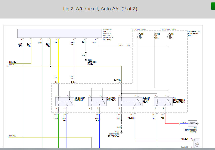

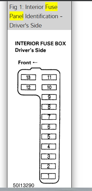

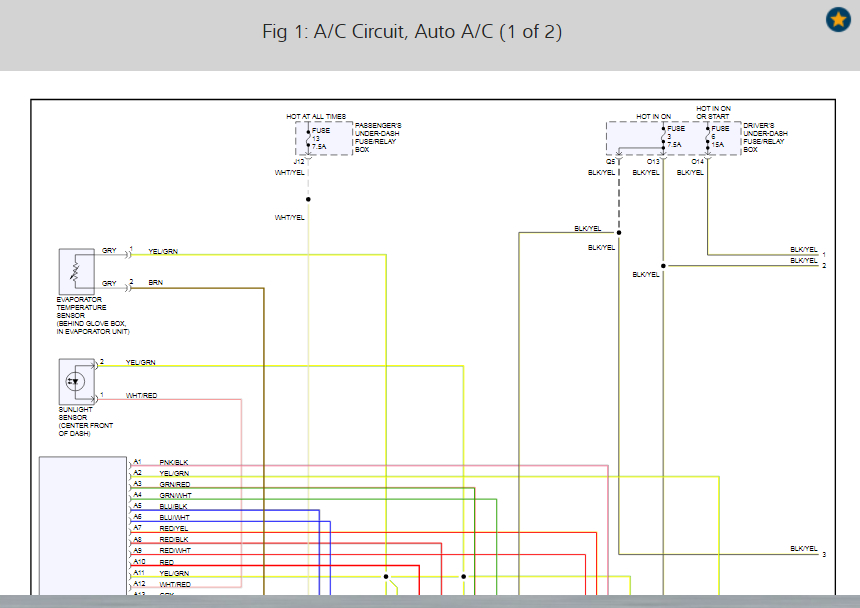

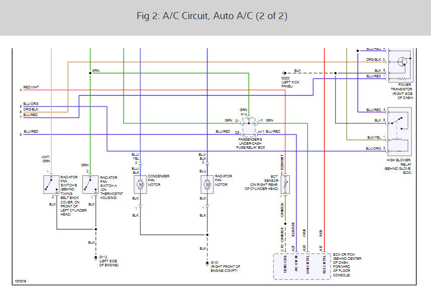

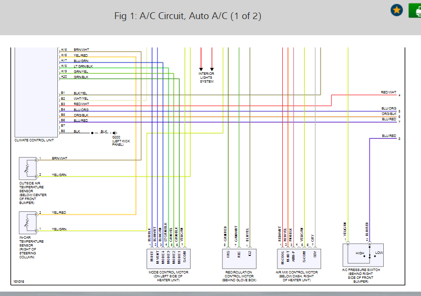

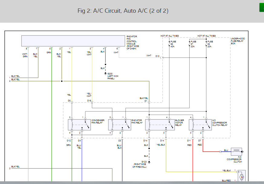

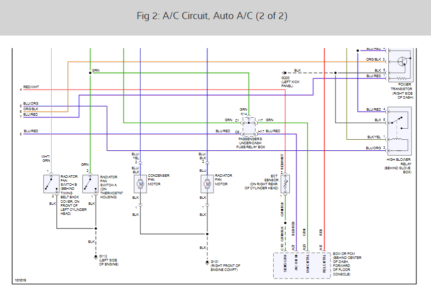

No air in cabin replaced with new blower motor and resistor and still no air. What should I check next?
Jul 20, 2019 at 5:15 PM
SCGRANTURISMO
  • 4,897 POSTS

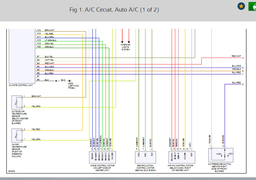

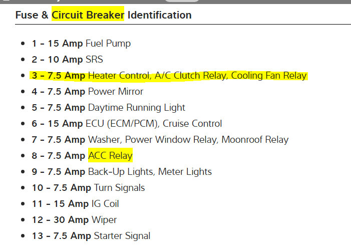

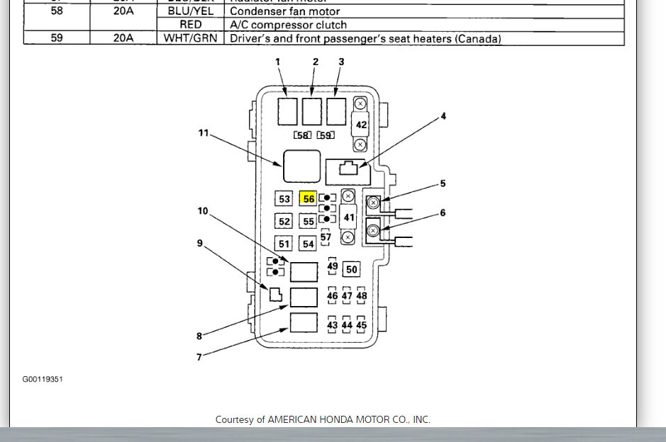

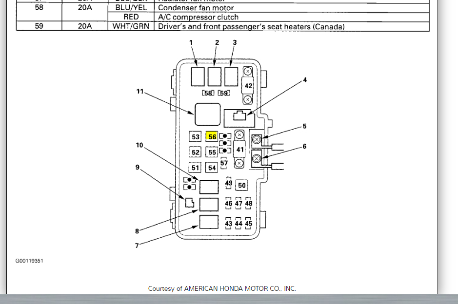

The fuses that need to be checked are fuse #3 (7.5A) in the drivers side under dash Fuse panel and fuse #56(40A) in the Under hood Fuse/Relay Box. The Blower Motor Relay is also included the under hood Fuse/Relay Box as well. In the diagrams down below I have included the A/C wiring diagram for your vehicle as well as the diagrams and callouts for both the fuse panels. Please go through these guides and get back to us with what you are able to find out.
