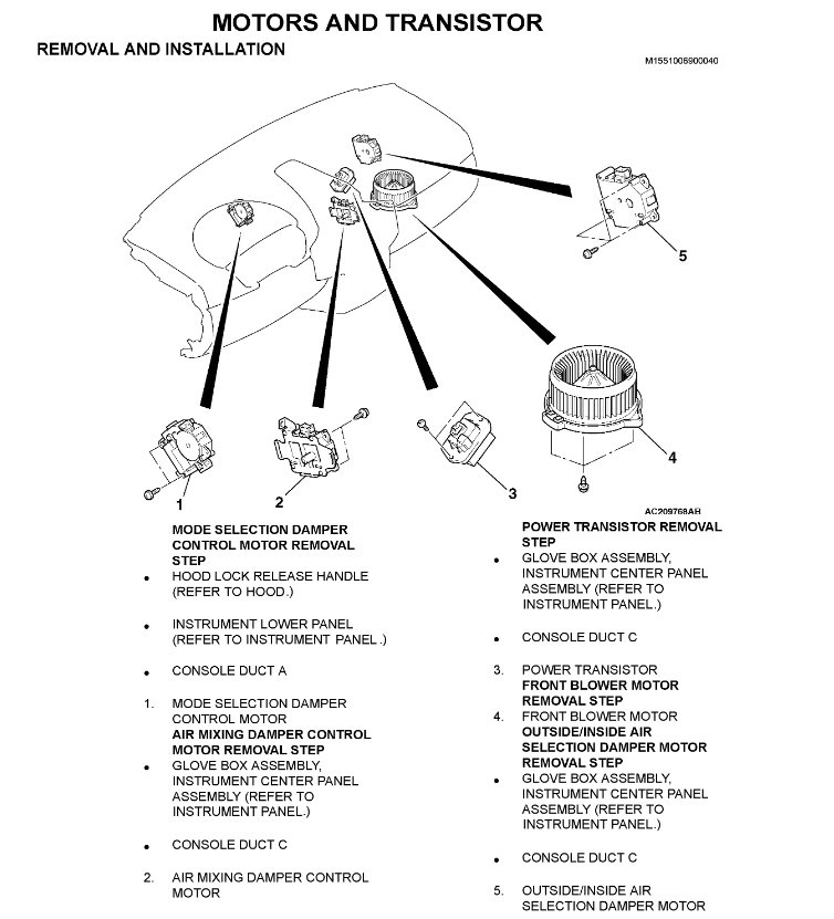

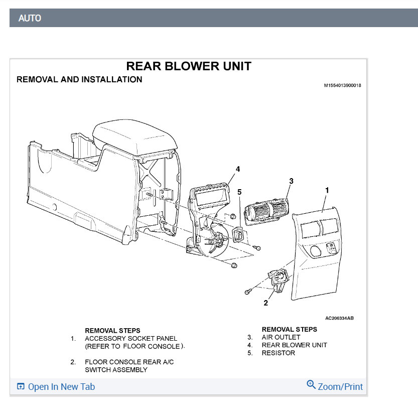

This is common when the HVAC blower motor goes out. To be sure we can check for power at the motor using this guide. I have included the blower motor location and how to change it out in the diagrams below.
https://www.2carpros.com/articles/blower-fan-motor-works-on-high-speed-only
