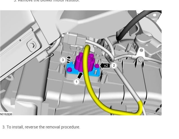

Procedure for resistor
Removal and Installation
Remove the passenger side lower instrument panel insulator.
Disconnect the ambient lighting electrical connector (if equipped).
Remove the passenger side lower instrument panel insulator pin-type retainers and remove the insulator.
Remove the blower motor resistor.
Disconnect the blower motor resistor electrical connector.
Remove the blower motor resistor screws.

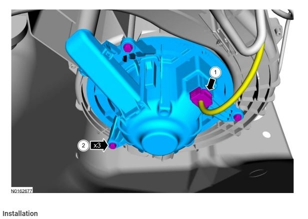

Blower motor location
Removal
Remove the passenger side lower A-pillar junction box cover.
Remove the blower motor.
Disconnect the blower motor electrical connector.
Remove the blower motor screws and remove the blower motor.

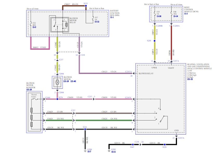

I also attached a wiring diagram for you. check the fuses listed for the relay for power on both sides
