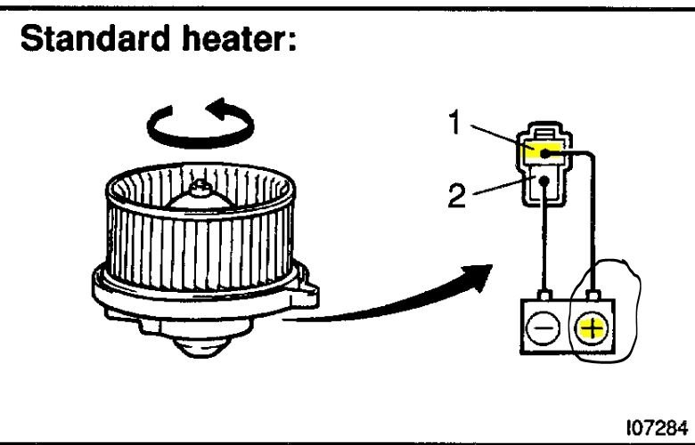

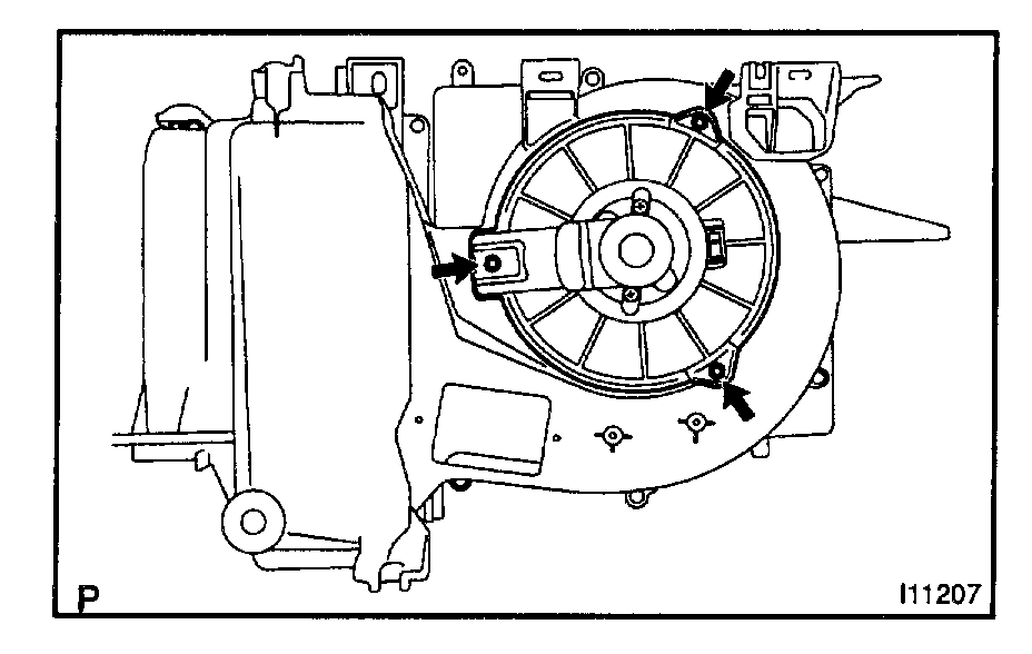

I attached three pictures below. The first one shows the blower motor assembly. It is behind the glove box.

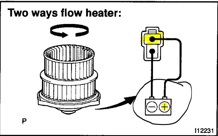

The next two show which wire should be getting power when it should be running. There are two different types of motors that could have been used. You will have to use the pics I attached to identify which one you have.
Using a test light, check to see if there is power to the motor as indicated.
