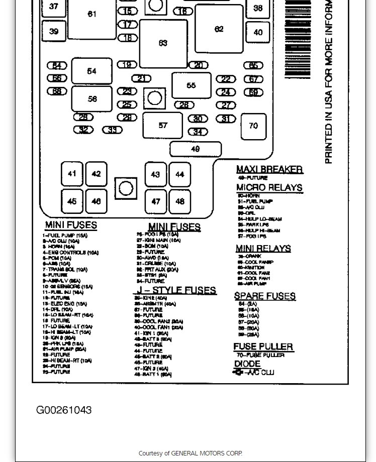

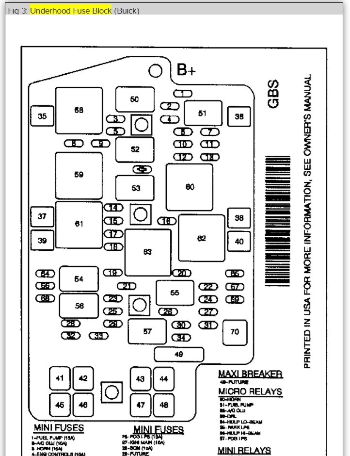

It could be a couple of different things. Lets start by checking the fuses first. Here is a guide and a diagram (below) that will help you check.
Please run this test and get back to us we are interested to see what it is.
