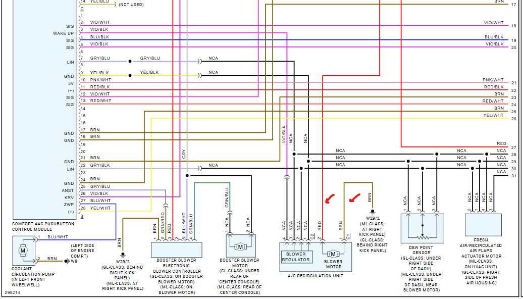

The blower motor resistor is made into the blower motor. Did the blower motor have more than 2 wires? If it has 6 wires, then you know the resistor is built in. I would check for power and ground at the blower motor with the system on.
Here is a guide to show you what I am talking about:
https://www.2carpros.com/articles/how-to-test-an-automotive-hvac-system-blower-fan-motor-a-detailed

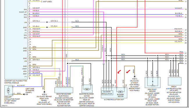

If there is no power to the red wire, please check the #91 fuse in the fuse panel behind the right front seat. The brown wire is ground. Check out the images (below). Let us know how it goes.

Can you confirm the blower motor is getting power and ground? Also, since the fuse was blown, I would check the electrical connectors. You should have power to the red wire with the system on?
Please go over this guide:
