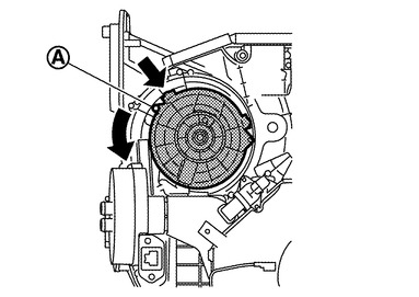

Here are the directions specific to your vehicle. There are several things that need removed, so if you need help with any of them, let me know. Pic 1 correlates with the directions.

Disconnect the harness connectors from the blower motor.
Disconnect the harness connector from the thermo control amp.
Remove the blower motor screw (A).
Picture 1
Press the flange holding hook and turn blower motor counterclockwise.
Remove the blower motor.
INSTALLATION
Installation is in the reverse order of removal.
