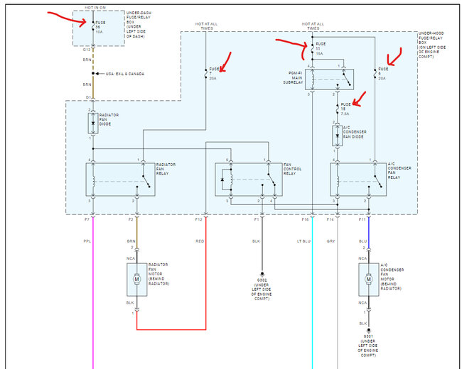

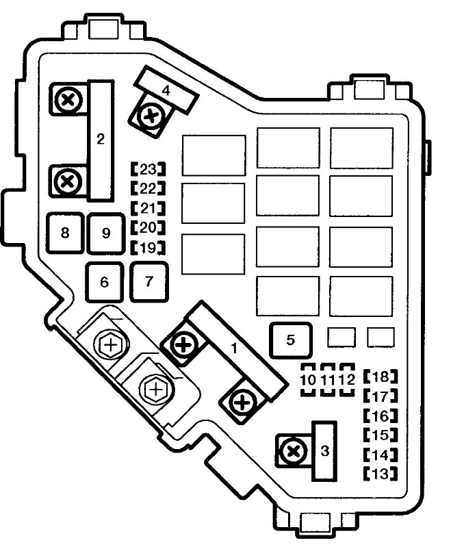

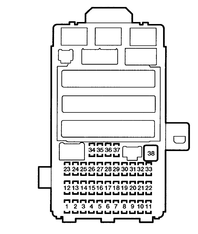

You might have disconnected the wiring to the fan module, so please check that. here is a guide and the fuses we must check first before we move forward. This guide can help and the fuse location in both under hood and under dash fuse panels or in the images below.
Check out the images (below). Let us know how it goes.
