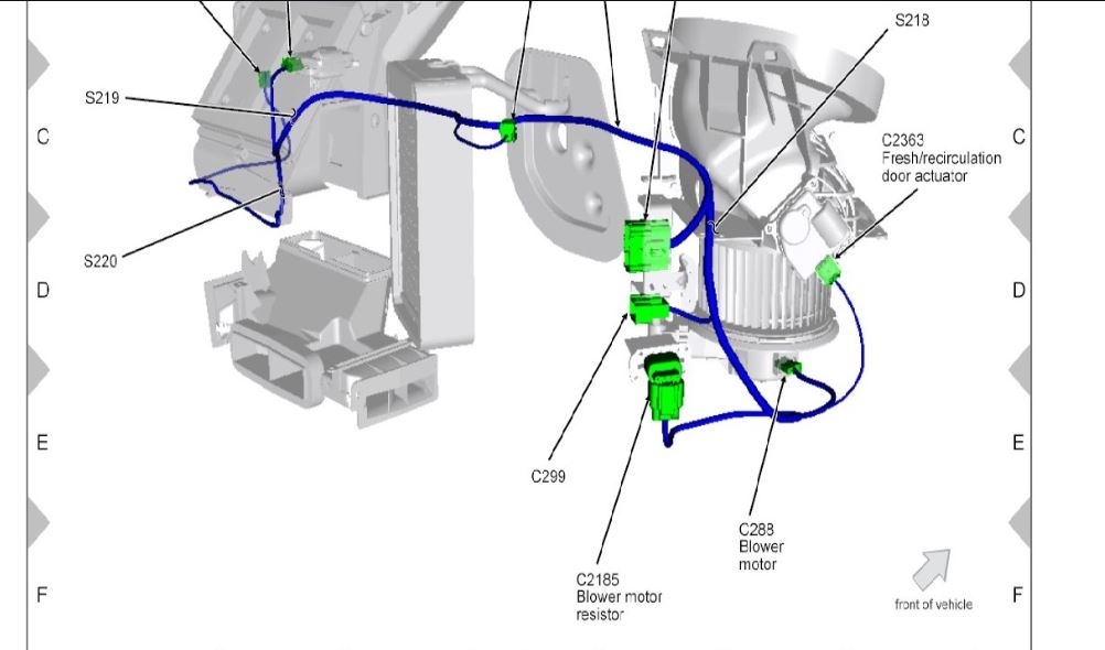

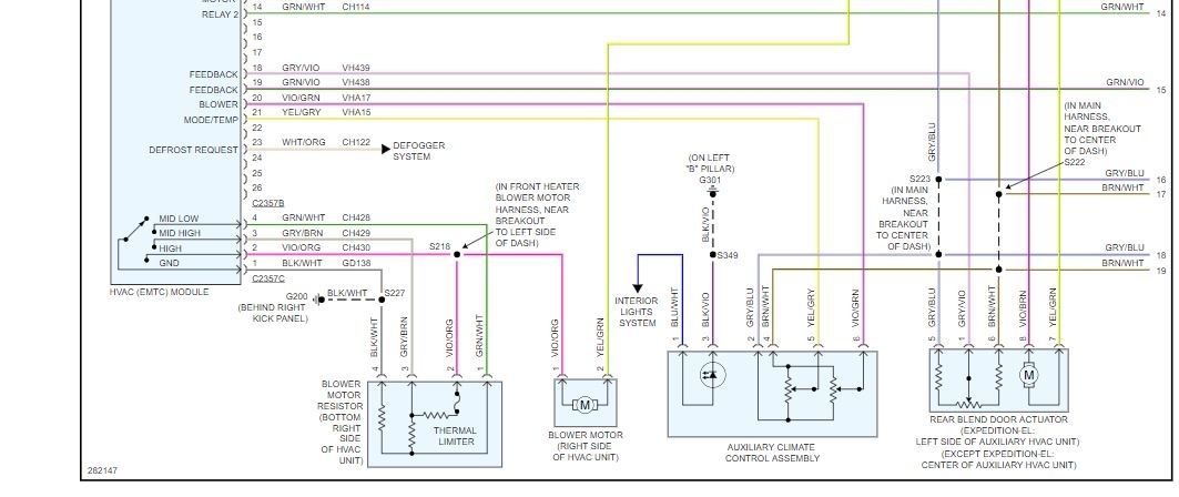

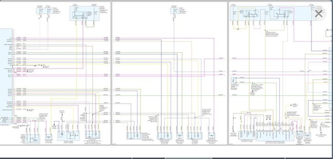

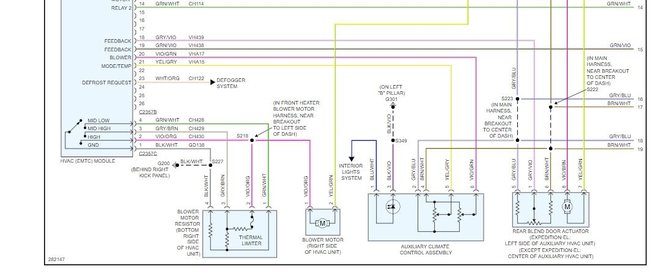

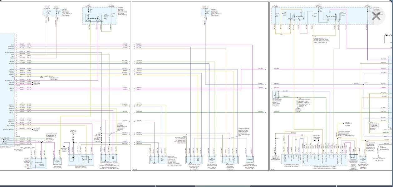

Good afternoon,
It sounds like the blower resistor is your issue. They are common for causing this issue along with the connector overheating and causing a bad connection.
Removal and Installation
1. Disconnect the blower motor resistor electrical connector.
2. Remove the 2 blower motor resistor screws.
3. Remove the blower motor resistor.
4. To install, reverse the removal procedure.
