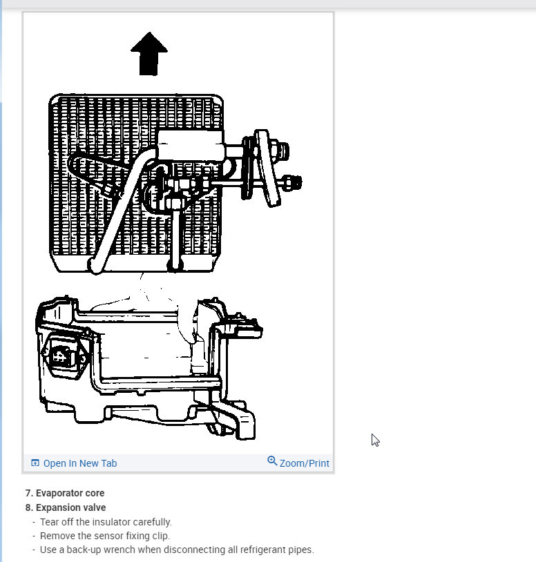

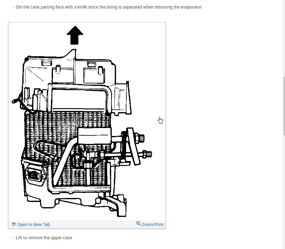

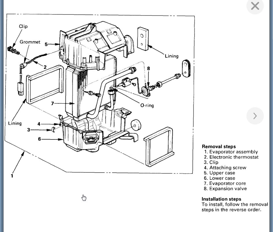

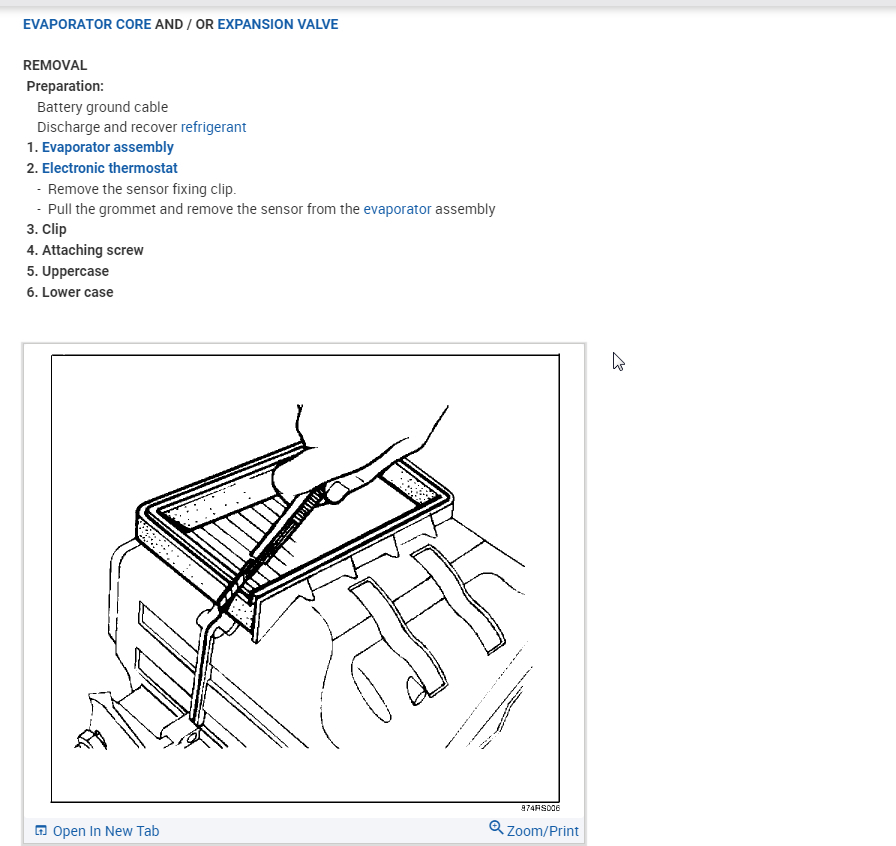

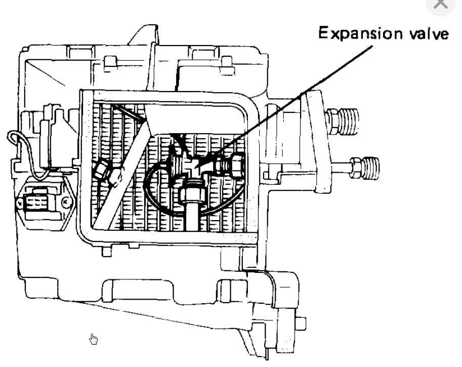

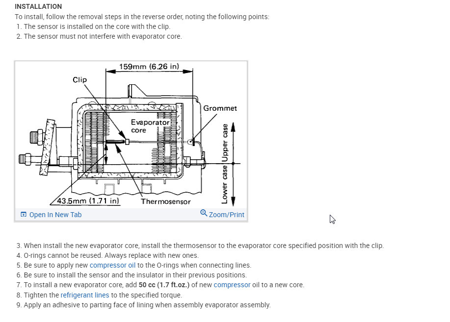

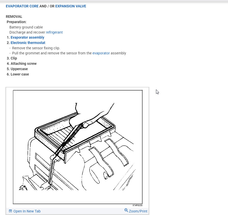

Just got the A/C compressor, and the dryer changed out. I am not able to locate the expansion valve. If I could get the location and what I need to do to access it that would be awesome. Thanks
Jun 13, 2020 at 4:44 PM

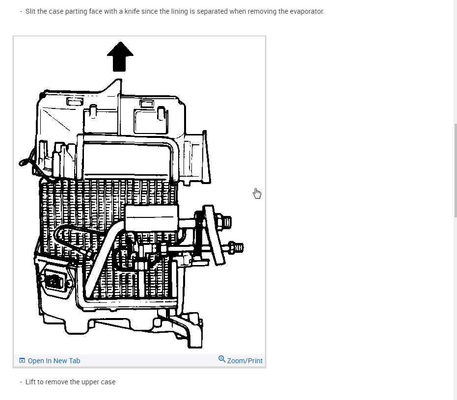

I attached all the requested info. Let us know if you need more info. Thanks
Jun 13, 2020 at 4:55 PM
ZIMMSUSIE
  • 8 POSTS
Since I wasnt sure where it was located I started behind the glove box and there it was. Thank you for the diagrams!
