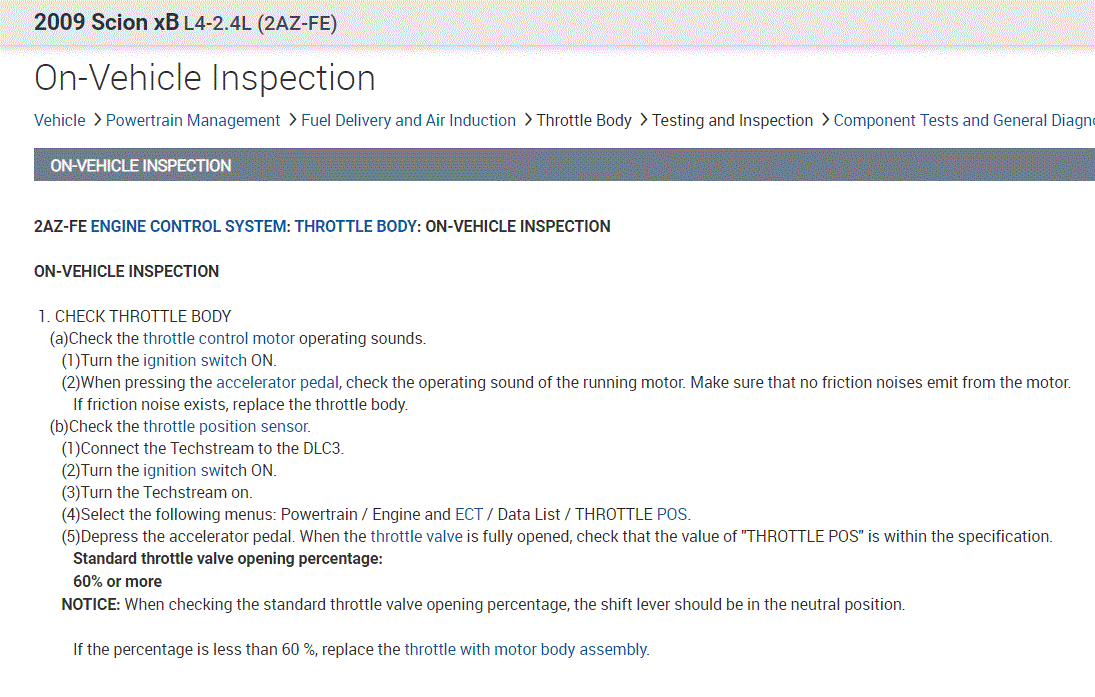

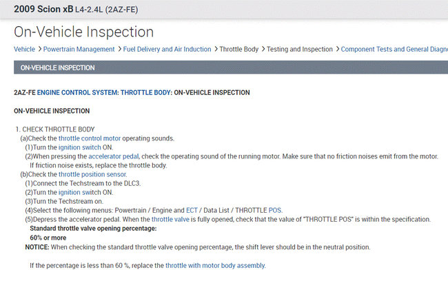

If possible, have the shop test the throttle body / throttle control motor. I attached the directions below for doing it. It will require a scan tool that can communicate with and actuate different functions.
Let me know if you have questions and if there are any codes.
See pics below.
