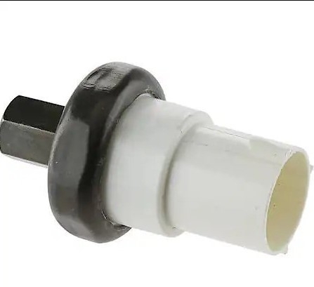

Had a mechanic check A/C. He put Freon in but still wouldn't blow cold. He checked the rest of the system and said to get this (picture below) replaced and we'd try again.
I don't have access to him anymore.
3 questions: name of part, is it something I can replace (have basic repair knowledge) and if that doesn't work, what is my next step?

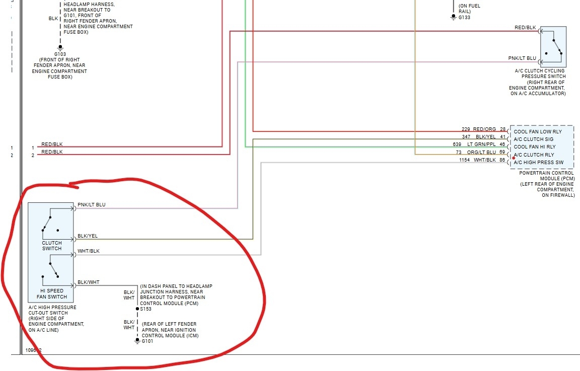

That is the high pressure cut off switch F58Z19D594A. Should have 4 wires going to it. Easy to change but also very easy to test if it's the problem. To test it you just need a short piece of wire that you can bend into a U shape. It's basically 2 pressure switches that toggle when the pressure is high in the system. One toggles closed and turns on the high-speed fan circuit for cooling and the other toggles open to turn off the AC compressor clutch. To test it you simply unplug it, then take the wire and look at the wire colors on the outside of the plug. You want the Pink with light blue stripe and the Black with yellow stripe wires. Jumper those two pins in the harness connector with the short wire. Test if the AC now works. If it does that switch is bad. That switch goes onto a fitting that has a valve in it that is supposed to seal if it is removed, that allows the switch to be changed without recovering the refrigerant, BUT being this is a 99 and that switch hasn't been removed I'm not going to say it still works as it should. However all you should need to do is disconnect the connector and unscrew the switch, the valve should seal as you remove it, then you screw on the replacement and connect it. In theory all of that can be done without any loss of R134a.

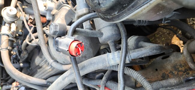

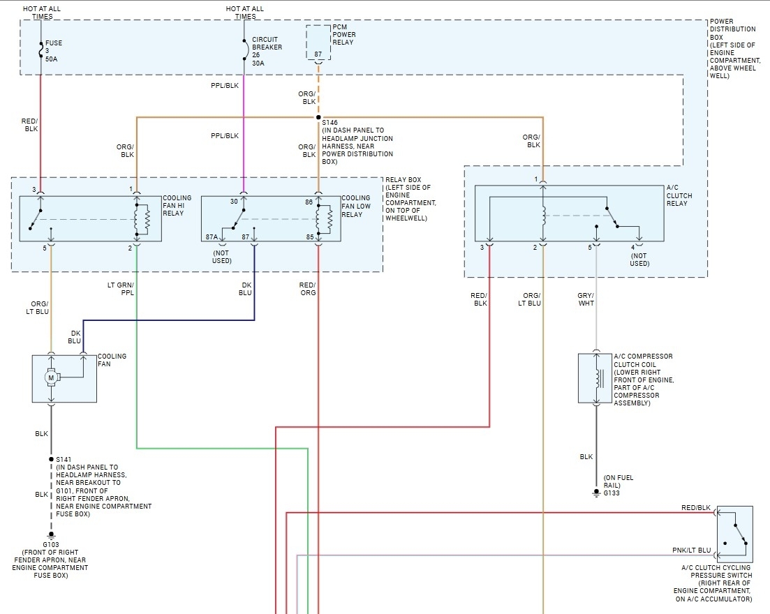

A/C still blows hot when I jumped it. Not sure if freon is still in it. I'm going to replace the switch. Can I put freon in or does it have to be someone certified? Trying to keep Bessie going for my 12 year old granddaughter who loves her as much as I do. Thanks for all the comments to help me.
Apr 28, 2025 at 4:12 PM
STEVE W.
  • 15,113 POSTS
If the jumper didn't cause it to operate then it's likely not that switch. I assume the compressor on the front of the engine didn't start working. There is a second switch that also controls the compressor.

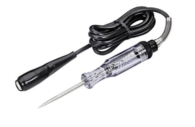

However If you would like to continue testing, I'd like to start at the basics, just in case the shop skipped a step or just missed a failed part. First I'd like you to test the fuses, looking at them really doesn't tell you if they are good anymore. Most of them we can say are good because they power other systems as well and you are not saying those are a problem. The only one that is concerning is fuse 6 It provides power to the control module and the clutch control circuit. To test it you need a simple test light. We can test the fuse and the other control switch right in the same connection you jumped before. Use the test light and touch it to the pin where the pink and light blue wire is with the key on, if the fuse, switch and wiring are good it should light. That would tell you that the clutch cycling switch is okay, and that is another compressor control. If it tests good then the next thing I would do is verify the charge in the system. If he had to add R134 the first time it's possible it has a leak but I would think he checked that before adding any, but it's the next step. Then the A/C relay. to see if that is getting the signal to turn on and that it actually is. Let me know how far you and your grandchild want to dig though, A/C work can be frustrating.
