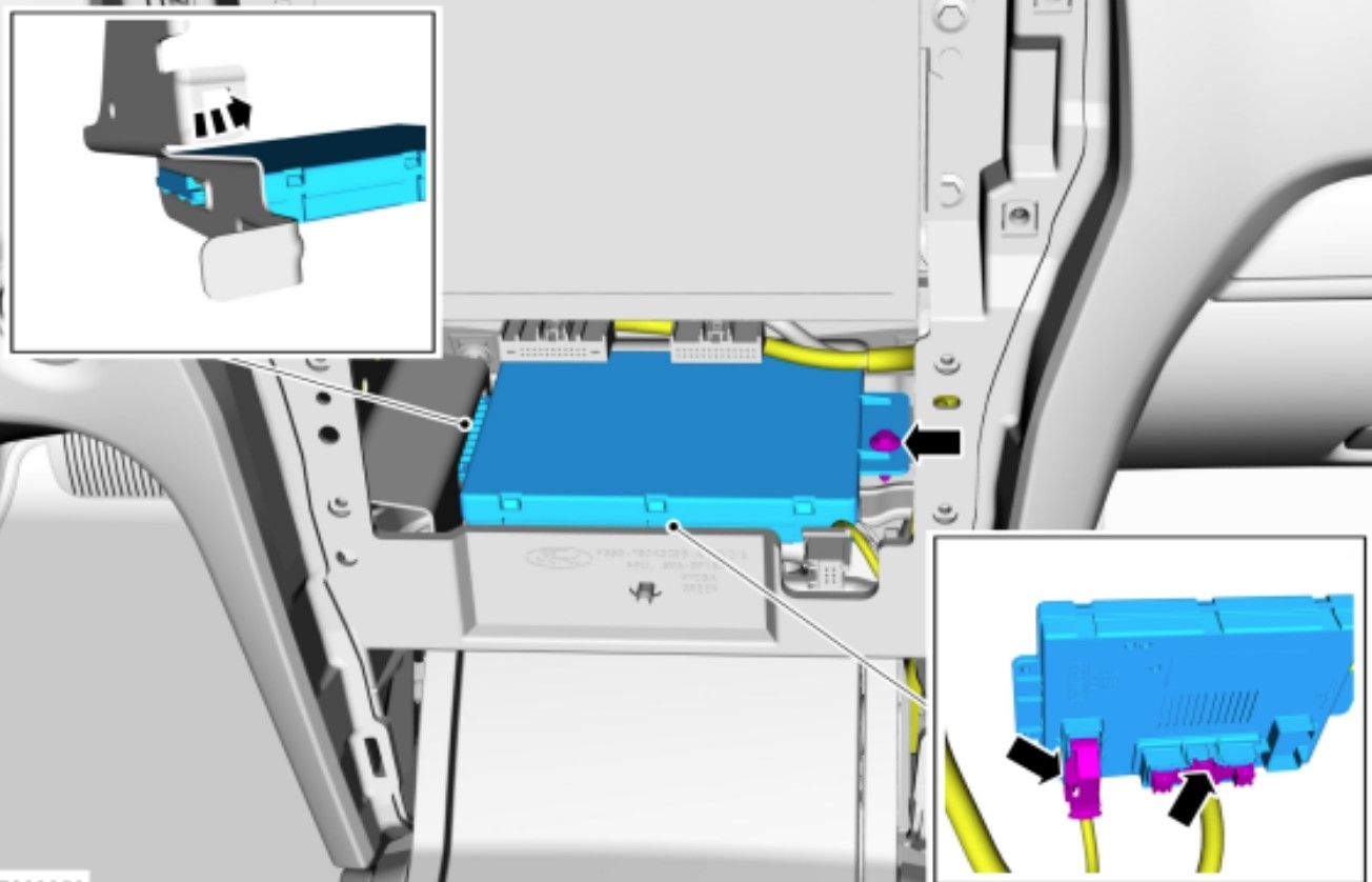

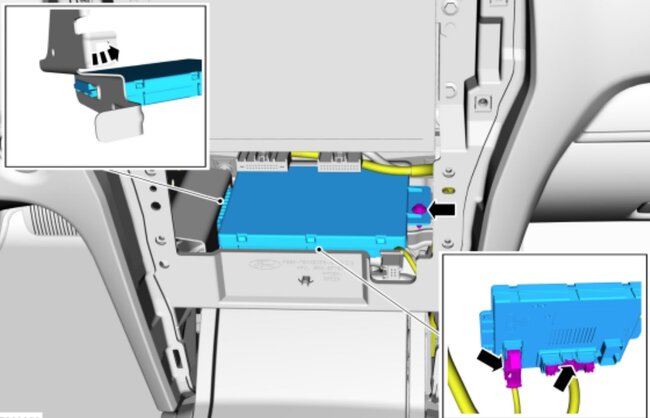

Replacement of the control head.
Removal steps in this procedure may contain installation details.
If installing a new module, it is necessary to upload the module configuration information to the scan tool prior to removing the module. This information must be downloaded into the new module after installation.
Using a diagnostic scan tool, begin the PMI process for the HVAC control module following the on-screen instructions.
Remove the Audio Front Control Module (ACM) (this is the entertainment and display in the center of the dash.
Remove the bolt and the HVAC control module. Disconnect the electrical connectors. Reverse to install the replacement and finish the PMI process with the scan tool.

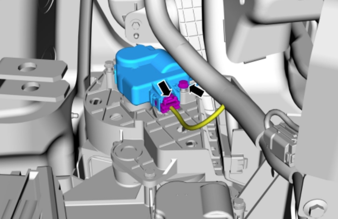

Replacement of the actuator though requires removal of the brake pedal and bracket and then removal of the instrument cluster in order to access the actuator on top of the HVAC housing.
This is a pretty good video on the actuator replacement:
https://www.youtube.com/watch?v=LIDLq4jLZXE
