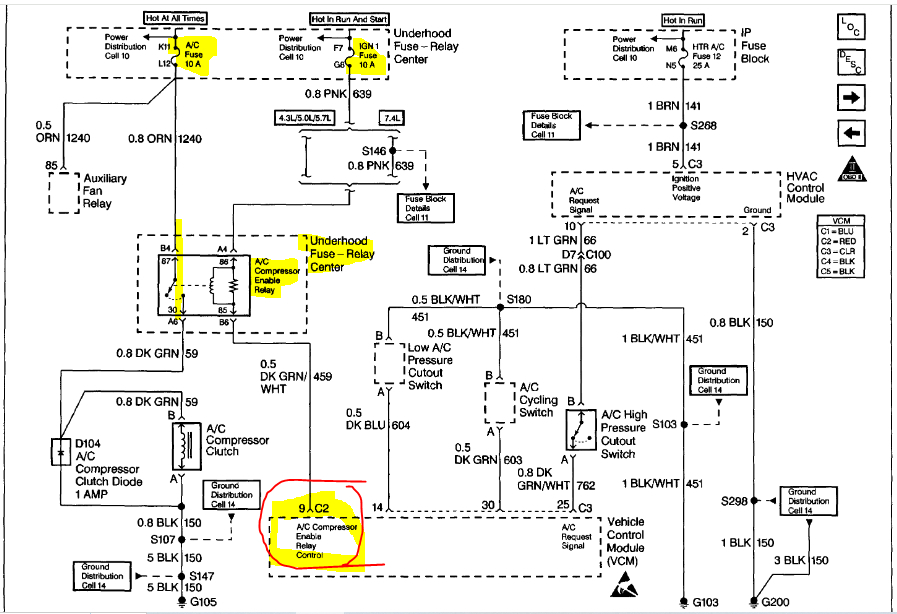

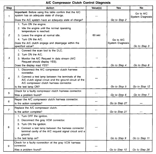

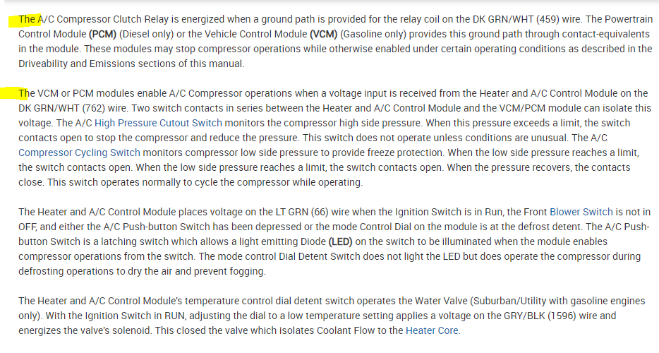

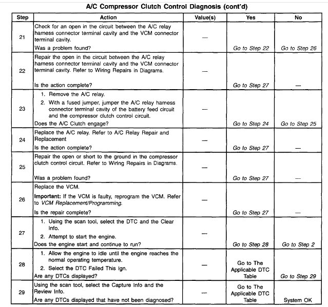

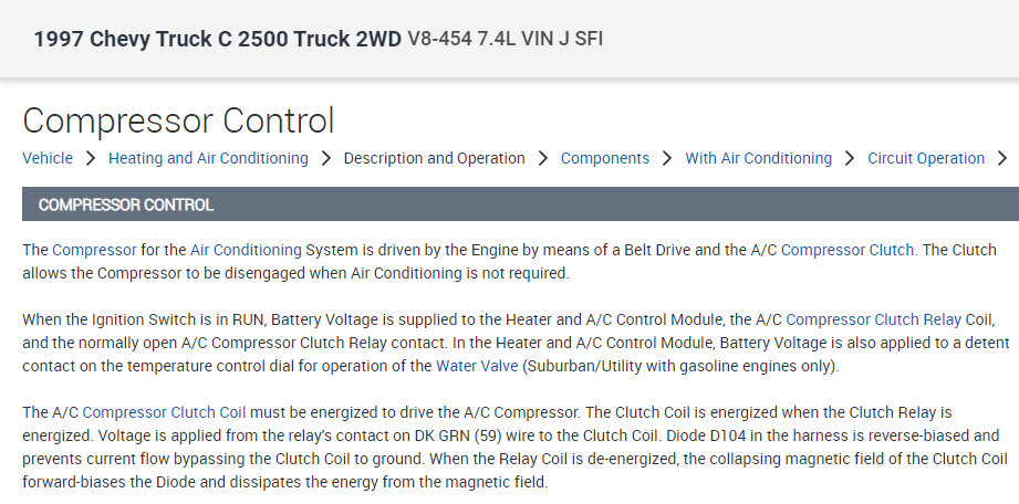

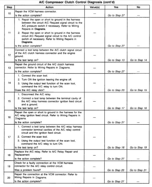

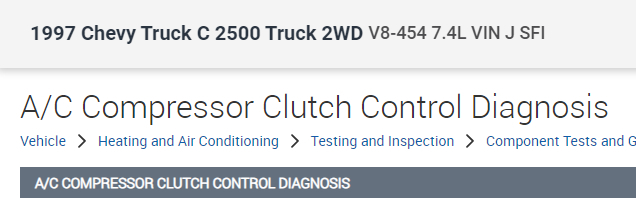

I attached a few things below. First, a detailed explanation of how the system works. Next, there are diagnostics. Last, I attached the wiring schematic and highlighted areas of interest. Note: The highlighted and circled point at the PCM (AC enable relay control. Make sure there is a ground path being provided via that dark green wire with a white tracer when the system is turned on.
Let me know if this helps. Note: I assumed this is a 3/4 ton vehicle. The 7.4 wasn't offered in the 1/2 ton model.
See pics below.
