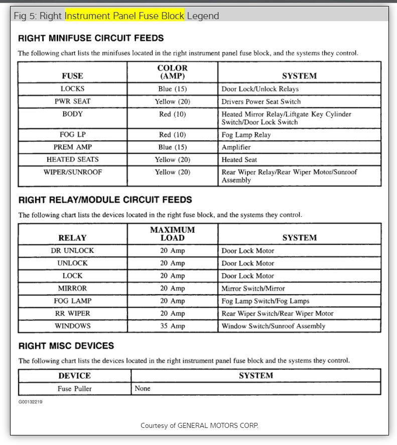

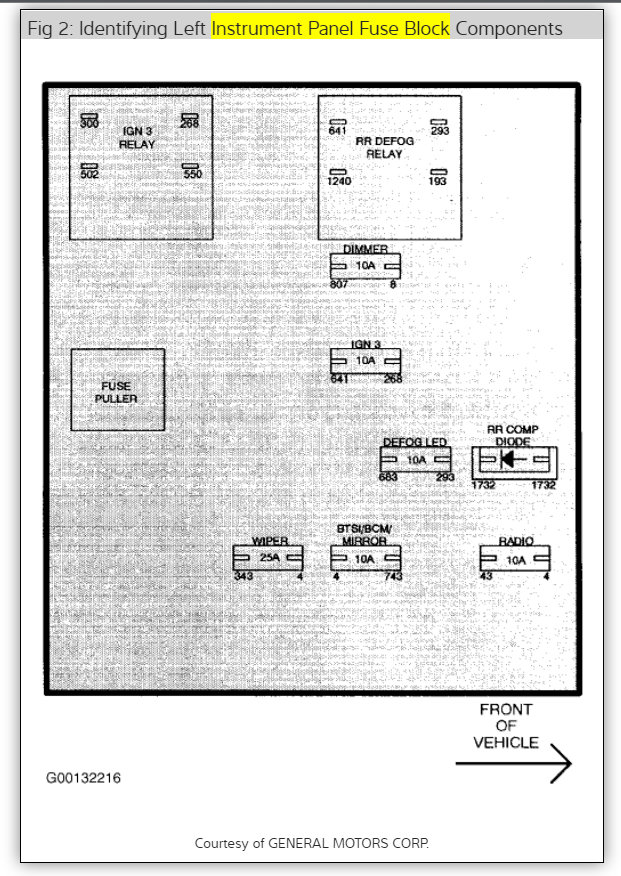

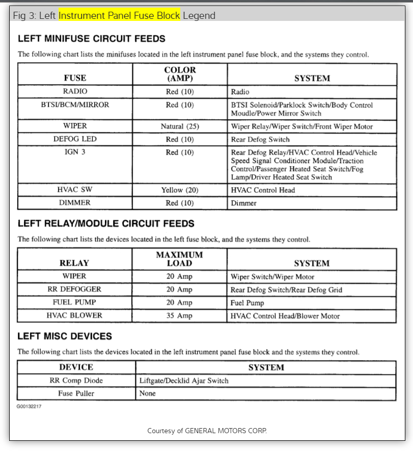

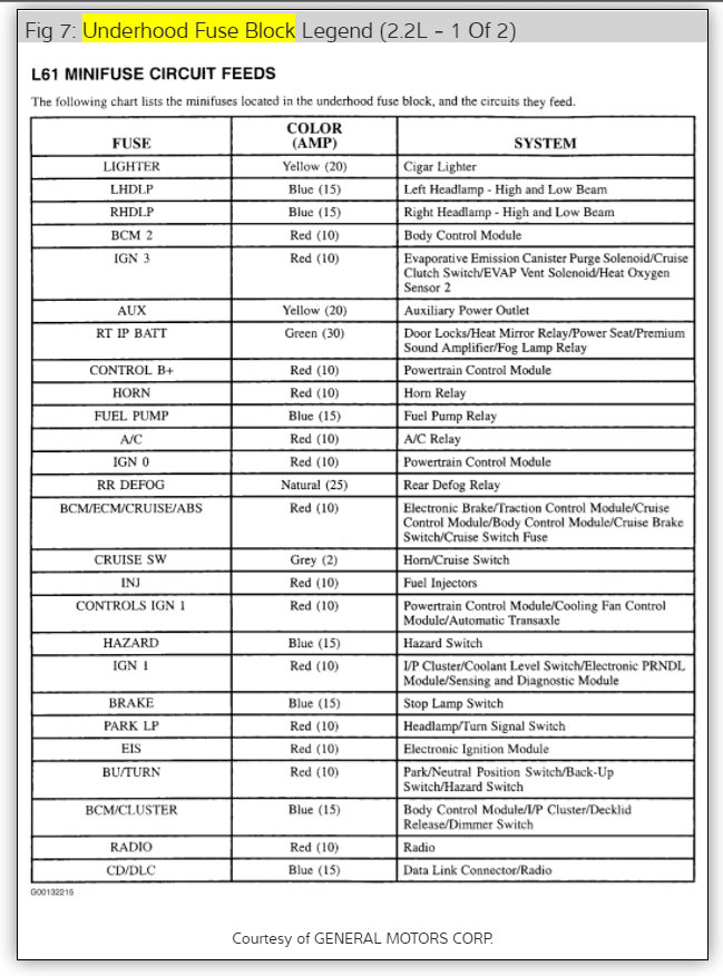

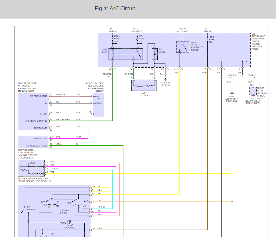

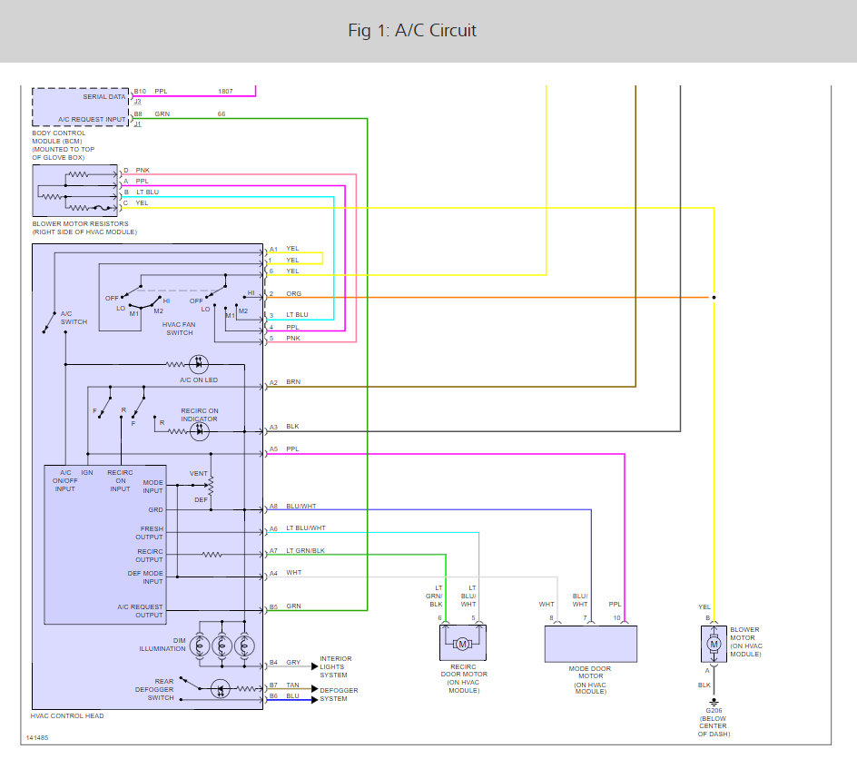

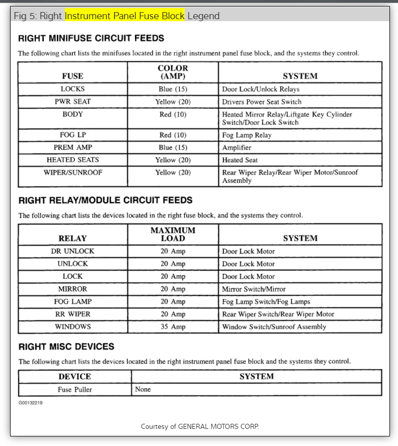

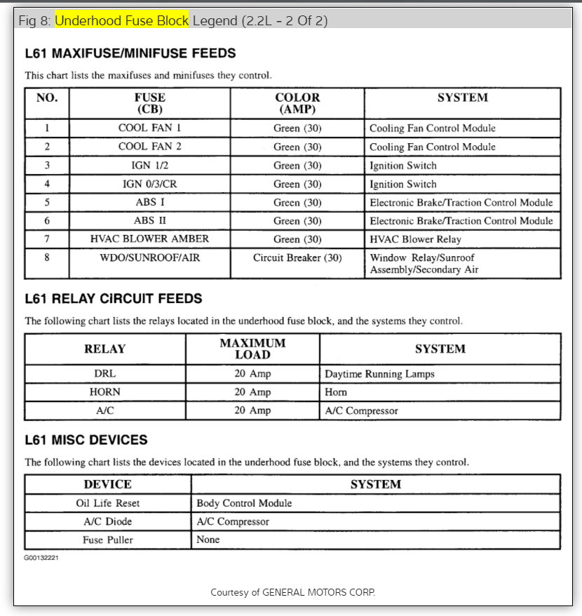

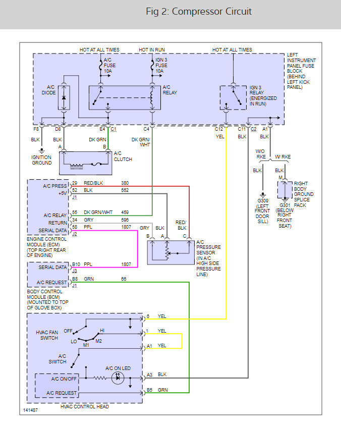

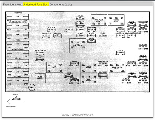

There is some fuses and a ac relay that needs to be checked. Here are some guides and diagrams (Below) to help you run some simple tests.
and
Check for power at the fuses as well. (below)
Nov 6, 2017 at 1:37 PM

Fuses and relays are ok 100psi in ac system. Does the FCM tie in with the ac control?

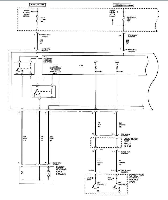

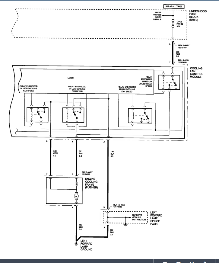

@MIKEPAVEY8
I am attaching the wiring diagrams for the fans. If you can jump power to the and they work then they are not being commanded on. This is either a sensor issue or a control module issue. Clearly both fans are run by the cooling fan control module but they are commanded on by the PCM. So we need to check power coming out of the control module to each fan. If we don't have power then check coming out of the PCM to the fan control module and if you have power there, replace the cooling control module.

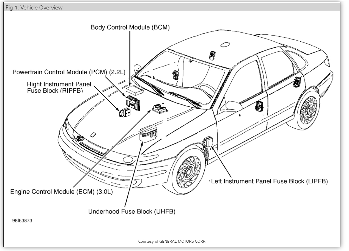

Jul 11, 2020 at 2:24 PM
Sure can. Just to confirm this vehicle is a 2001 L200 with the 2.2L? Looks like our post got merged into another one that was similar so I just want to make sure it is the same exact vehicle but here is the location for that one.
