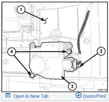

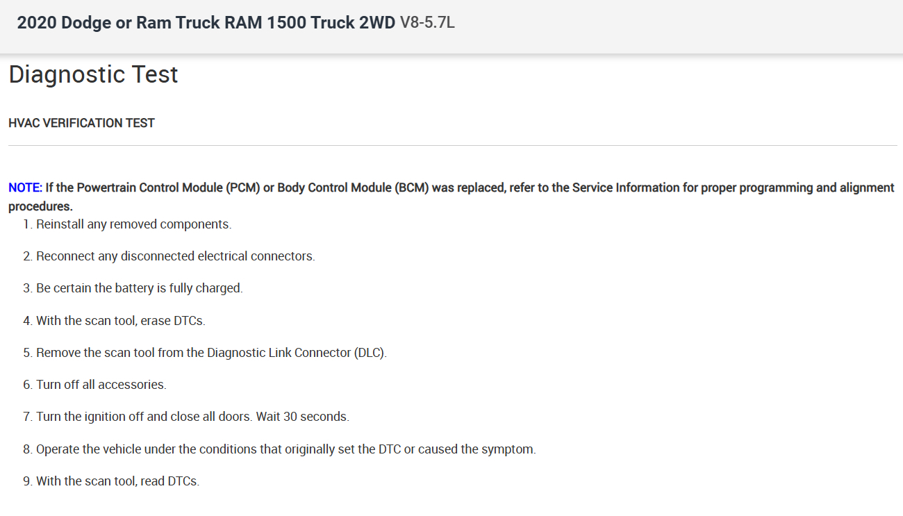

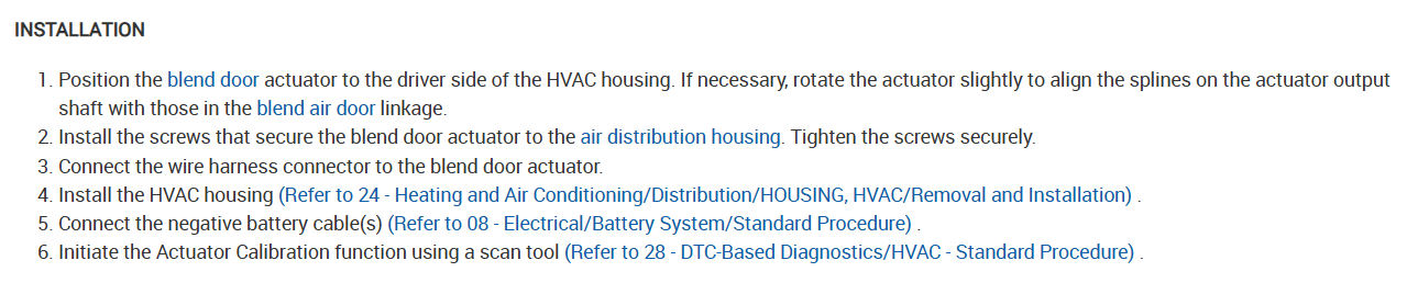

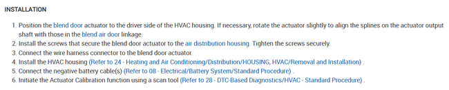

It sounds like the orientation of the blend door drive is not timed correctly or the actuator is defective. Also, it says to Initiate the Actuator Calibration function using a scan tool, did you do this? Check out the images (below). Please let us know what happens.

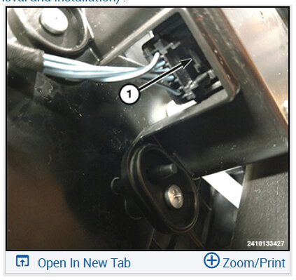

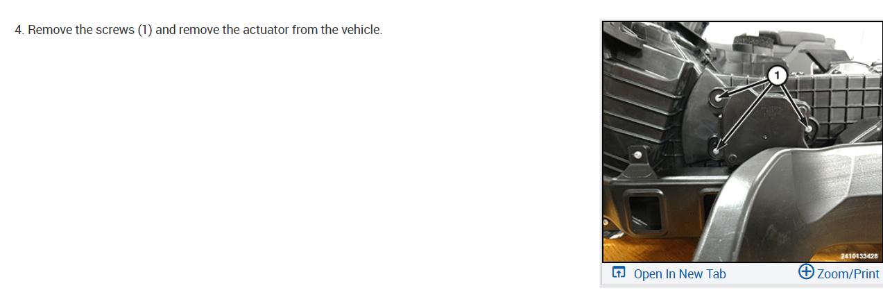

Okay, let's remove the actuator and work the blend door pivot by hand when the system is on low to see if you can actuate the door by hand. This guide will show you what I am talking about:

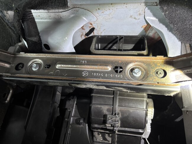

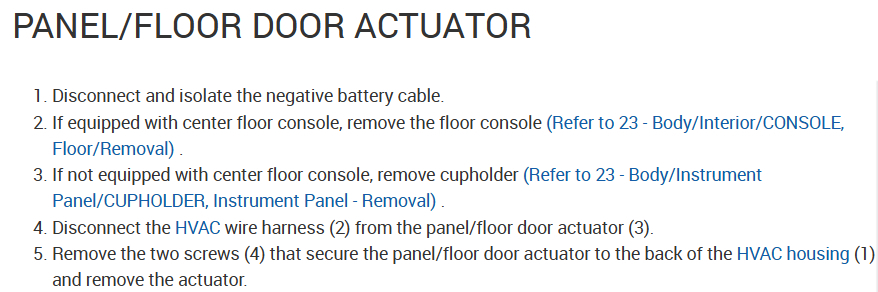

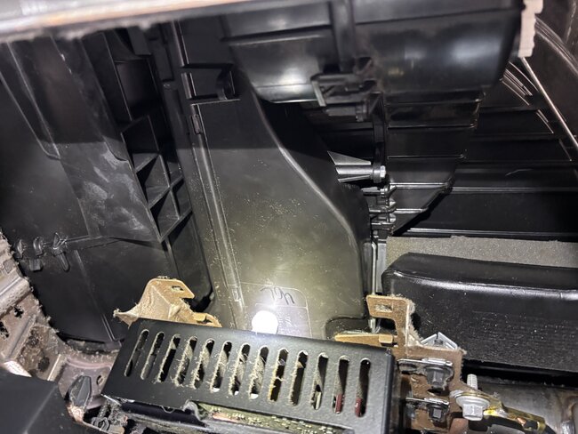

I have the center console removed but not seeing the actuator. Can you give more clarity to where it is?
Dec 24, 2024 at 6:22 AM

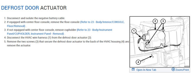

Sure, it looks like it is down low in the middle of the heater plenum. Check out the images (below). Let us know how it goes.

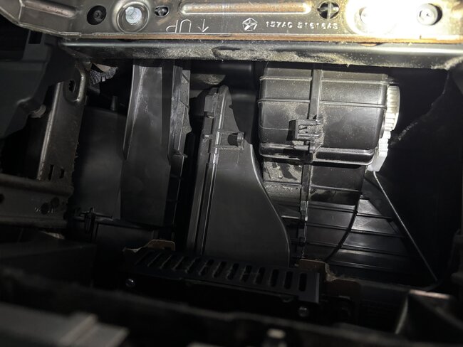

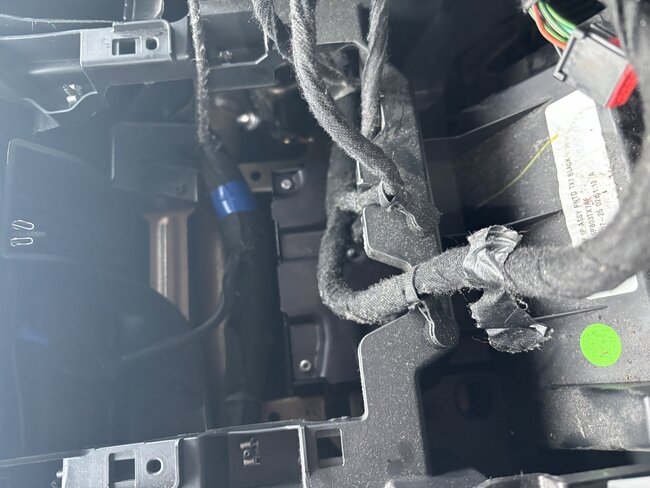

It might be under the plenum. Can you upload some images of what you are seeing?
Dec 25, 2024 at 10:20 AM
SSHAFFER92
  • 22 POSTS
This is behind the center console and radio.

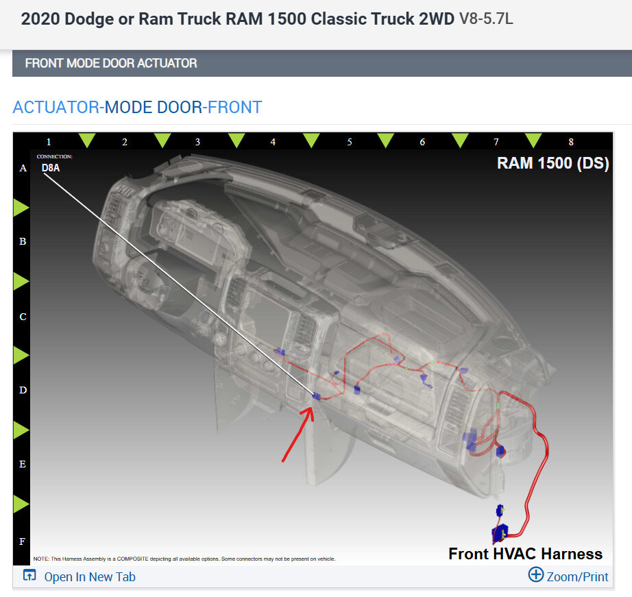

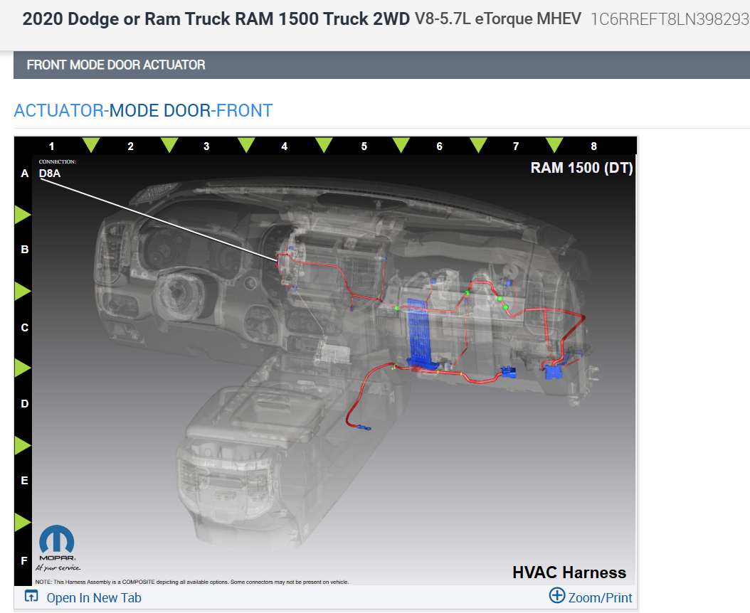

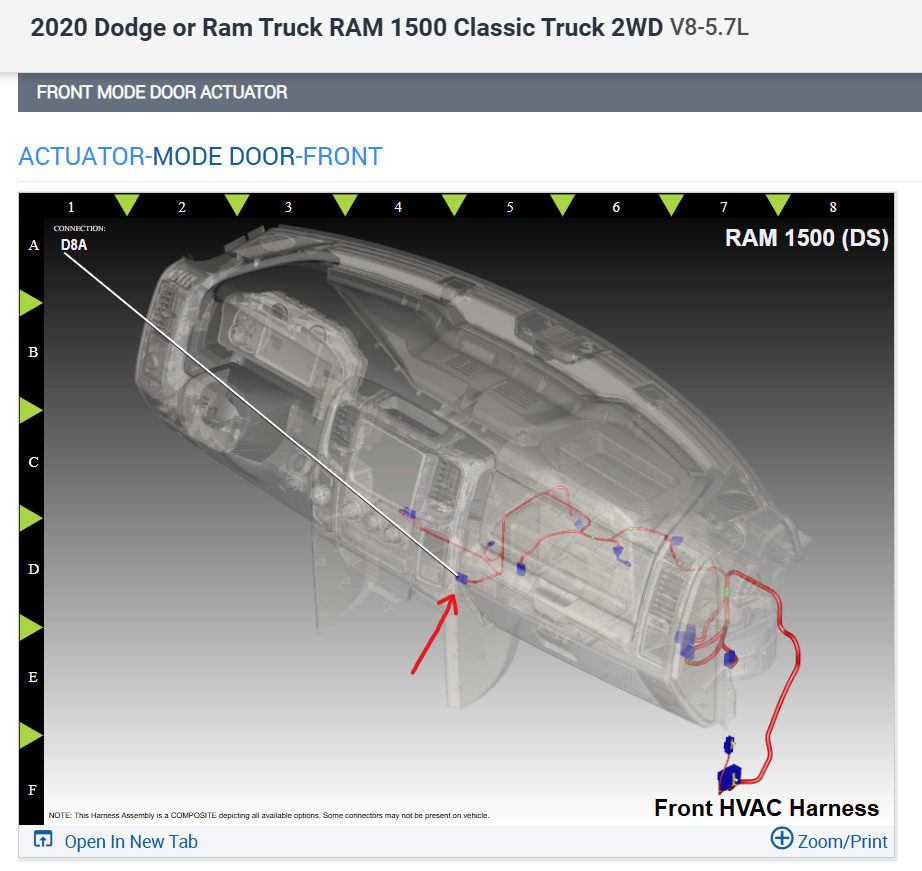

Hmm, I don't see it either, does this truck have dual zone climate controls? It might be further under the HVAC plenum, this is all they show for the location.

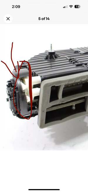

I found the mode door actuator it was the one by the steering column. I realized it was working properly, but the gear plate it is on is out of alignment. Do you have an image of it in alignment?
Jan 3, 2025 at 5:43 AM

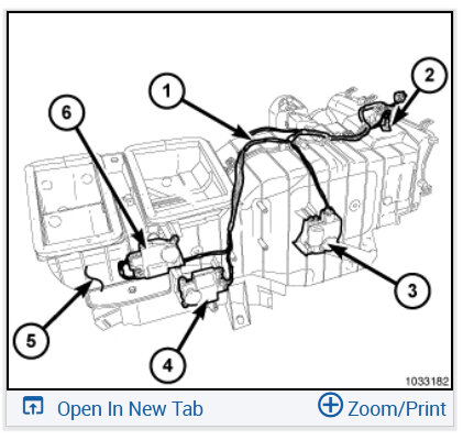

Nice work, I found it as well, it is called the mode actuator 2. I don't see the gear you are talking about though. This shows all of the actuators.
Jan 3, 2025 at 11:55 AM
SSHAFFER92
  • 22 POSTS
Right behind the actuator it has a cover then instead is a plate with slots in it that align to move the doors. I can’t get the alignment right for some reason.

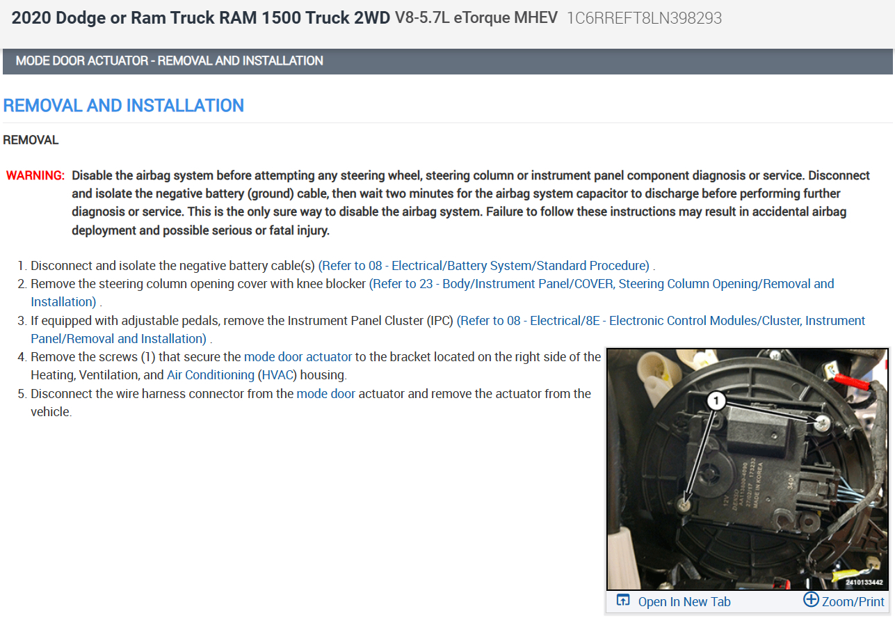

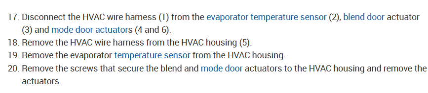

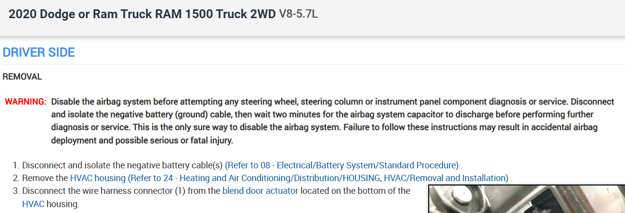

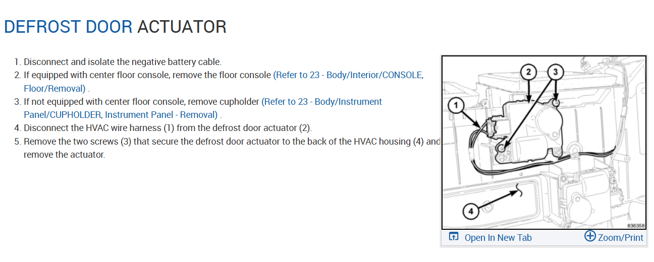

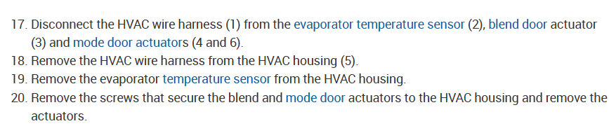

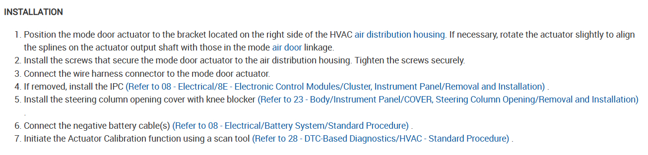

I see the truck is a hybrid. Here are the instructions for the blend door and the linkage, this should help. Check out the images (below). Please let us know what happens.
Jan 5, 2025 at 12:28 PM
