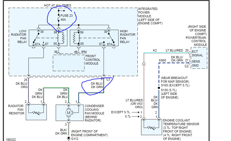

Could this cause engine temperature to ride as well as warm air instead of cold?
Aug 16, 2019 at 2:29 PM
CERTIFIED EXPERT
52,796 POSTS
Good morning,
If the A/C fan is not working, the A/C inside temperature would be warm at idle and cool off while driving.
If the engine is running hot, the A/C system will not perform correctly either.
Image (Click to enlarge)
