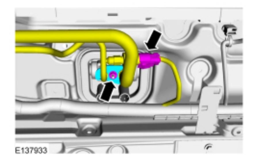

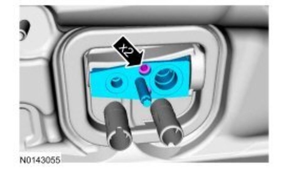

Okay, most likely it is the expansion valve that could be the issue.
Do you have gauges t give me the high and low side readings for the A/C system? This cannot be cleaned, only replaced.
Did you replace the dryer when you did the compressor? That is required.
I would really like to see the gauge readings before assuming anything.
