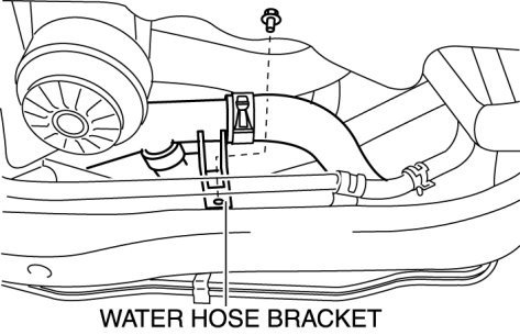

5. Remove the water hose bracket.
pic 1
CAUTION:
- If moisture or foreign material enters the refrigeration cycle, cooling ability will be lowered and abnormal noise or other malfunction could occur. Always plug open fittings immediately after removing any refrigeration cycle parts.

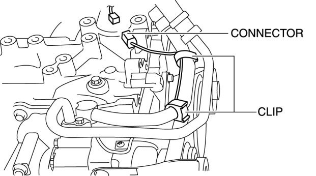

6. Remove the clip.
pic 2
7. Disconnect the connector.

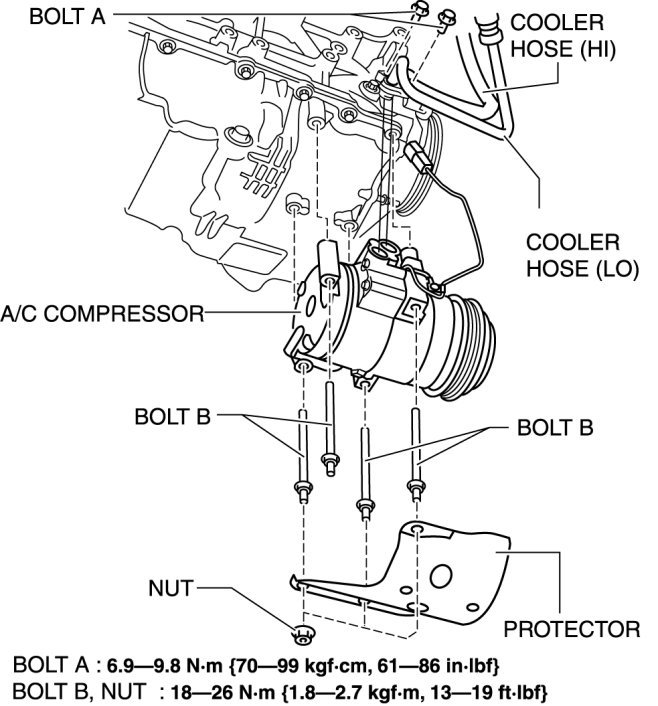

8. Remove the bolt A.
L5, L3 WITH TC
pic 3
LF
pic 4

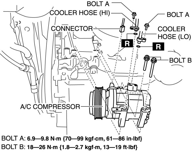

9. Remove the cooler hose (LO). See: Hose/Line HVAC > Removal and Replacement
10. Remove the cooler hose (HI). See: Hose/Line HVAC > Removal and Replacement
11. Remove the bolt B.
12. Remove the A/C compressor. Do not allow compressor oil to spill.
13. Install in the reverse order of removal.

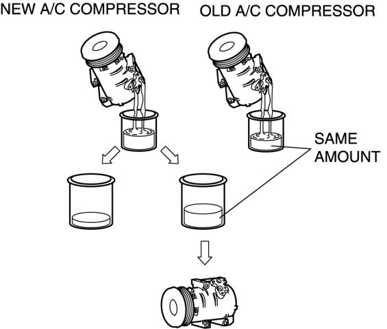

- Due to the high moisture-absorption characteristics of the compressor oil, it may absorb moisture if left over a long period of time thereby negatively affecting A/C operation. Drain the compressor oil and refill within 10 min. of each other.
1. Rotate new A/C compressor shaft six to eight revolutions while collecting refrigerant oil in a clean measuring device. Use this refrigerant oil to refill new compressor. Do not allow refrigerant oil to become contaminated.
2. Rotate old A/C compressor shaft six to eight revolutions while collecting refrigerant oil in a separate, clean measuring device.
3. Compare those oil amounts. The amount of the oil drained from the new A/C compressor should be greater than the old one.
4. Pour the same amount oil of drained from the old A/C compressor back into the new A/C compressor.
