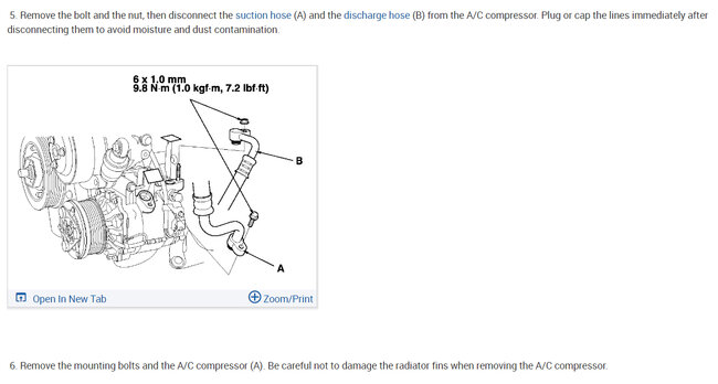

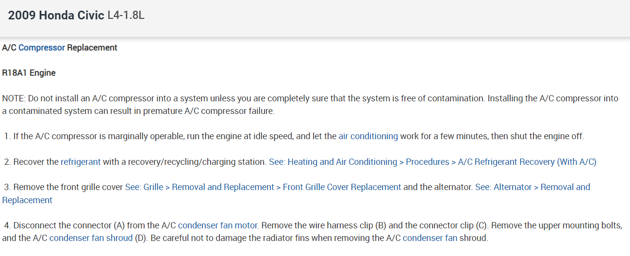

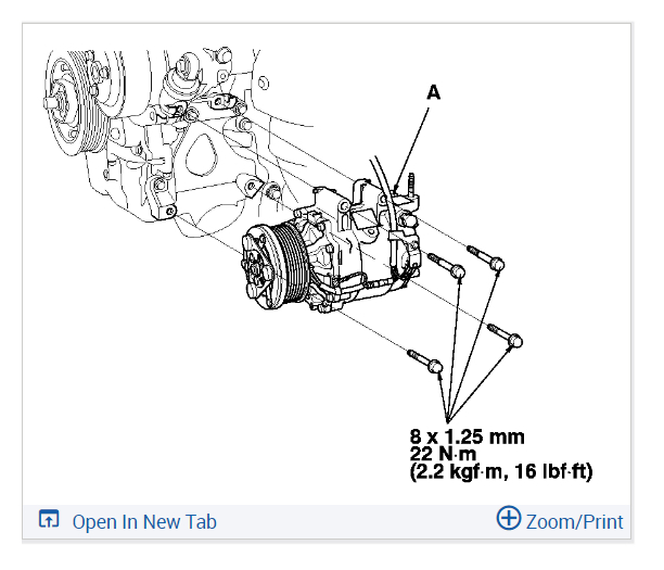

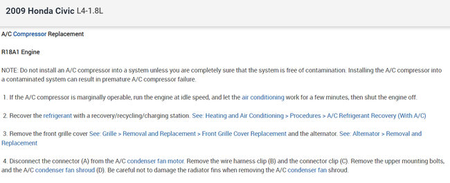

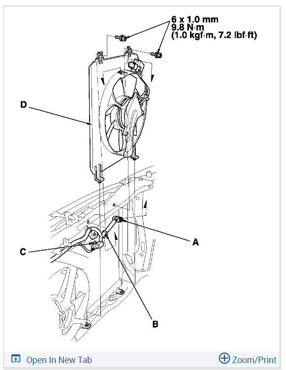

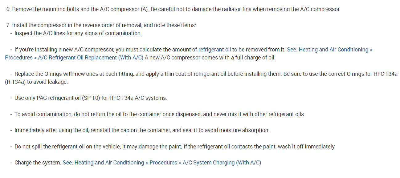

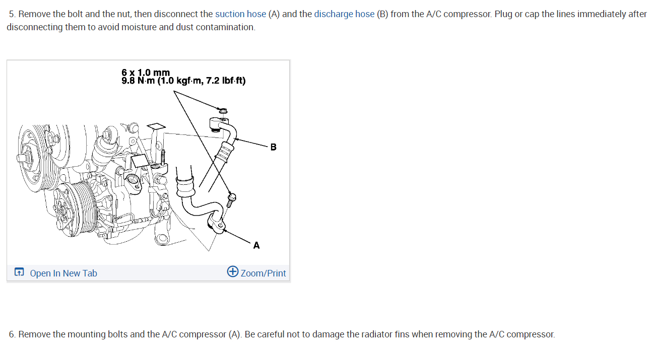

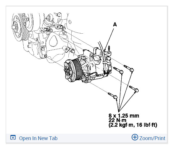

This guide can help as well, and I have included how to change the compressor out in the images below.
https://www.2carpros.com/articles/replace-air-conditioner-compressor
