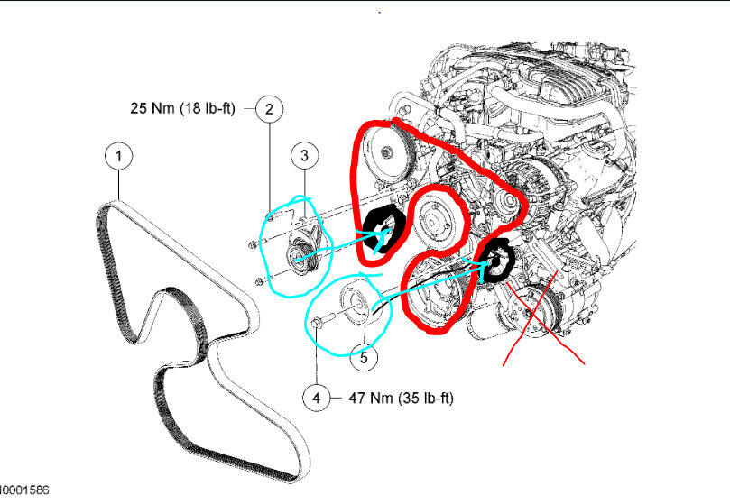

So, from what I can tell, there isn't an AC bypass pulley available. So, either the compressor needs replaced or you can try to bypass the AC pulley using a shorter belt. If I recall, I was able to fit a 72" belt on one for a customer years ago.
I attached a pic below showing how I feel the belt would run bypassing the compressor. Let me know if this helps.
See pic below.
