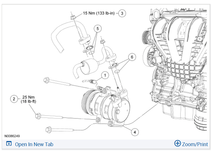

Yep, I agree with MECHTRIX, the A/C compressor will need to be replaced.
Here is a guide and video to help you through the steps:
https://www.2carpros.com/articles/replace-air-conditioner-compressor
And this video will show you how to vacuum down and recharge the system:
https://www.youtube.com/watch?v=4EqdrBVb0sY
Check out the images (below). Let us know how it goes.
