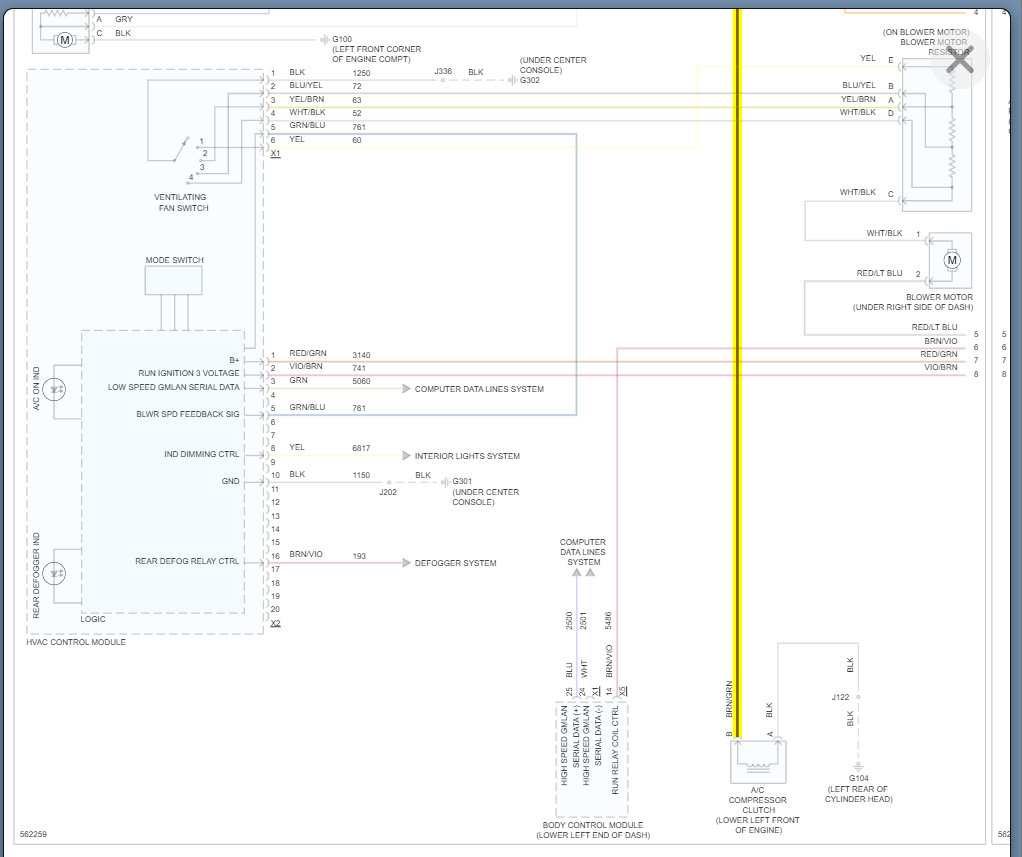

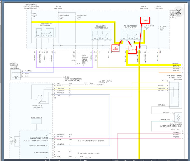

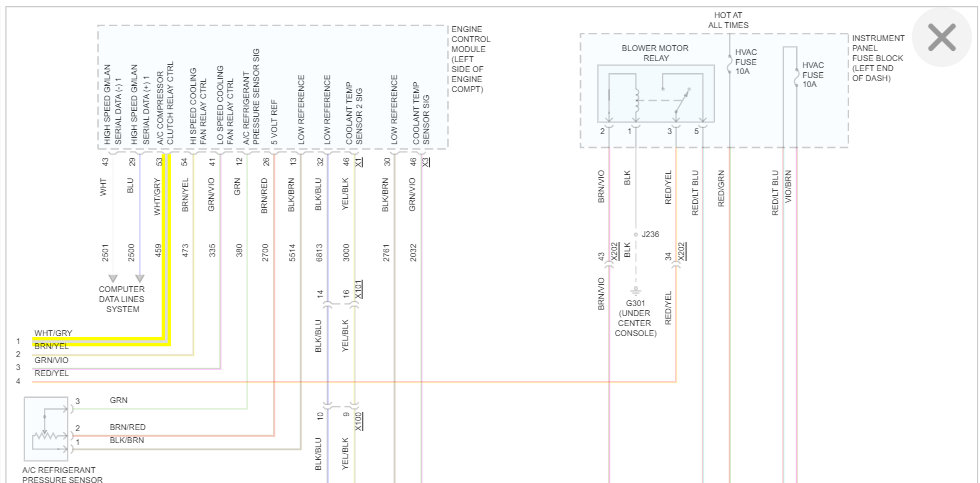

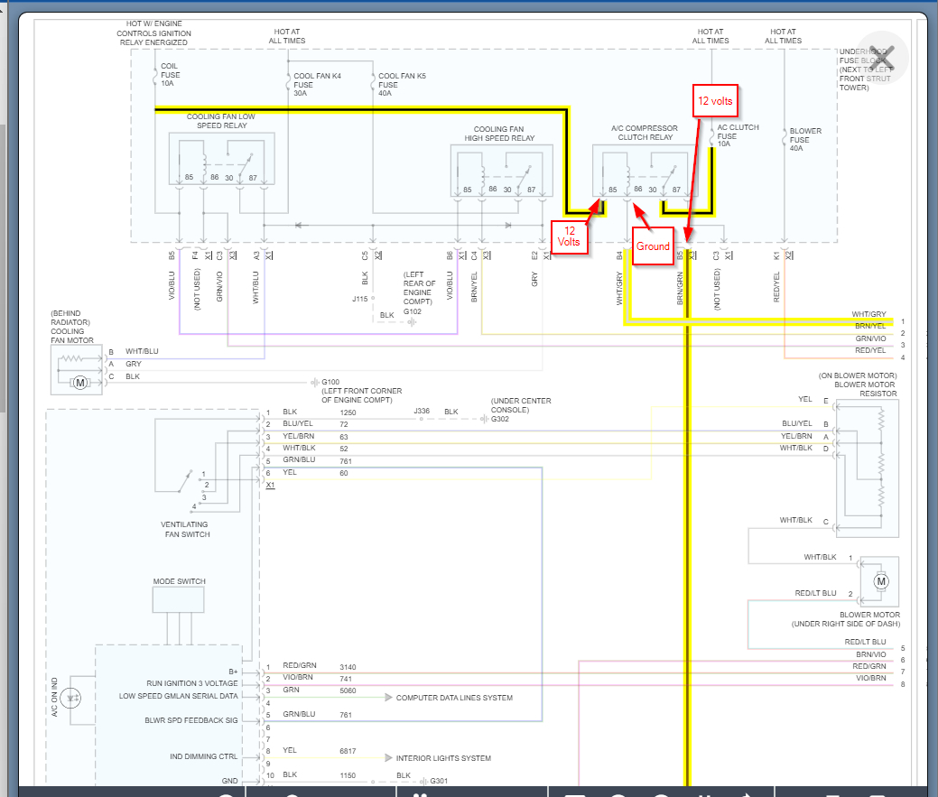

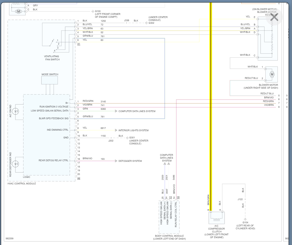

A/C compressor not turning on. Bypassed the relay for the clutch and the clutch activated. Turned on while bypassing the relay and clutch activated but no cold air. Freon level was good as well. Changed the compressor, clutch relay and pressure sensor switch and checked all the fused related and all were good but still not turning on. Would the ground be the next thing to check or is there another reason it wouldn’t be turning on? Vacuum was created, and Freon refilled after compressor change.
