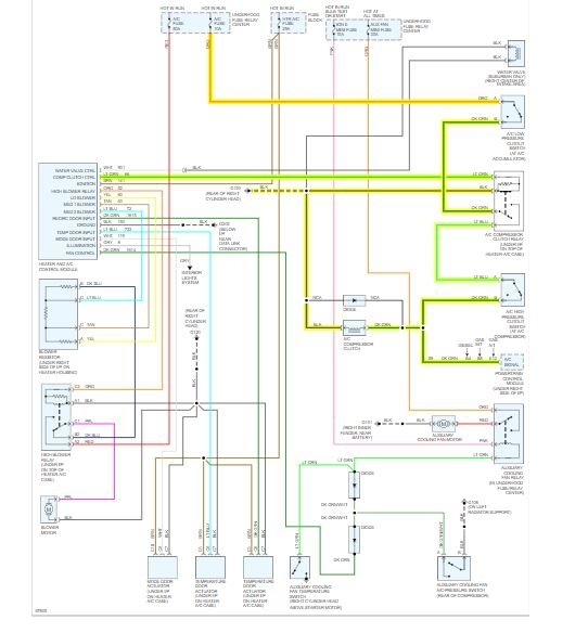

Do you mean the compressor clutch comes on when commanded on?
https://www.2carpros.com/articles/car-air-conditioner-not-working-or-is-weak
If it does, what are the high and low side pressures?
What work was done on the system?

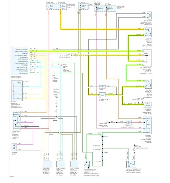

I attached a diagram for you to make sure you have power to the compressor.
