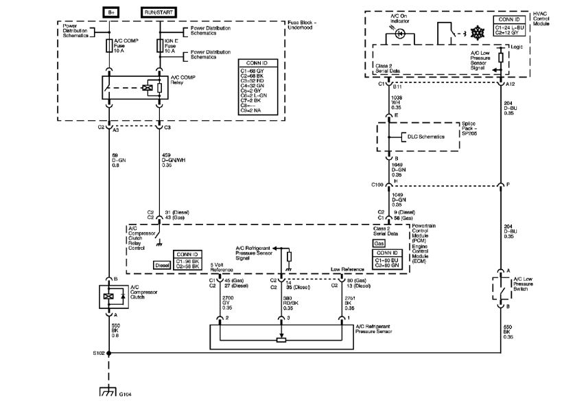

If you look at the diagram, there are two fuses that need to be checked for power on both sides.
May 24, 2018 at 12:50 PM
EQUILIZER
  • 7 POSTS
Okay the IGN-E fuse is good and so is the A/C COMP fuse, but on the compressor relay 87 and 85 are not lighting up.
May 24, 2018 at 3:27 PM
Need power to 30.
Did you verify power across the fuses? Use a test light or voltmeter.
May 24, 2018 at 3:54 PM
EQUILIZER
  • 7 POSTS
I tested the fuses and they lit up. What do you mean by across?
May 24, 2018 at 4:02 PM
Check both sides of the fuse. Need to verify power through the fuse.
If there is power on both sides, then you have a wiring issue between the fuse block and the relay. the powers for the relay come from the fuse box.
May 24, 2018 at 4:04 PM
EQUILIZER
  • 7 POSTS
On those two fuses I tested both sides turned on.
May 24, 2018 at 4:08 PM
Okay, if you have no powers to the relay, then the wiring is open between the fuse box and the relay.
You will need to inspect the harness for any damage or burning.

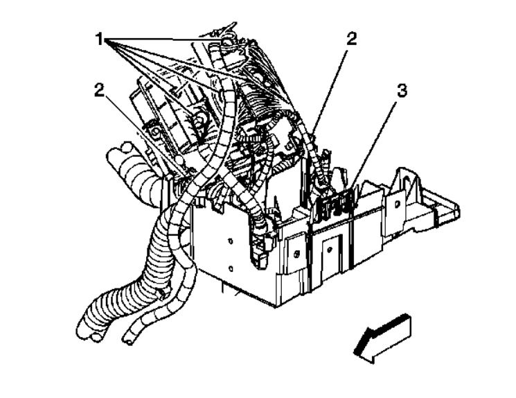

How do you take off the fuse box?
May 24, 2018 at 4:17 PM
Procedure below and picture attached.
REMOVAL PROCEDURE
1. Disconnect the negative battery cable.
imageZoom/Print
2. Remove the left fender upper brace.
imageZoom/Print
3. Remove the electrical center brace cover assemble by lifting the cover (3) outwards to clear the tabs.
4. Remove all fuses and relays.
imageZoom/Print
5. Push on the tab (3) so that the electrical center can be rotated on the studs located at (2).
6. Remove all connectors by removing the bolt (1) for each connector.
7. Disconnect all connectors from the electrical center block.
imageZoom/Print
8. Push on the tabs (2) in order to lift the electrical center (1) out of the housing.
imageZoom/Print
9. To replace the engine electrical center bracket remove the 4 retaining bolts (1).
10. Remove the engine electrical center bracket assembly from the fender.
