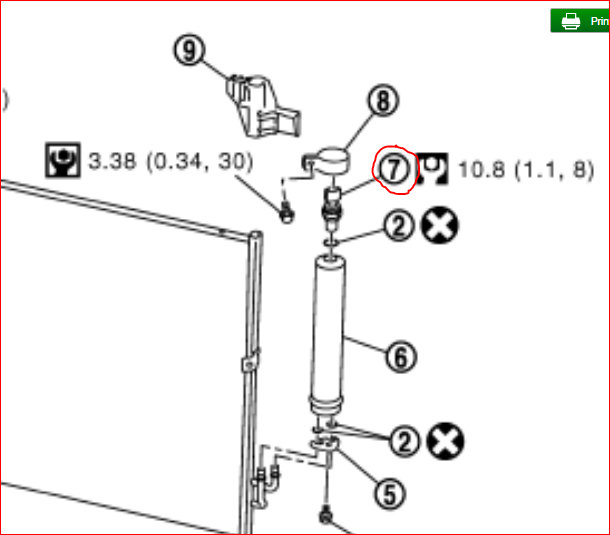

I've attached below a picture of the pressure sensor and its location.It's located in the condenser.When recharging the A/C system be sure the controls are on max A/C and the blower speed on its highest setting. Sometimes when a system is really low it takes time for the refrigerant to enter.Here is a tutorial for you to view:

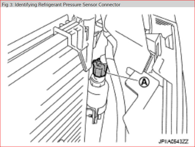

Thanks. if the sensor is bad do you think this is the reason the compressor clutch is not engaging or it has nothing to do with it? I'm guessing to get to the sensor I have to move the front bumper or is a way to get to the sensor without removing the front bumper?

Yes, it's possible the A/C compressor will not cycle if the sensor is bad. No, you don't have to remove the bumper to gain access.It's accessible behind the grille on the left (driver side) attached to the condenser itself.See attached picture below.Hope this helps and thanks again for using 2CarPros.
