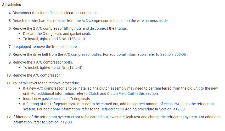

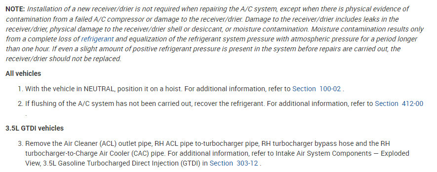

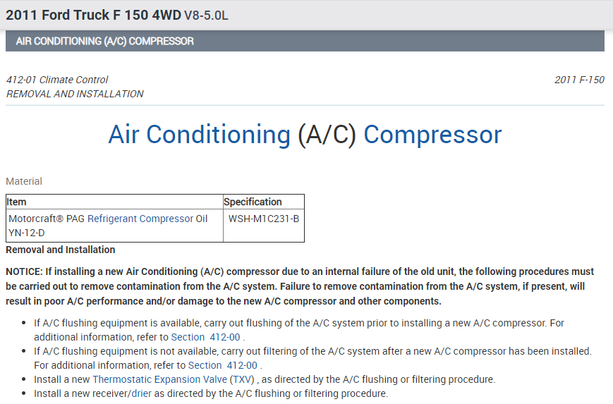

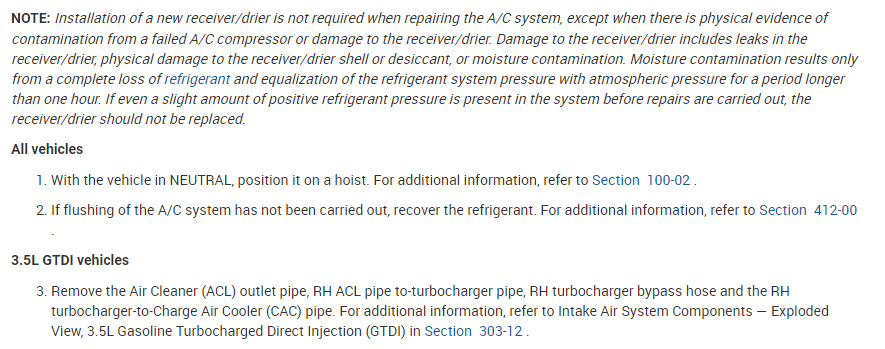

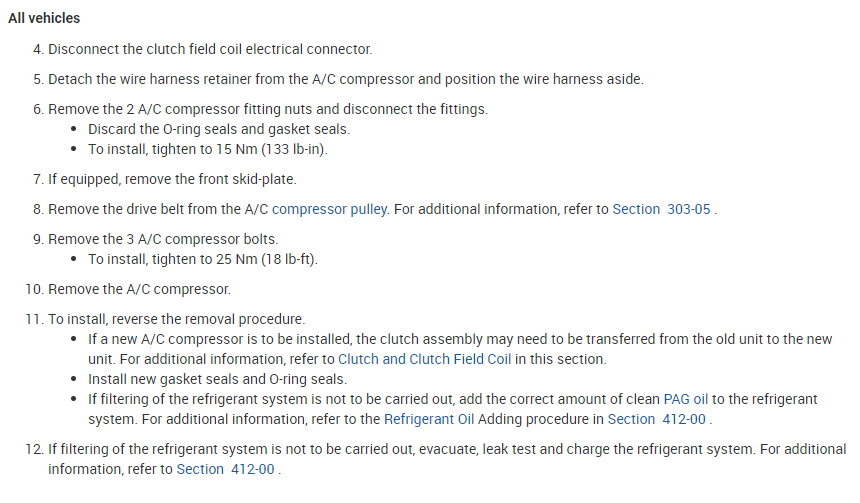

Hello, I'm Danny.
Here is the information you requested, Yes, It's possible and we're here to help. After removing and replacing the ac compressor you will need to vacuum the system and recharge as well. Here are tutorials showing how to replace the compressor and vacuum-recharge the system:
