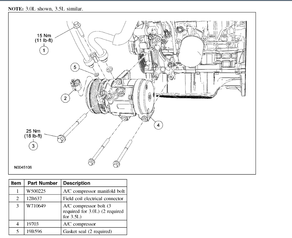

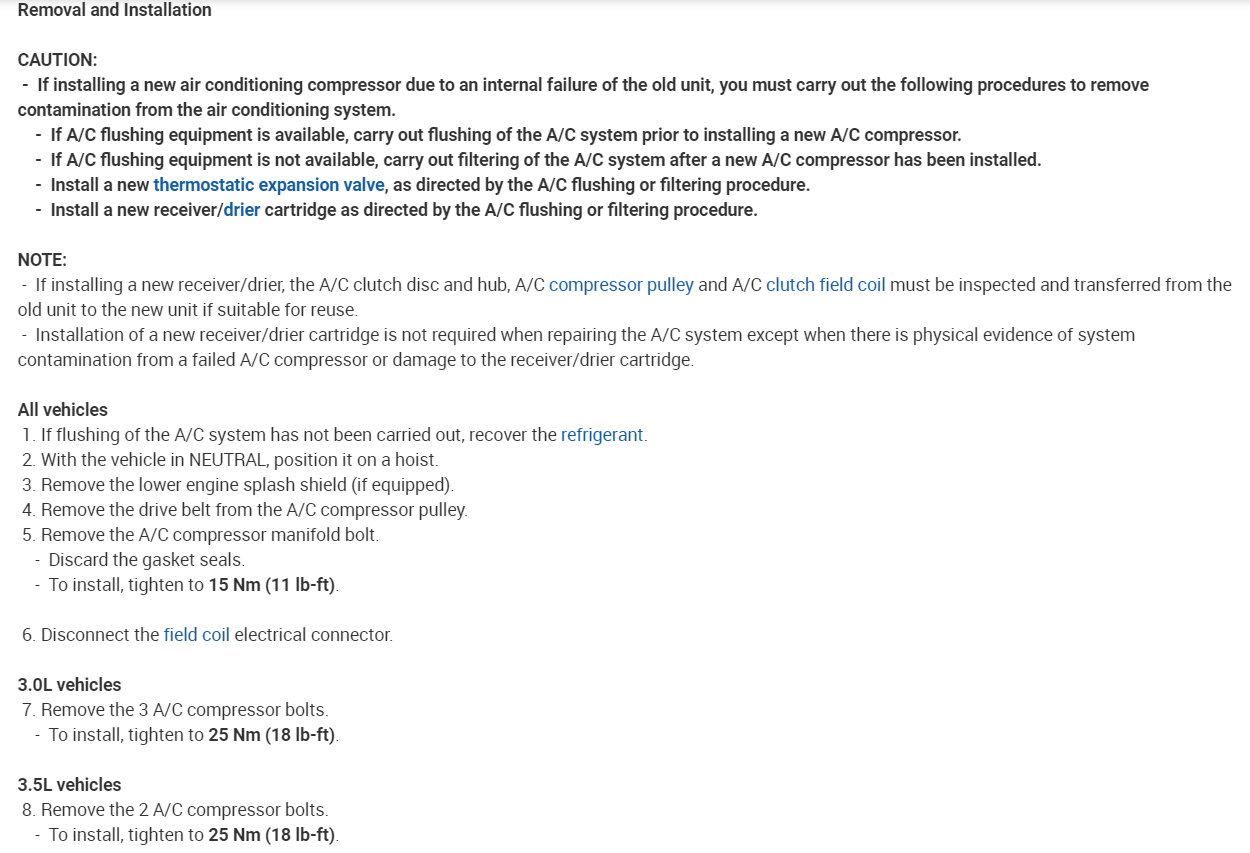

Hello, my next project is my A/C compressor for my vehicle listed above. any diagram or guides to help me change out that part.
Jul 21, 2023 at 9:50 AM

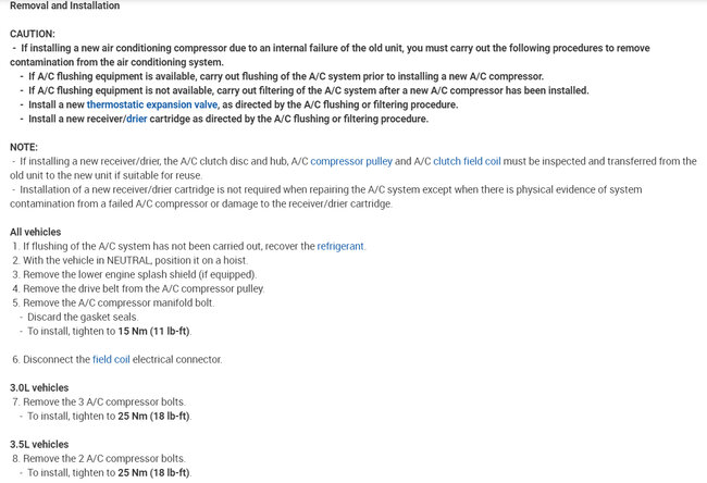

Yep, here is a generic guide to help you step by step with instructions in the diagrams below to show you how on your car:
https://www.2carpros.com/articles/replace-air-conditioner-compressor
Please go over this video as well:
https://youtu.be/4EqdrBVb0sY
Check out the images (below). Please let us know if you need anything else to get the problem fixed.

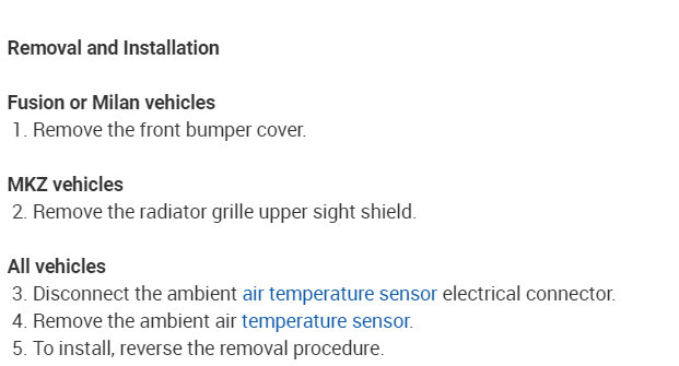

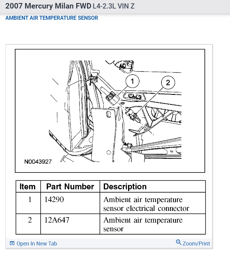

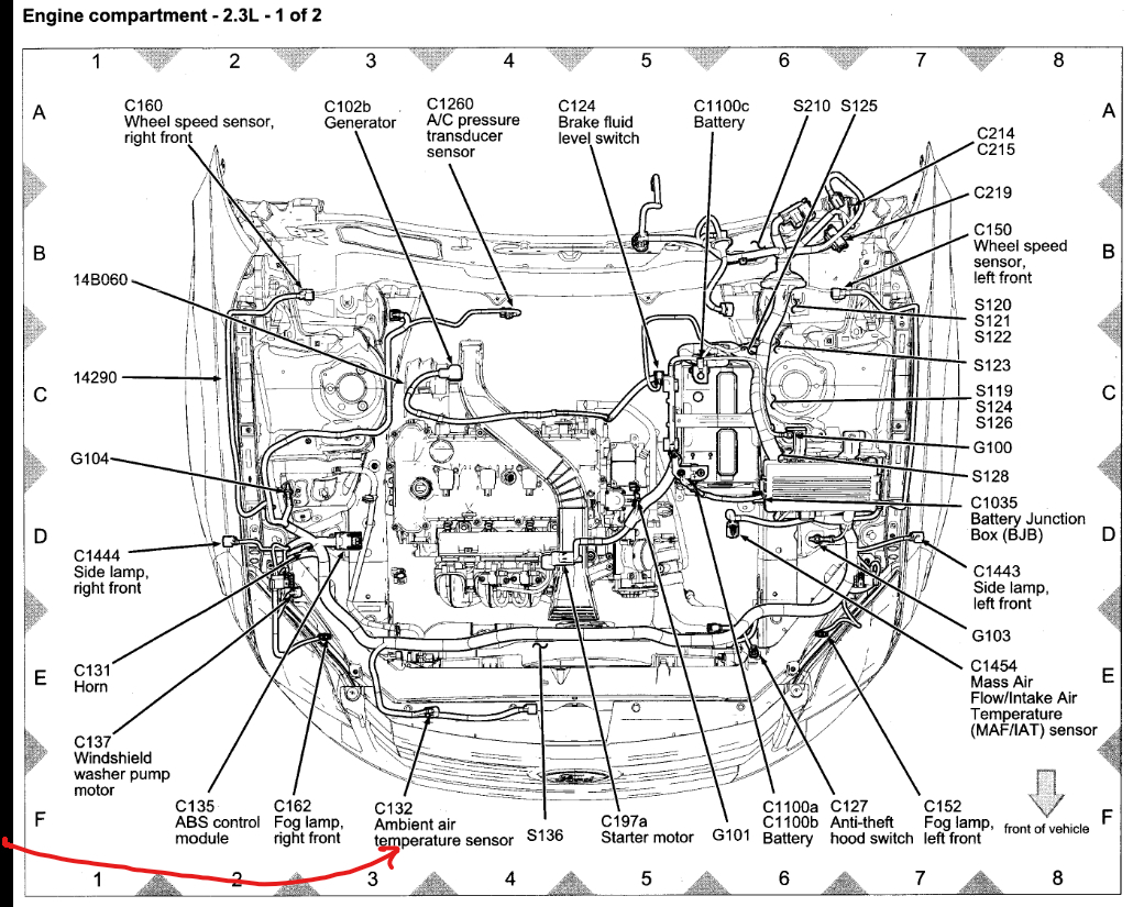

So, my wife called me and said that the A/C is now blowing hot air so I'm like okay. We just replace the A/C compressor like what now so once she arrived home i hook up my scan tool and i be darn its the nightmare trouble code P0537.
Aug 5, 2023 at 2:14 PM
The P0537 trouble code in a 2007 Mercury Milan refers to an issue with the Ambient Air Temperature Sensor Circuit. Here is the location of the sensor so you can change it out. Check out the images (below). Please let us know what happens.

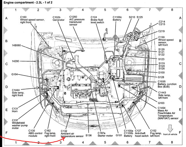

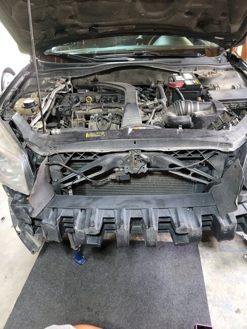

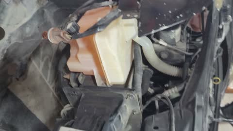

I am having trouble locating the ambient temperature sensor.
Aug 13, 2023 at 9:44 AM
LIONELL8732
  • 148 POSTS
Help.
Aug 13, 2023 at 1:16 PM
Thanks for the video, sorry for the trouble, they can hide the sensor sometimes. It shows the sensor near where you have the wiring harness going to the SRS impact sensor. Check out the images (below). Please let us know how it goes.
