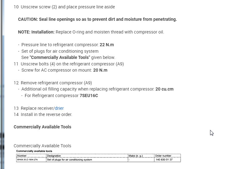

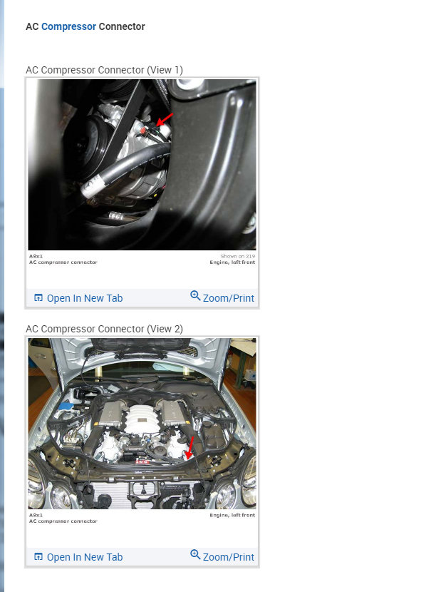

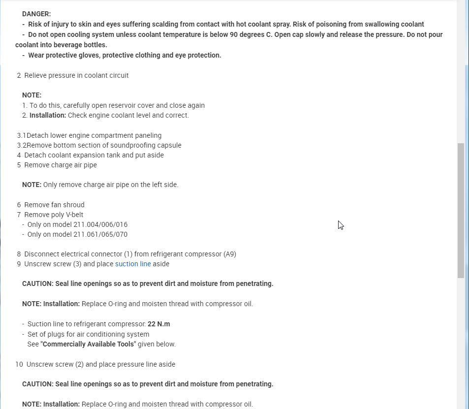

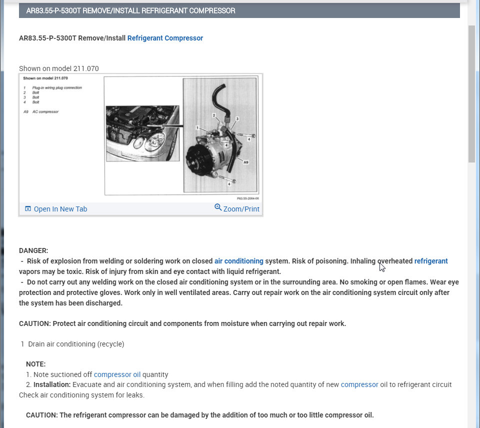

I attached the info from the manual on how to replace the compressor. Also, here is a guide that will help in more general terms.
As for the other components, can you tell us what specific components you are thinking about?
https://www.2carpros.com/articles/replace-air-conditioner-compressor
