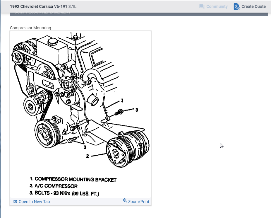

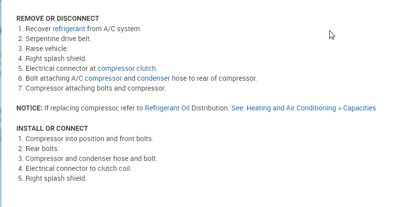

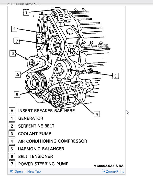

I want to remove the A/C compressor on my car. it is very loose and has caused the belt to come off. how long should this take and could the compressor fall off while driving ? I do not want it replaced.
