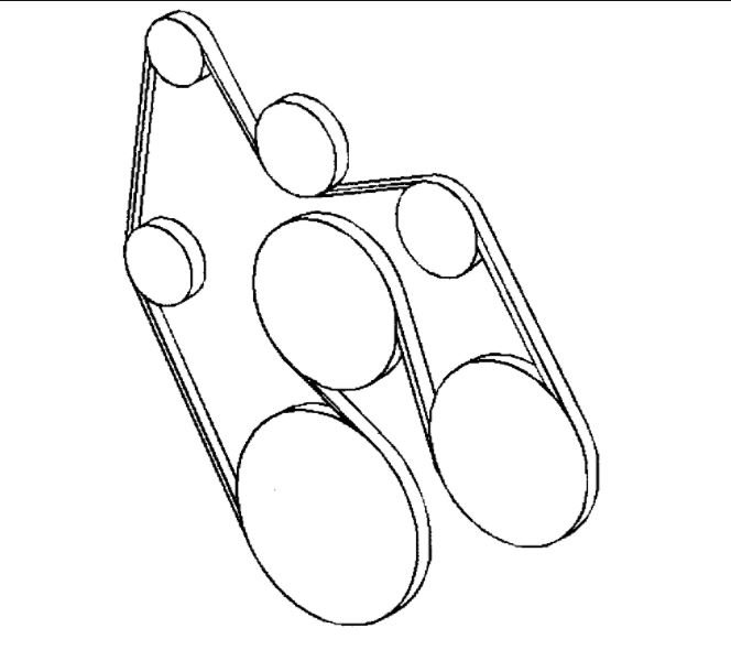

Yes, A/C was an option and they offered a belt for no A/C.
You will need to go to a parts store and get the belt for no A/C.
I attached the diagram routing for you without the compressor.

Okay. I don't have that pulley that would bypass it.

You do not need a pulley in its place.
The belt just does not go around the compressor. You leave the compressor in place.

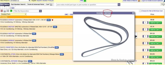

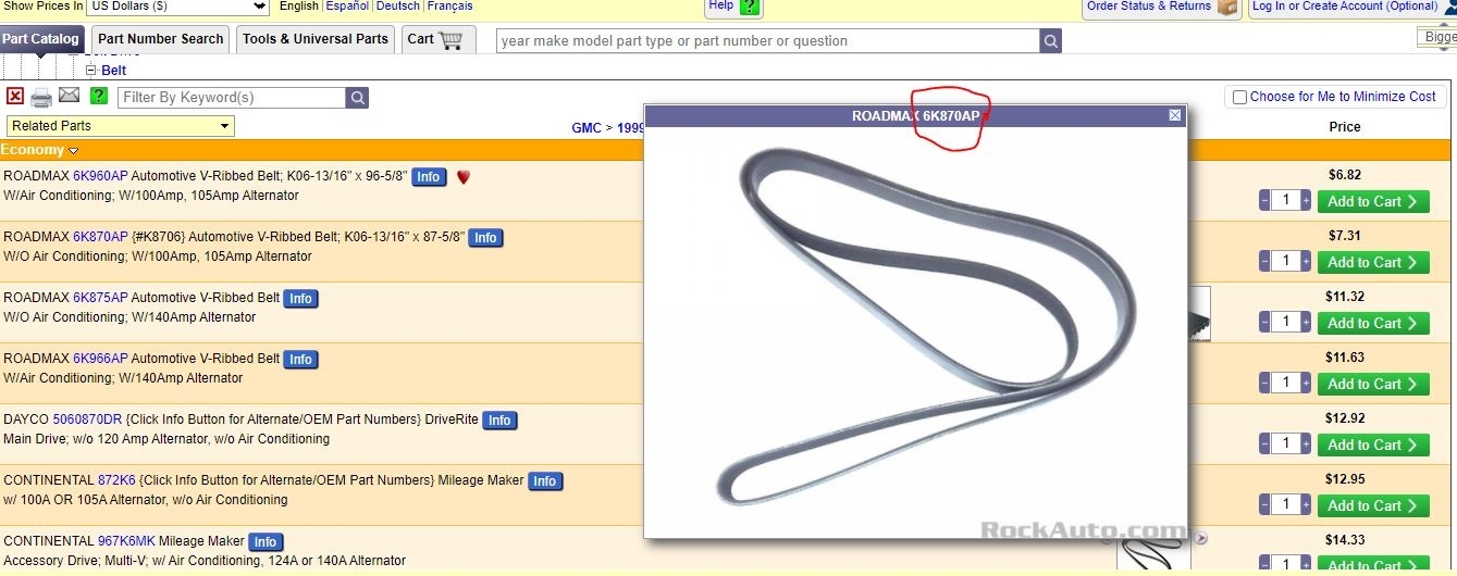

I just attached the belt number for you. Go to a parts store and tell them that is the belt number you need.

Okay. I tried that belt and it's loose because it doesn't have the bypass pulley installed. Would pulling the A/C relay work?
