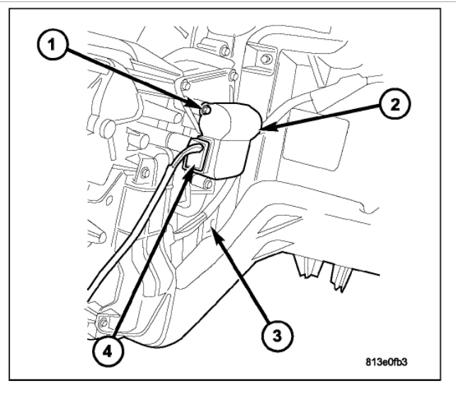

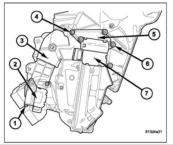

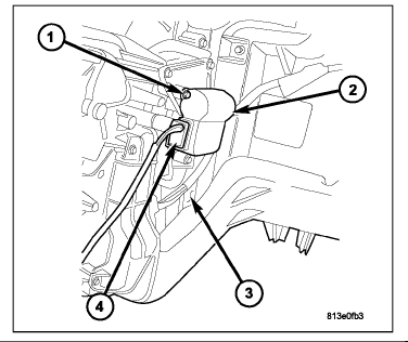

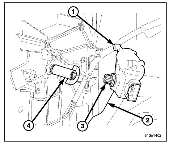

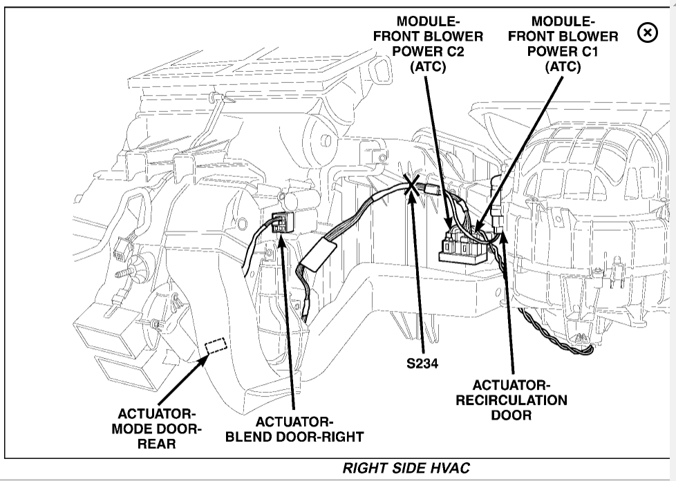

It sounds like the right side blend door actuator has gone out and needs to be replaced. Here is a guide to help you see what you are in for when doing the job with the locations of the blend door actuators for you car below:
Jun 20, 2018 at 11:28 AM

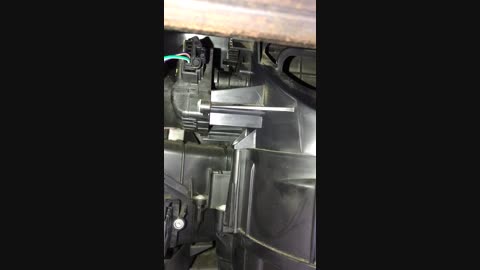

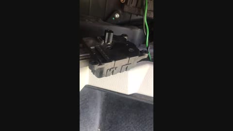

Okay guys. I got a video of what is going on. So I went under the glove box and it seems that the actuator works because the gear is turning. But the top gear is not. If you look closely the gear on the actuator (the one turning) looks like it is broken on the end. Now I am not sure because I really do not know what it is suppose to look like. Any ideas guys? Might it just be the gear that needs to be replaced or the actuator completely?

That is the right side actuator. It works fine. The blend door also turns. I have hit a wall my only other idea would be low on Freon?

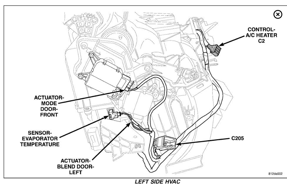

Which actuator is the one you took the video of on the right side? There are two. The lower one is for the mode door (sends air to the floor/dash/vents) The upper one is the blend door and controls hot/cold. The mode unit has the gear like is in your picture while the upper one should be mounted to a steel bracket above the area that the heater core resides.
Both sides use the same evaporator core for the AC so if you have good cold air on one side you would get the same air on the other if the blend door was working.

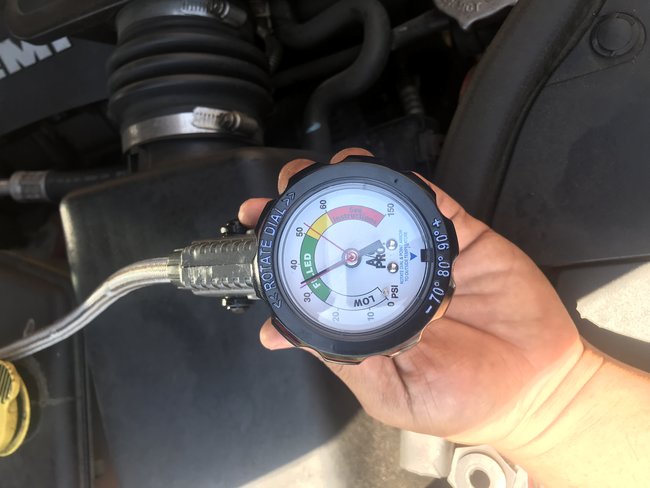

I did a reading on the AC pressure and got this. Would this be enough not to send cold to the passenger side?
Jun 21, 2018 at 10:22 AM
The pressure looks fine, I do not think it is a charge issue. Since the actuators are off can you work the pivot by hand and listen for the air doors inside the plenum opening and closing while effecting the temperature?
