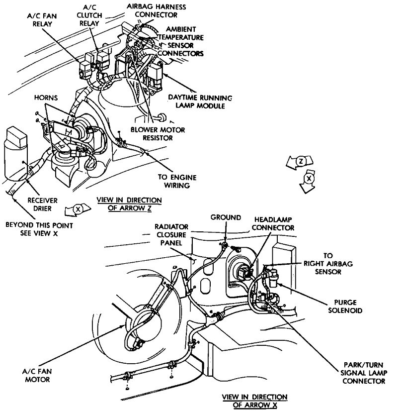

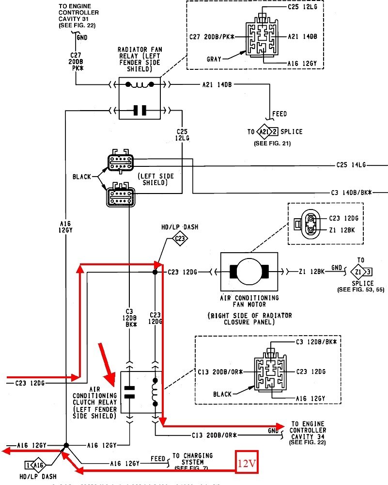

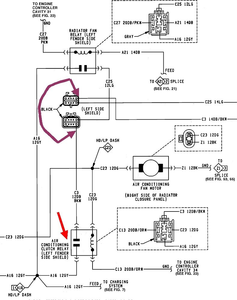

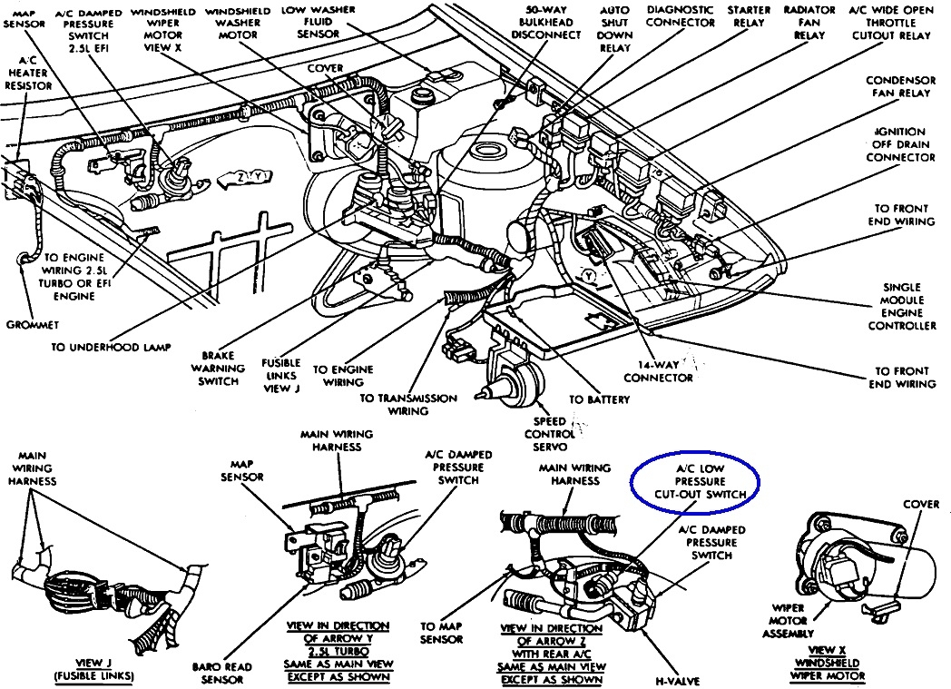

Here's two drawings that show it by the right front strut tower.
Have you checked the system pressures? If the refrigerant has leaked out, as it will over time, the low pressure cutout switch prevents the compressor clutch from engaging. That's done because then it would be possible to pump the low side into a vacuum. If there's a leak, that can draw in outside air along with the extremely harmful humidity with it. Moisture in the system can freeze and block the tiny orifice the refrigerant is controlled with, and it will lead to corroded parts.

Still having the same problem even after I located the correct relay. When I jumper wired that to make the clutch engage, the cooling fan came on. So, I still need help figuring out what to do to get the clutch fan to come on. I've tried the 2 on the passenger side engine compartment and jumping either of them causes the cooling fan to come on. So, please help.

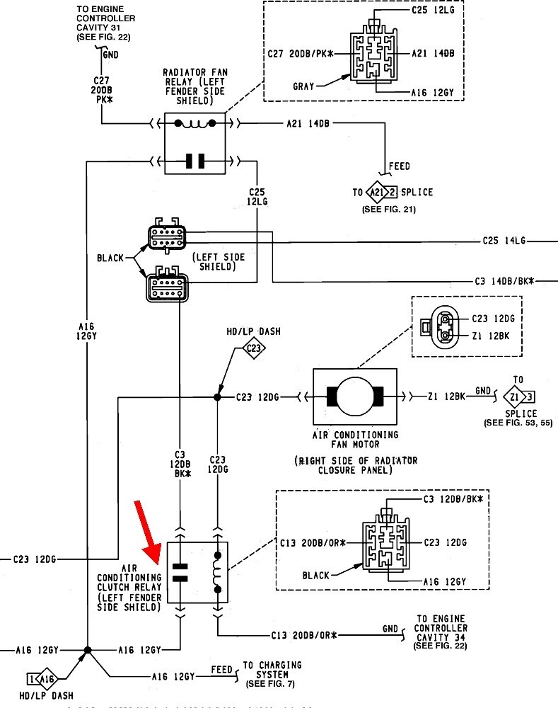

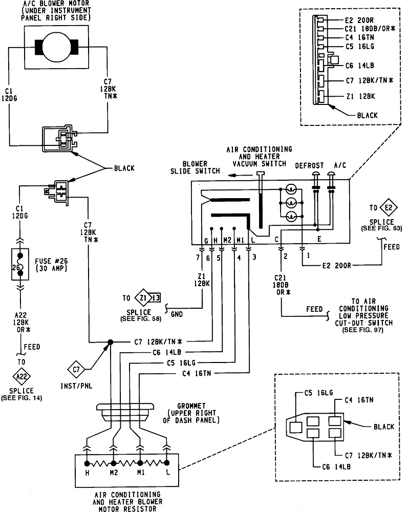

I still don't know if there's any refrigerant in the system. If there is not, or it's real low, the low-pressure cutout switch will prevent the compressor clutch from engaging. A fast way to identify that is to bypass that cutout switch. I'm sorry the diagrams didn't show up in my first reply. I must have forgotten to upload them for you.
These diagrams cover the heating and AC system without a rear heater. The blue arrow in the first diagram is pointing to the switch on the "H-valve" assembly. That's an aluminum block bolted to the center of the firewall, right above the engine, and it has two aluminum pipes attached to it. Look for that two-wire switch. Unplug it, then use a stretched-out paper clip or cotter pin to connect the two terminals in the plug while the engine is running and the AC is selected or the heater is set to "defrost". If the compressor engages, the system is low and must be recharged.
If the clutch doesn't engage, put your fingers on the AC clutch relay and feel if it clicks when you put the jumper in and out. If the relay clicks, we'll have to look at the fuse link wire and rest of the circuit for the clutch coil. If the relay doesn't click, we'll have to look at the control system including the Engine Computer.
Note the second diagram lists the AC clutch relay as being on the left inner fender, but the last drawing shows it over the passenger side strut tower. Only one of those can be right.

These diagrams are from AllData, an online service manual provider. Independent repair shops pay over $1000.00 per year for access to the site. You can purchase a subscription for just one model. Last time I checked, it cost around $27.00 for one year and around $45.00 for five years. In this case, these diagrams are photocopies right out of the paper Chrysler service manual. In later years AllData only offers their version of diagrams that are not very easy to follow and they reproduce very poorly for posting here. I have always preferred paper manuals because I can put bookmarks in them, write notes, and have multiple pages open at once. I have hundreds of Chrysler manuals from auctions and one of their training centers that closed. You can find them on eBay too for a reasonable cost. Back in the '90s they cost $93.00 per set of books, and $53.00 per set when they were five or more years old. Because I'm used to them, I find the diagrams very easy to follow, but most people do not. I can help you follow them and I can explain what all the symbols and "page numbers" mean.
The first thing we need to do is feel if the compressor clutch relay is clicking. I'm still confused by finding drawings that show that relay in two different places. I have four of these at home, two older and two newer. The closest is a '94 model. It doesn't pay to look at that one as a lot had changed from a 1992 model.
We may need to approach this from a different direction. Look for the relay on the right inner fender as shown in the sixth drawing above. It's by the right strut tower. When I'm trying to verify I found the right relay, I go by the wire colors. There's always enough difference that two or more won't be confused with each other. Under the socket you should see a dark blue / black 12 gauge wire. It's listed on the diagram as "C3 12DB / BK". That's circuit C3 to just show it's different than all others, it's a 12 gauge wire, and it's dark blue with a black stripe, or "tracer". There will also be a gray wire and a dark green wire, both also 12 gauge. The last one will be a very thin 20 gauge wire, dark blue / orange. If you see those four wires under the relay socket, you have the right relay.
For these voltage readings, an inexpensive test light can be more accurate under some conditions than a digital voltmeter, but you can use either. I can explain that more once we have this problem solved. When you take readings in the relay socket, (or fuse sockets), be careful to just touch the terminals. If you stick the test probe into the terminals, you run the risk of spreading them resulting in weak or intermittent connections in the future.
If you need help with using the test light or voltmeter, look at these articles first:
They're using an auto-ranging voltmeter here. That's an expensive feature you don't have to have. You can find a perfectly fine voltmeter at Harbor Freight Tools for around $7.00, and a test light for less. These are also found at Walmart, any hardware store, and any auto parts store. I can help with setting up the meter is needed.

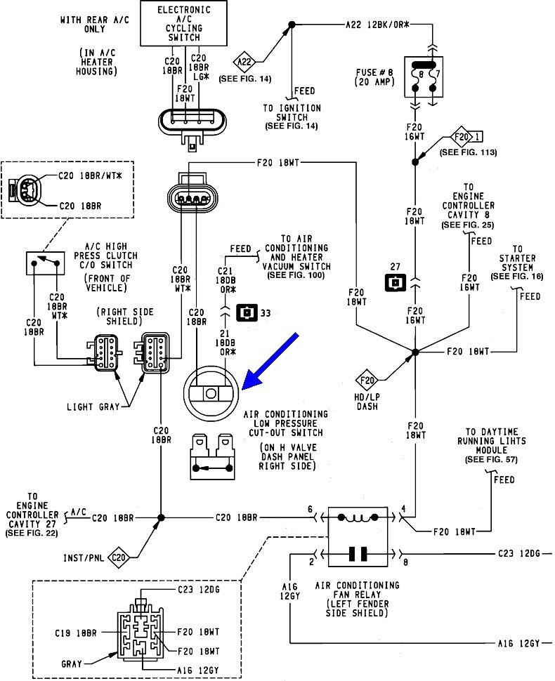

If you look at the very bottom, center of the second diagram up above, you'll see "to charging system". The charging system has nothing to do with the operation of the AC system. That is just where the wire in question originates. Just to the left, that wire is listed as "A16 12GY". "A" wires always originate at the battery's positive post or right after a fuse that's connected to that post. There will not be any type of switch in between, so we know there should be full battery voltage on that wire all the time. No need to turn on the ignition switch. Just to the right of the relay, and my red arrow, they show the relay's terminals in a dashed box. Those CAN be hard to follow because some engineer drew them exactly as they look in the actual socket. It would be easier if they just drew four straight lines, but no one ever asked for my opinion. To make this process faster, just touch your meter or test light probe to all four terminals, one at a time. You should find 12 volts on one of them. If you do not, we have to work back and find the fuse link wire. That will be in a bundle of similar dull-colored wires, (usually white, gray, orange, or green, in a harness running around the left front strut tower. Those are tested by tugging gently on them. If one is good, it will act like a wire. If one is burned open, it will act like a rubber band. I'll go deeper into details about them later too, if necessary.
For now, just let me know if you find 12 volts on that one wire. I have to run home to do some more typing.

Okay, since you know which is the correct relay, lets jump that and see if the clutch engages. You'll hear it click if it does. Use a piece of wire, a stretched-out paper clip, or a cotter pin. Find the terminals that correspond to the dark blue / black wire and the gray wire. Lightly touch the wire to those two terminals. The ignition switch doesn't have to be on.
If the clutch engages, that part of the circuit has to be okay, then we have to look at the control side of the relay to see why it isn't being energized. This is where the most common cause is low refrigerant. You jumped the two terminals in the low-pressure cutout switch and that didn't make the clutch engage, so we are likely looking for something else.
As long as the system is near fully-charged, most failures for this problem will be caused by the circuit you're about to jump because that's the high-current side. Parts have to be beefier, but they're more likely to fail.
One more comment of value. I know you found voltage at the relays, but if you have a fuse box just above the brake power booster, check the fuses in there. I have a '95 model that was missing the fuse box cover, then some of the fuses corroded to powder. There were multiple symptoms from just one of them. One was the "Air Bag" light turned on. That was the warning to tell that other systems were dead that you wouldn't notice until you needed them. This would something simple to not overlook. While my fuses were corroded off, the terminals in the box were fine.

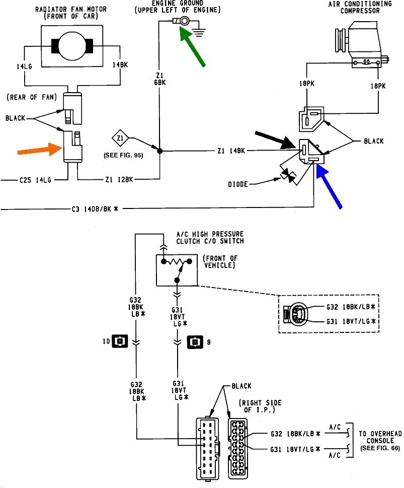

I'm suspicious you're on the wrong relay. Look again at the colors of the wires you're jumping. That socket should have a gray wire and a black wire that you're jumping, both 12 gauge, rather fat. Also a 12 gauge dark green and a smaller 20 gauge dark blue with orange. If that is what you have, the next test is going to be down by the two-wire plug on the compressor.
If you find the wire colors are light green and gray, both 12 gauge, and dark blue and dark blue / pink, both 20 gauge, that is the radiator fan relay and would explain why the fan is running.
Assuming you're on the right relay, check for 12 volts on the dark blue / black wire at the compressor's plug. That's the blue arrow in the first diagram. If it is missing there when you jump the relay, we'll have to work back to the ten-pin plug, (double purple arrow in the second drawing.
Point of interest, when you see both halves of a connector, fold one over on the other to see where a wire comes in and goes out. Here, with one part over the other one, if you flip the top half over on top of the lower half, the two dark blue / black wires line up. Those are the two mating terminals in the connector for that circuit. Here the color stays the same even though the gauge changes. Those connectors are a real good place to find the cause of a problem. One or both terminals could be corroded, the female terminal could be spread open by being picked too hard with a test probe, or there can be corrosion between two or more adjacent terminals. Corrosion between terminals usually can't conduct enough current to cause a power circuit to operate, such as a fan motor, but they can easily cause tiny sensor signal circuits to interact and cause elusive problems.
Same when you see the two connector halves side by side. Fold one half over horizontally over the other half to follow a wire.
If you do get 12 volts on the dark blue / black wire, check next on the black wire, (black arrow). That must be done with the plug connected, otherwise the reading is meaningless. I like to unplug it, stick a paper clip in on the backside of the plug alongside the wire, plug it back in, then I have a wire sticking out suitable for connecting a clip lead to, then to my voltmeter probe. You should not find any voltage on that wire when you jump the relay. It's not uncommon for a digital voltmeter to pick up a few hundredths of a volt. Consider that to be 0 volts. If you find 12 volts on the dark blue / black wire and 0 volts on the black wire, the clutch should be engaging. Either the clutch coil is defective or one of the terminals in that plug is not making contact with its mate.
If you find some voltage on the black wire, the ground wire has a break in it, (green arrow). That ground is shared with the radiator fan motor. I don't see a path for current to flow if that ground is broken. This is what we refer to as "back-feeding". When you jump the relay, current flows through the compressor clutch coil, then can't find a path to ground, so it looks for an alternate path to continue on back to the battery. In this case that alternate path is through the radiator fan motor, but as I said, I don't see where it can continue after that. If I'm overlooking something, the clue would be the fan runs, as you've observed, but it will run slower than normal, . . . and backward. When it runs, air should be blowing onto the engine. If it's running the wrong way, it will be pushing air out the grille.
Let me know what you find at the clutch coil terminals. I could spend all night typing a description of all the possibilities and still be wrong. Instead, I'll figure out where to go next once I know what you find.

For the right relay, could that 20-gauge wire be blue / orange? The stripe colors often cause confusion. That's the compressor clutch relay. Double-check there's 12 volts on the gray wire. If there is not, we have to work back toward the fuse. If there is, jump that to the dark blue / black terminal. Those wires are for the two switching contacts in the relay. The clutch should click into engagement. Nothing else should turn on. If the clutch engages properly, we're done in the high-current half of the circuit, and we'll have to look next at the low-current side of that relay and the controls that run it.
The wire colors you listed for the left relay are on the lower right of this diagram. They're for the AC condenser fan motor, next to the radiator fan motor. If you were jumping this one previously, it would explain why a fan turned on.

Sounds like it's the right relay we want. The red arrow is pointing to the two switching contacts. The terminal corresponding to the gray wire should have 12 volts on it. Jump that one to the terminal corresponding to the dark blue / black wire and the clutch should click.

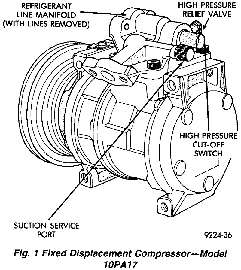

I am using the fitting that's on top of the compressor. The system has been retrofitted with 134 fittings. My Freon installation kit consists of one end that screws on to the can, a gauge, and an end that snaps on to the fitting on the compressor.
The gauge has two ways to read - PSI and "Add, Full and Overcharged".
40 PSI/Full is what I was reading and when I jumped the clutch to operate, the needle went from 40 to below zero. I just figured that if the gauge is showing below 0 PSI it needs more Freon since I don't see a reading and since I am now able to jump the clutch to work. I don't own a vacuum pump so I can't evacuate the system. I've used the sight glass method before so I will see if there are bubbles or not.
Dec 6, 2022 at 5:39 PM
CARADIODOC
  • 34,306 POSTS

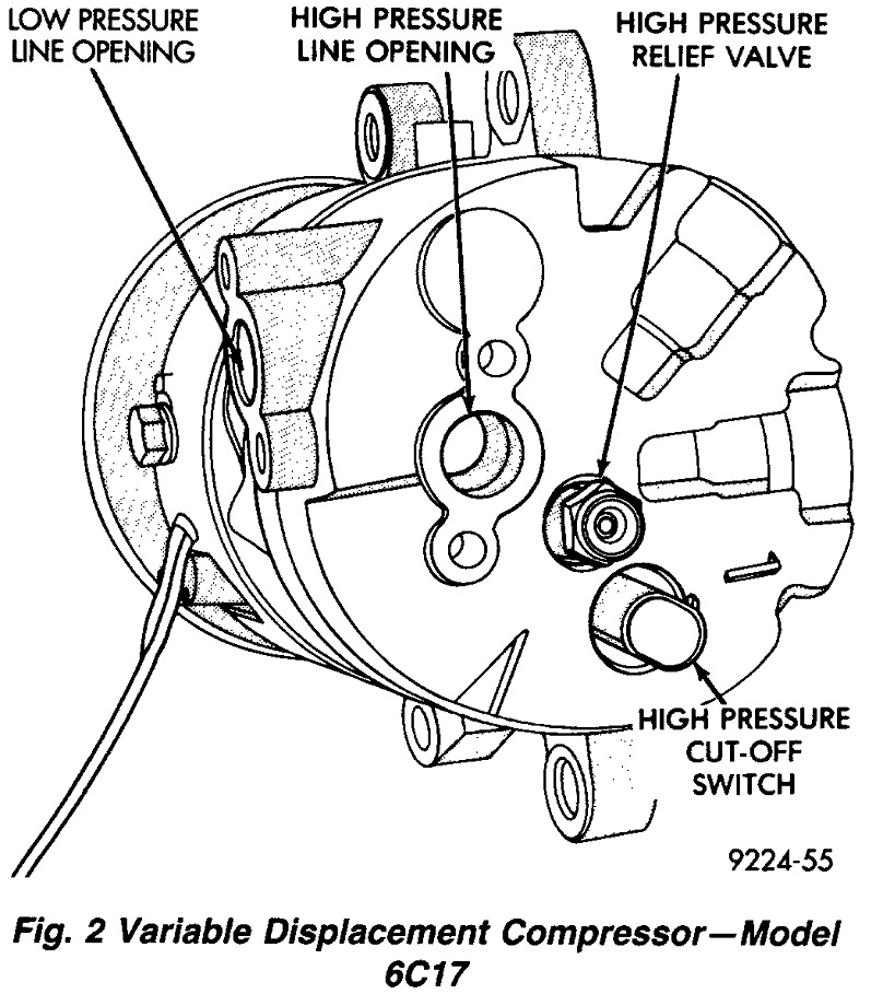

Dandy. I don't know what to make of the gauge. I have one of those setups too, but that gauge has no way of knowing how much refrigerant is in the system already. It can only look at the pressure, and from that it has to assume the system is working properly.
Two different compressors were available in '92 and they're going to have different control systems. The fixed compressor means it always pumps at a steady rate, so it gets cycled on and off as necessary to maintain the liquid level in the evaporator. The variable compressor runs continuously when the system is switched on. Flow is controlled by a variable wobble plate in the compressor. It changes pitch according to the pressure coming in on the low side. As pitch changes, the stroke of the pistons change to adjust the volume of flow. They did that to eliminate the slight thump of the compressor turning on.
Use the sight glass as you did before. I wouldn't pay any attention to the gauge. I added these drawings that show the low-side port is indeed on the compressor for the fixed design. They call it "suction" here. The high-side port is usually on the metal pipe going to the condenser, but it can also be on the pipe between the condenser and the receiver / drier. Your charging hose won't fit on the high-side port so you can't get the wrong one.

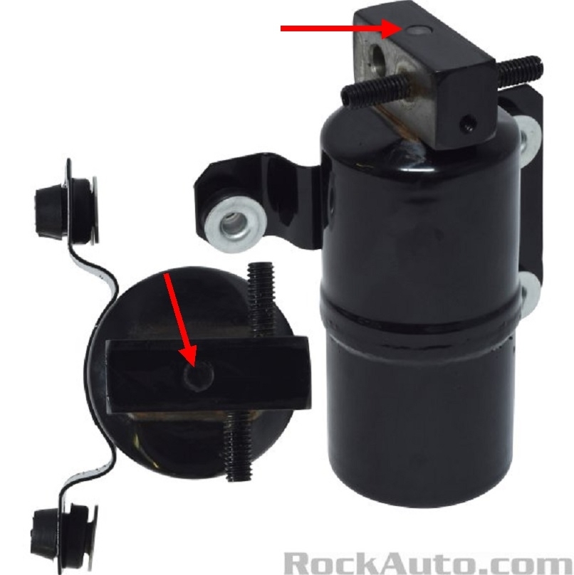

My concern now is if you don't know the history of the van. Someone smart enough to install an R-134 adapter should have been smart enough to change the oil in the compressor.
Don't concern yourself with that oil now. You'll never see the little that circulates in the system. There is a list of how much to add for each part that is replaced, such as a metal pipe, a hose, or other component, but those are in the order of tenths of an ounce. Also, that oil doesn't get drawn out when the system is pumped into a vacuum. Unless you repaired a leak, there's no need to add oil. When you do add to a closed system, it is done at the compressor before the system is pumped. Some charging stations can add oil separately. Right after evacuating the system, the oil goes in first, then the refrigerant.
Since you already added two cans of refrigerant, there shouldn't be a lot of bubbles in the sight glass. That should be way more than enough to turn on the low-pressure cut-out switch. This might be a good time to check for leaks. Professionals use an electronic leak sniffer. The probe is held under fittings and connections because refrigerant is heavier than air and will go down from the point of the leak. A common, but elusive place to find a leak is in a lower corner of the condenser. A dark oil stain is evidence of that leak caused by corrosion. A leaking evaporator is harder to detect. The electronic probe may pick it up at a duct outlet when running the heater fan on the lowest speed. A better place to look is at the rubber hose hanging down on the passenger's side of the firewall, under the hood.
Another leak-check method is to add refrigerant with the leak detection dye. You can find that in the same small cans. When the system is empty, that dye can also be added from a very small bottle to any open connection, or through a charging port once the valve is removed.
By the way, be sure to install the black or gray plastic caps on the charging ports when you're done. Don't be surprised if either leak detection method shows a port is leaking. Those valves are only meant to hold the refrigerant in while you put the caps on. The actual sealing is done with rubber seals in the caps.
When using the dye method, first look for an eerie green stain. Common places to find it include where a rubber hose is crimped to a metal pipe, and where a metal pipe is bolted to a component. Look under the "H-valve" where the pipes go into the firewall. Also, the aluminum block where the pipes are bolted to the condenser. For small or hard-to-see leaks, use a black light to make the dye show up better. It will be bright yellow.

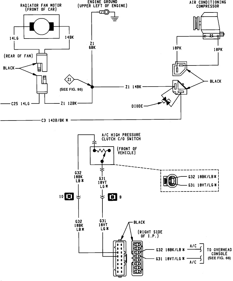

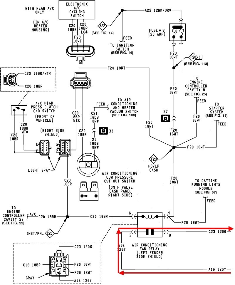

Next, we need to look at the other half of the relay. In these two diagrams, I added the red line to show the path current takes through the control side of the compressor relay. It starts at the "12V" box on the bottom of the second diagram. If you follow it to the bottom of the first diagram, you'll see it has to go through the AC fan relay. We'll have to look at that one too to be sure it is turning on. For now you may need to jump the terminals for the contacts, the gray to the dark green, 12 gauge wires, or substitute a different relay.
Side note: It's not uncommon for relays built on a phenolic board, with a metal cover crimped over them, to get moisture inside and the contacts corrode away). You might have to find a few in a salvage yard to find a nice clean one.
The circuit continues back to the second diagram, then note that it splits by splice "C23". One path feeds our compressor relay. The other line feeds the AC fan motor.
Another side note: My '88 and '89 vans have two fans in front, one for the radiator and the other for the AC condenser. My '94 and '95 models have just one fan with the condenser right in front of the radiator. Both are a lot wider than those on the older models.
According to these diagrams, your '92 model has two separate fans like in my older models. A real fast clue is if the condenser fan runs when you turn the AC on. If it does, everything is okay up to this point. If it does not, the compressor isn't going to get turned on either. It's wired that way so the compressor can't run if the fan can't cool the condenser. The compressor relay is still controlled separately, but it won't turn on if the fan relay doesn't turn on first.
Going back to that AC fan relay in the first diagram, the coil is fed 12 volts from the ignition switch. There was a common problem with the switch, and without researching it further at this time, it affected the accessory circuit including power windows, radio, and especially the heater fan. If the heater fan runs, we can skip this story for now. I think you would have noticed those other problems by now.
The other side of the relay's coil is controlled by the Engine Computer. This is where the pressure switches enter the control system and is where we'll have to go later if necessary.
Go back to the clutch relay and check for 12 volts on the 12 gauge dark green wire, or check if the AC fan is running, (passenger side fan). If it is not and there's no 12 volts, we'll have to go back to the fan relay. I'm not going to try to tell you where the AC fan relay is since there seems to be a lot of differences between your van and my drawings, so you'll have to go by the wire colors. Find the 12 gauge gray wire in the socket and check if there's 12 volts there.
While you're at it, check the voltages on all four wires, but now that has to be done with the relay plugged into its socket. Let me know how far this gets you.
