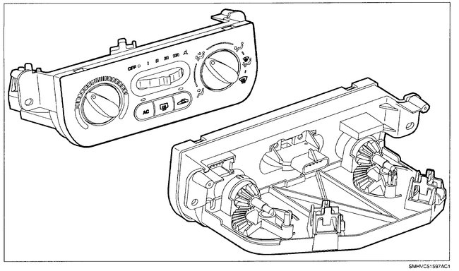

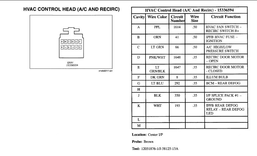

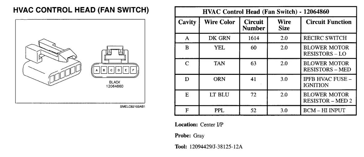

When i turn on A/C it just blows out hot air i watch rpm's and they don't budge. I thought it does if at least the HVAC controls inside is working. I cant add Freon without compressor on and i don't know what to try.
