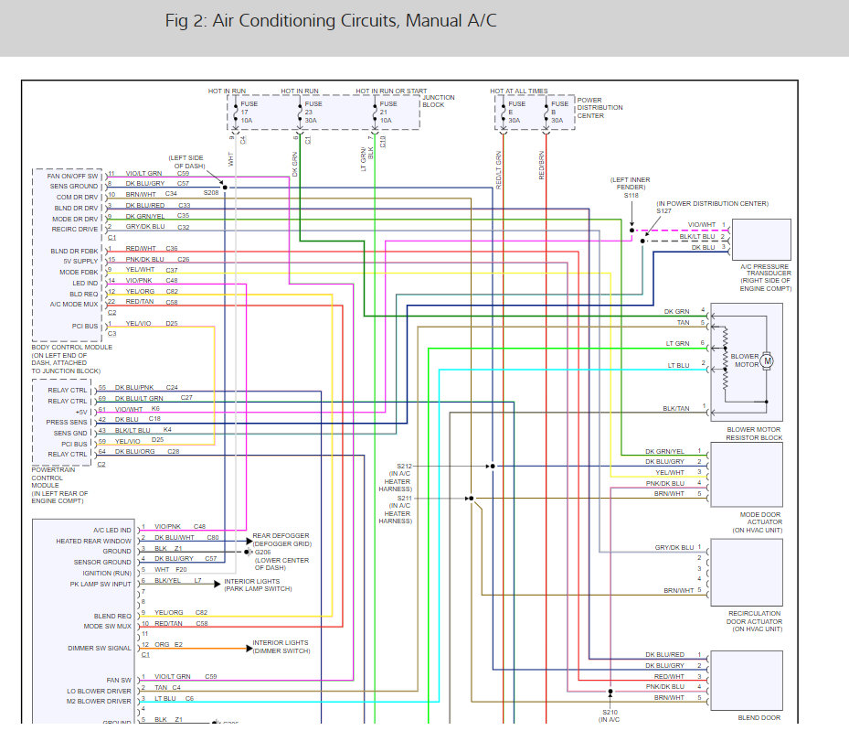

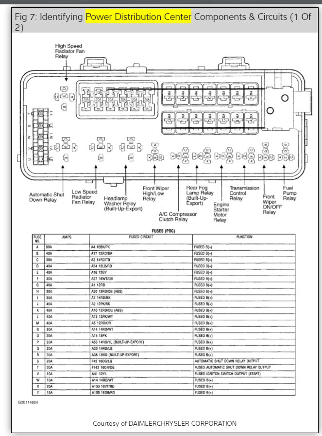

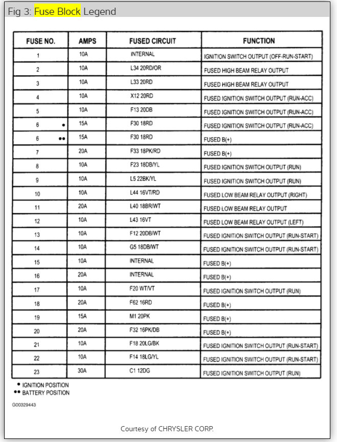

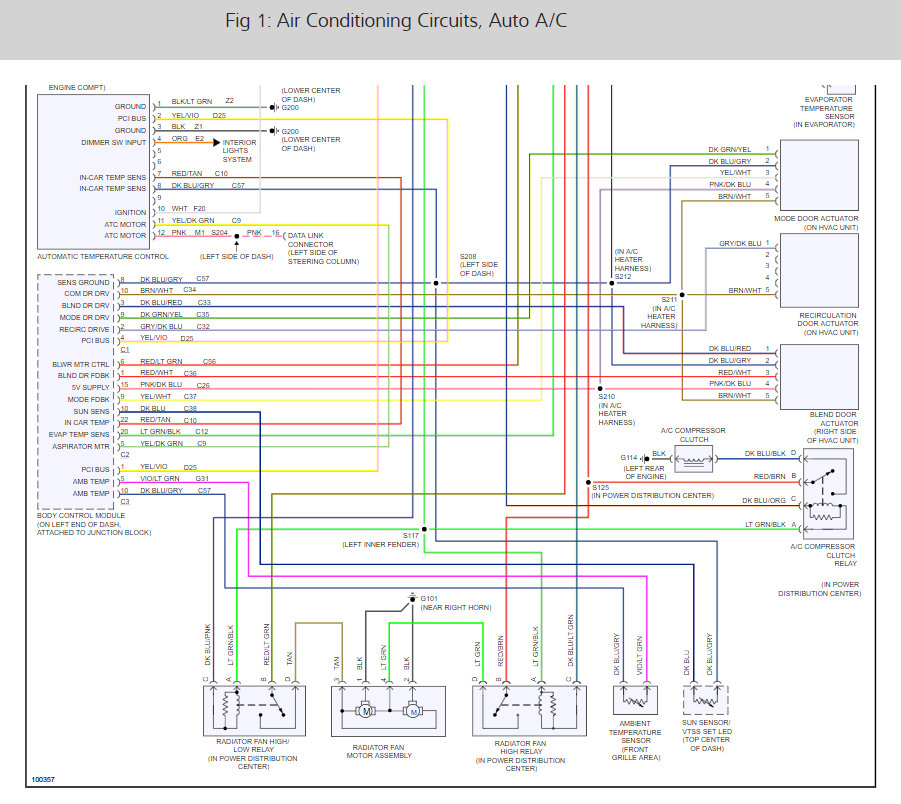

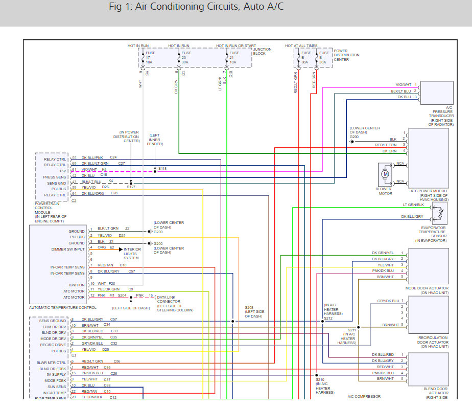

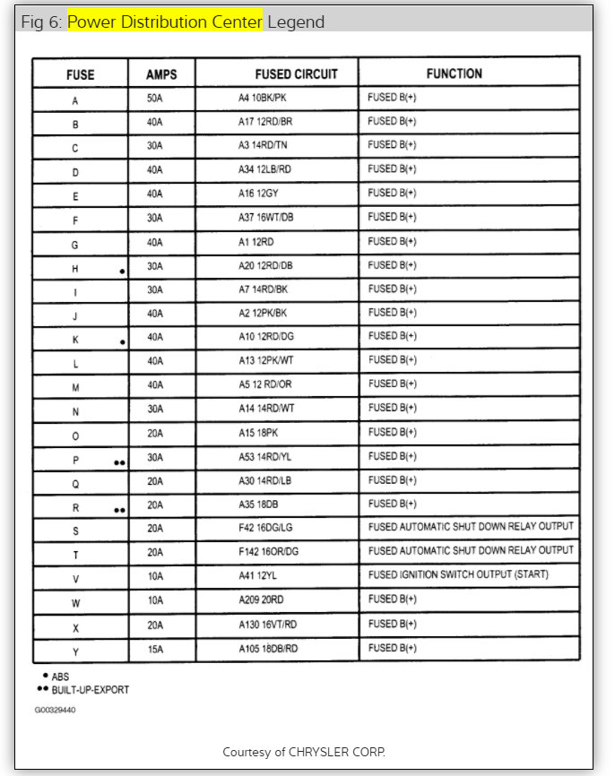

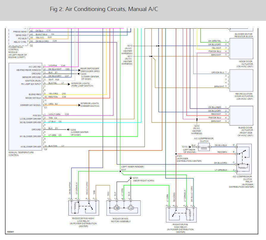

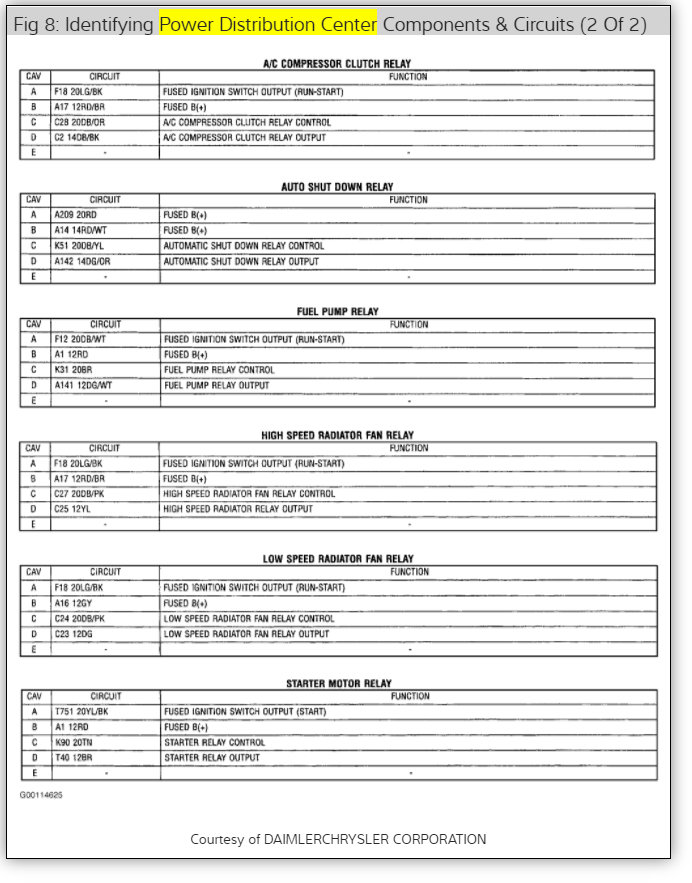

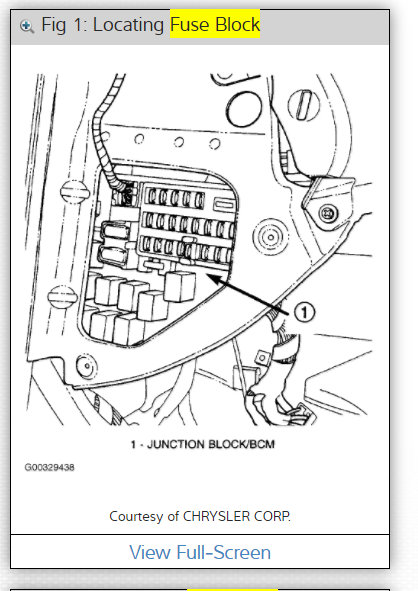

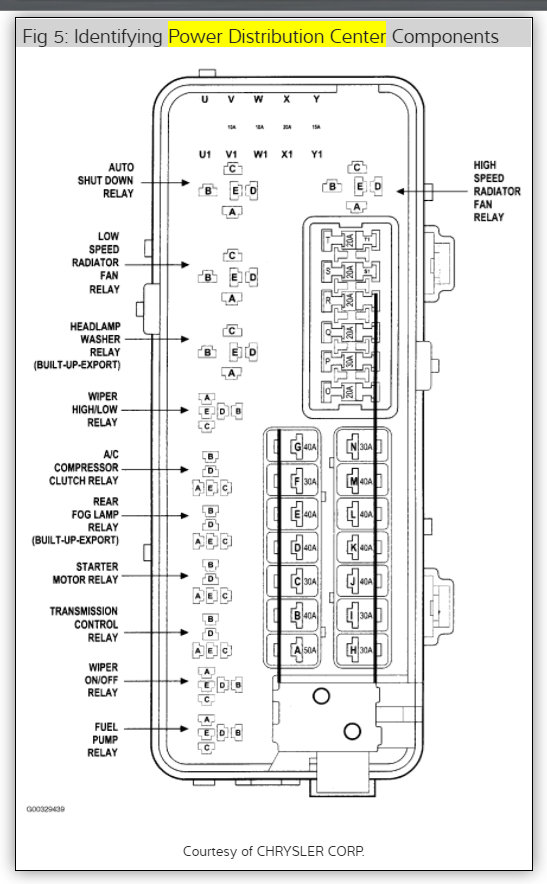

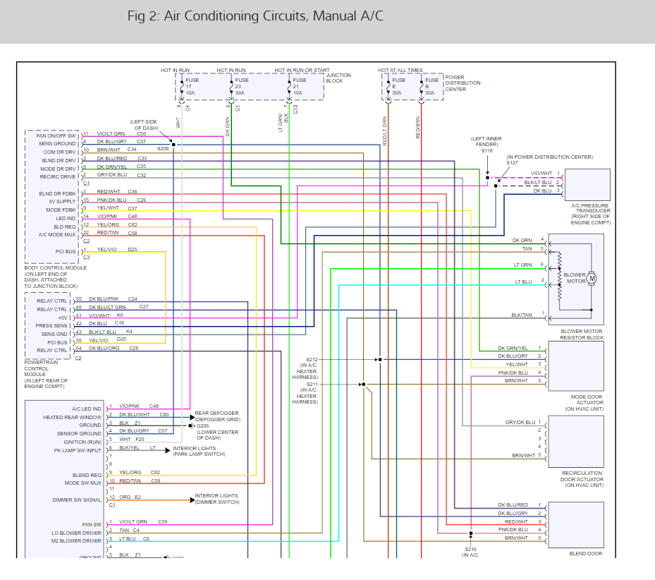

If I can jump in here. the low side gauge could be in the red because the system is not working (compressor operation). Here is an air conditioner wiring diagrams so you can see how the system works and to check for power at fuses #17, 23 and 21:
This guide can help as well:
