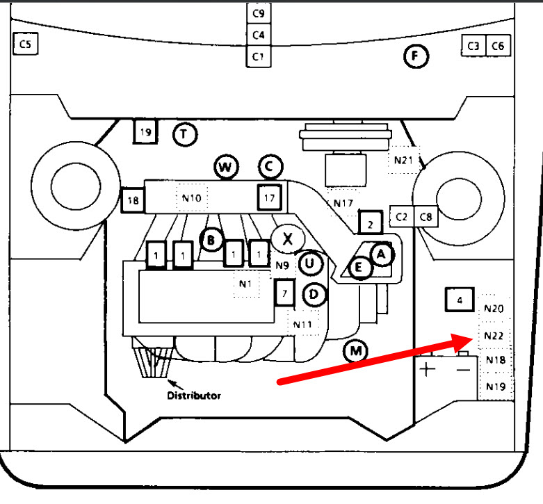

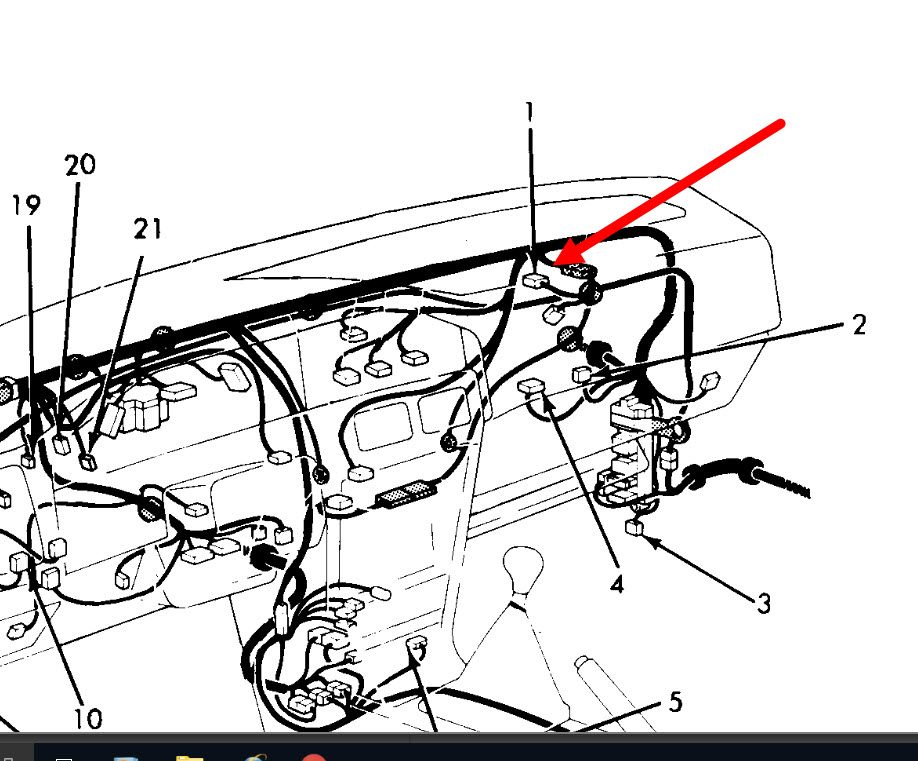

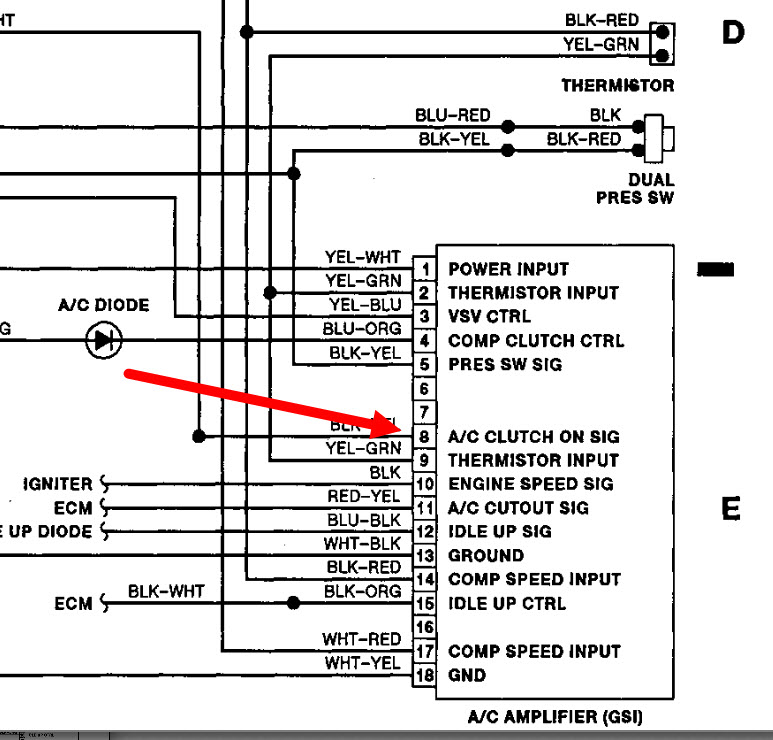

A/C was blowing ice cold clutch cycled off never started back up has a full charge of r-12. A/C is working replaced A/C management relay under hood check high pressure switch works not getting any power to the clutch. also the shift interlock went at the same time checked the fuse on right side kick panel was okay, but there are two relays do not know what operate do not know where to check now.
